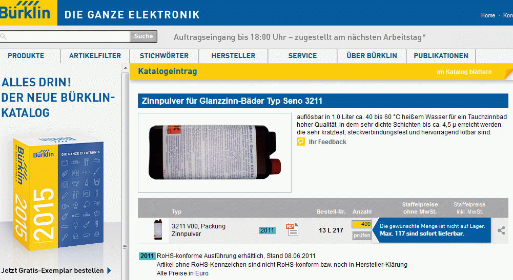

This stuff is good for chemo tin for the boards. I also have a silver solution,
but it contains a lot of cyanide.

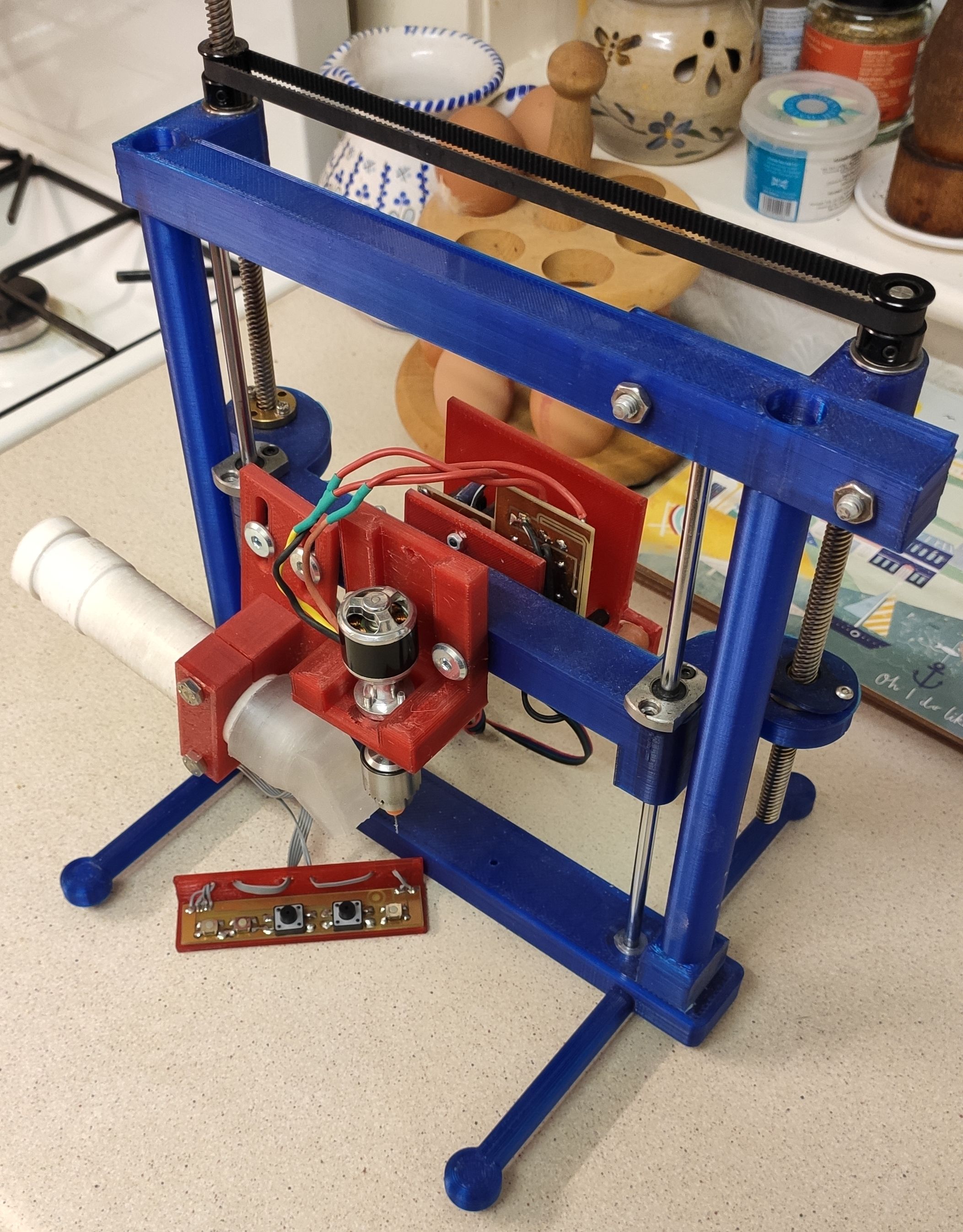

With regards to drilling I got fed up using a standard press so I built my own semi-automated PCB drill press.
A high kv RC hobby BLDC to easily get the drill spinning up to 20k RPM. Allegro A4964 sensorless BLDC controller. Stepper motor + Trinamic TMC2208, linear bearings and a 3D printer Z axis style configuration for raising/lowering the drill.
One button turns the motor on/off, two raise and lower the drill, one button is emergency stop and the last one moves through a drilling sequence, which is basically down then up again enough to drill a hole. Much faster than a manual press and there's an attachment for a vacuum.
If it wasn't obvious it's 3D printed.

Nice, but it automates the wrong part of the process. It doesn't matter if I push
the spring-loaded handle or a button.
The time is lost when I try to center the drill bit above the pad. It is really hard
to see for 0.35mm holes with the tiny rest ring. 0.35mm for vias with wrapping wire.
In a previous life, at the institute where I made my diploma thesis, we had a
Swiss-made drilling machine where the drill bit came upwards from the bottom side.
There was an optic on the top side where you could see the magnified pad
top-down without parallax but with an aiming cross. Great construction.
Well, a machine that reads Excellon files and just does it would be even better. 😀

Hey!! KILLER machine!!!
And I see you stretched 3D printing limits way beyond what´s normal.
I am used to seeing smallish items, whould never had thought about large thick structural I-Beams.
One doubt: I recognize Z axis movement (raising/lowering drill) but no X/Y movement6s.
Do you move PCB by hand where it´s needed?
Maybe you´d like to add a small spot or two to have a circle of bright light around the actual drilling spot.
It certainly helps my eyesight 🙂

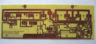

Delay because of Redrawing the board again

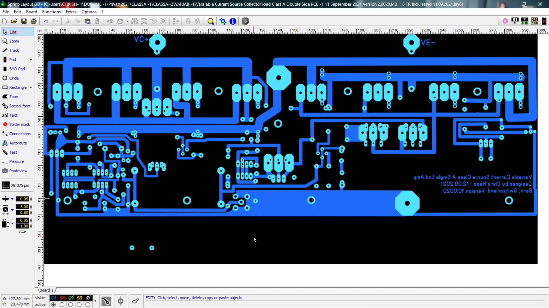

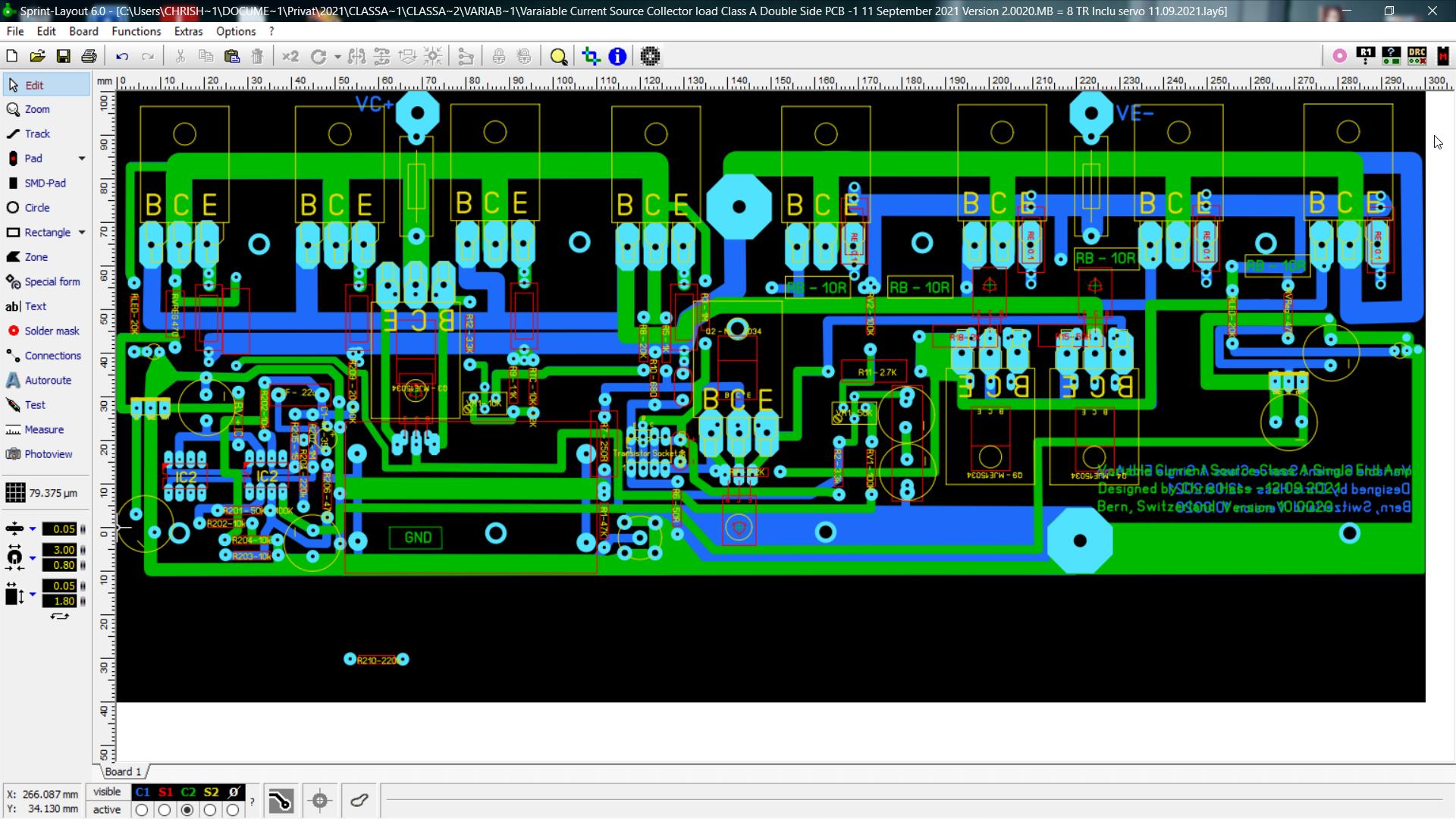

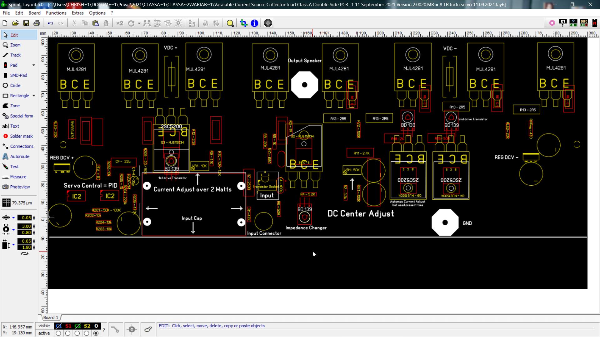

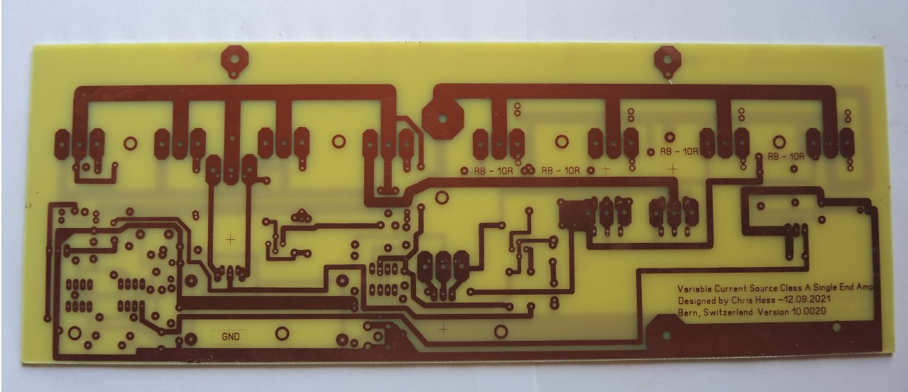

Hi Guys,
Here, actually should start the Part of Assembling the board..
Unfortunately after drilling the Board which should be assembled, I saw some minor layout flaws, which made me, instead of assemble it, redraw the Layout one more time, thus delaying the assembling and the board already drilled, is used as reference PCB only.
So, the new layout of the board is almost finished and right now it's in rechecking phase, so that all the tracks are connected, no short circuits occur or other faults can be found and it should be RTM *ready to manufacture* later today. Hopefully I can manufacture the PCB tomorrow, another Sunday Job..
This Layout I have drawn so 3 different Drive Transistor can be used and this even with different pin layout.
So I got you a few pictures of this..
Drive Transistors BD139 are used. Input BC 559C is used, output 8x MJl4281

Yes, you are completely right..
And if there is a need to redraw it one more time then I will do that..
On double side cost me 10 Bucks.
So what? But I get the board when I need and more important when I want it..
and I want it NOW. (this is a Queen Phrase from late Freddy Mercury) in fact he sings, and I want it all... Same thing..
Not that the board I made is useless, No need to cut tracks, or piggy pack or likewise,, but I drew the last few days, covers my IDEAS BETTER..
Guys Will be back with the last version tomorrow, meaning the finished etched boards.

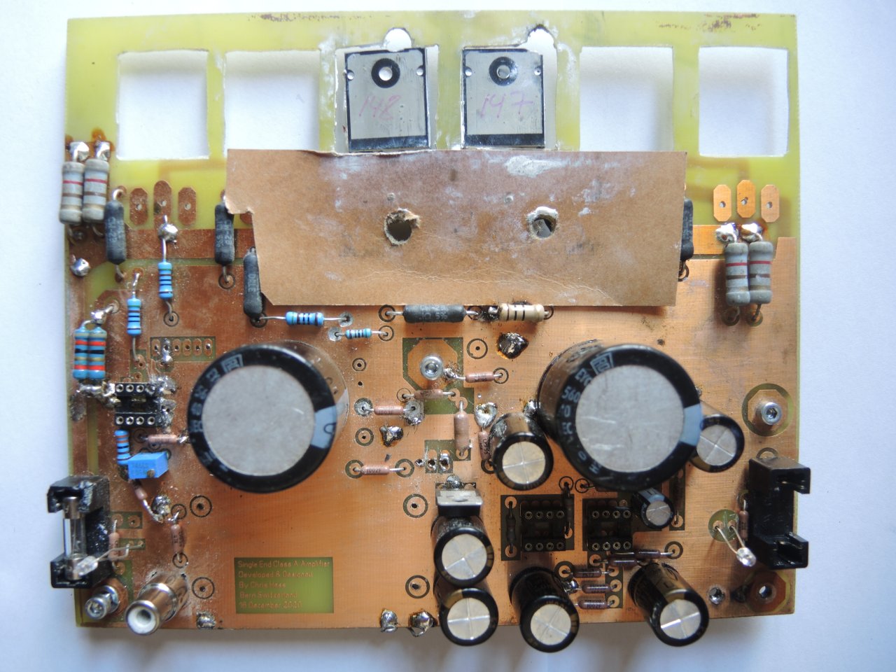

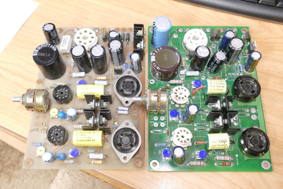

I also started in the 60's with the magic pen and some etchant from Radio Shack. That turned into tape, mylar, a darkroom, and some home brewed chemical mixes in the 70's. This lasted until the early 90's when I bought the DOS version of Eagle (V2.6).
If I'm making a prototype, a one or two off, or I just want it now, I use the toner transfer method and some Ferric Chloride from Amazon or Ebay.
For anything I sell I use a PC board house. I used a US based PCB house for 14 years with good results, but when they screwed up 3 out of my last 4 orders, I switched to JLC.
Some say that the DIY boards will degrade over time and begin to self destruct in a few years. The board on the left was a prototype of the Tubelab SE board that became my first product. It was made over 16 years ago and still works fine. The board on the right is from the US board house and is about 10 years old. Both will likely outlive me.
All are DIY no matter what anyone else says. I spent 41 years working for Motorola designing cell phones and two way radios. The PCB is considered to be just another component in the product no matter who made it.

Nice, expensive Caps on the right one.. similar to Sideral or Wonder Caps.. in that time back when I lived in Asia, these were to buy with Gold only... lol
If you look carefully at the old board on the left you will see that the coupling caps ARE Wonder Caps. I got a whole bag of used ones on Ebay cheap. They were pulled from some kind of early vintage switch mode power supply, obviously a long time ago. Most were Rel-Caps, some were Wonder Caps, both are the same thing, different market, and price. Internally there were three separate Mylar and foil rolls all wired in parallel to lessen the chances of a totally open cap.

New PCB ready
New board has been done "Perfect" and in the middle of the Work, when the I finished with exposure and also developing I saw another thing which could be improved. But this I leave for a later time.. LOL
Even it's not a major change to the Circuit, it will save money in manufacturing the Boards, and this just because making the board 0.5cm or 5mm or 0.1968" inch
This would allow me to make to boards out of 1 300*210 PCB I buy..
I will leftover of 300*100 now will look if I can squeeze that to fit that size..
BTW this is the new Board, as it came out of washing after etching..
Finally, the next section of this will be Controlling the board and then Assembling the board
Also a Picture of a Double Sided PCB made in December 2020 also Class A just for testing, some parts of the circuit.. and this on with Ground Plane on Top side..
I can drill much faster using the machine than my drill press but then again the press I've got is massive affair with a black and decker drill in it.
I do not use drills that fine normally I go with 1mm or 0.8mm. Maybe with finer drills and tiny pads it would take longer to line up. With the automated machine I can hold the PCB with two hands though Vs needing one hand to operate the press and when I have a lot to drill my arm used to get tired constantly operating the press.
Yeah I hold and move the PCB by hand. When I drill I do it at the area I solder at and I've already got large amounts of light there 😀
The 3D printing definitely took a moment to understand to get to the point where I can print such things with success.
