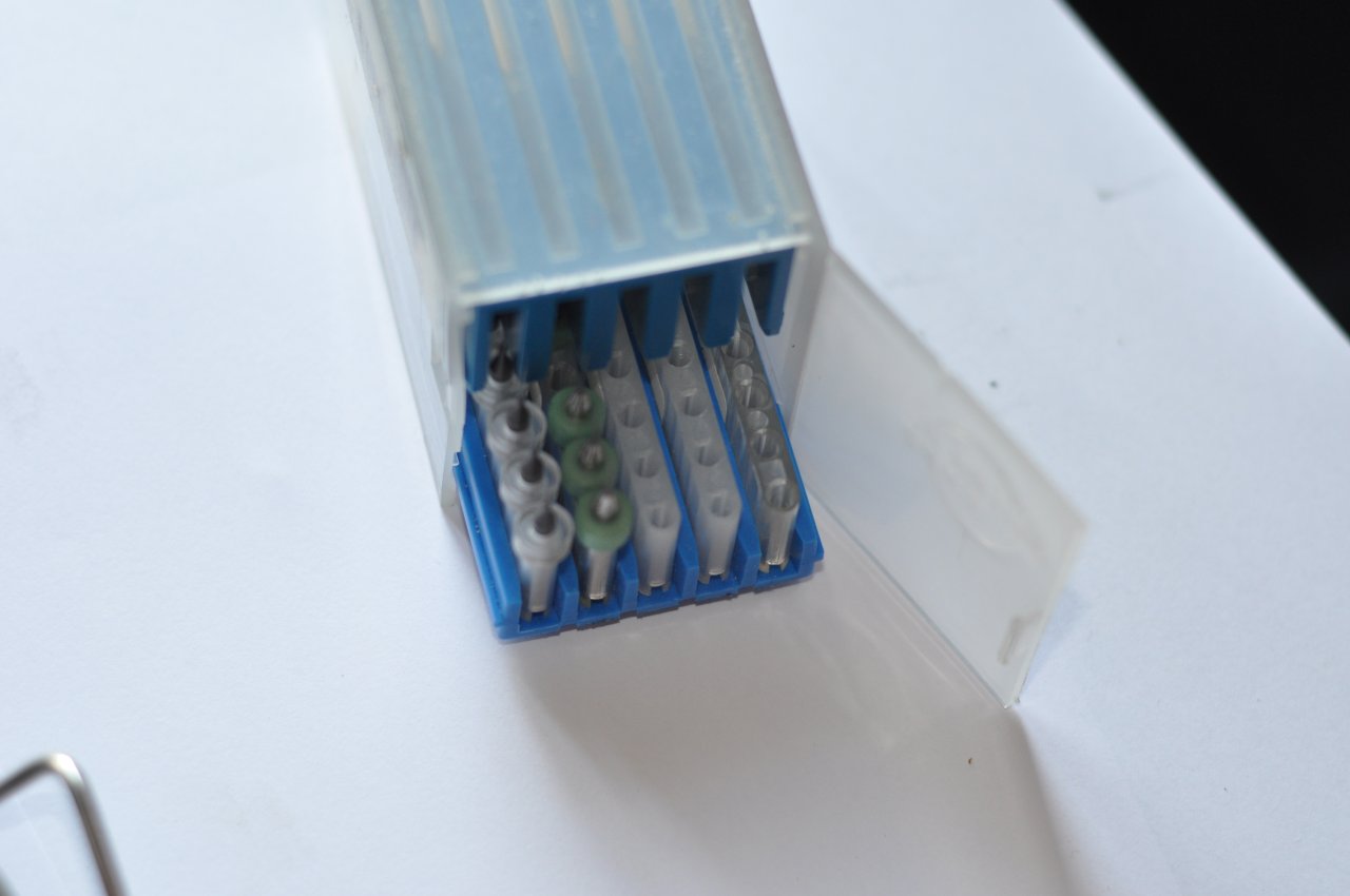

Tools you need
A Good BEAM Temp Meter where you can be sure that it measure the temp on 0.1 Degree, never mind if this is Water or Ice, Stone, Iron, Aluminum never mind the color the surface has.. ( there are cheap Temp Measuring tools out there, depending on color these will not read the correct temp.
A few plastic containers, to develop and Etch the PCB-.
Thin rubber or silicone Hand gloves.

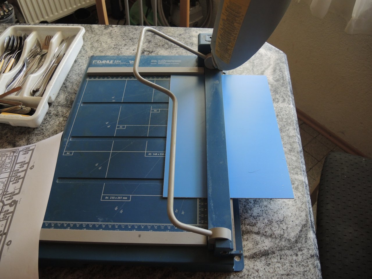

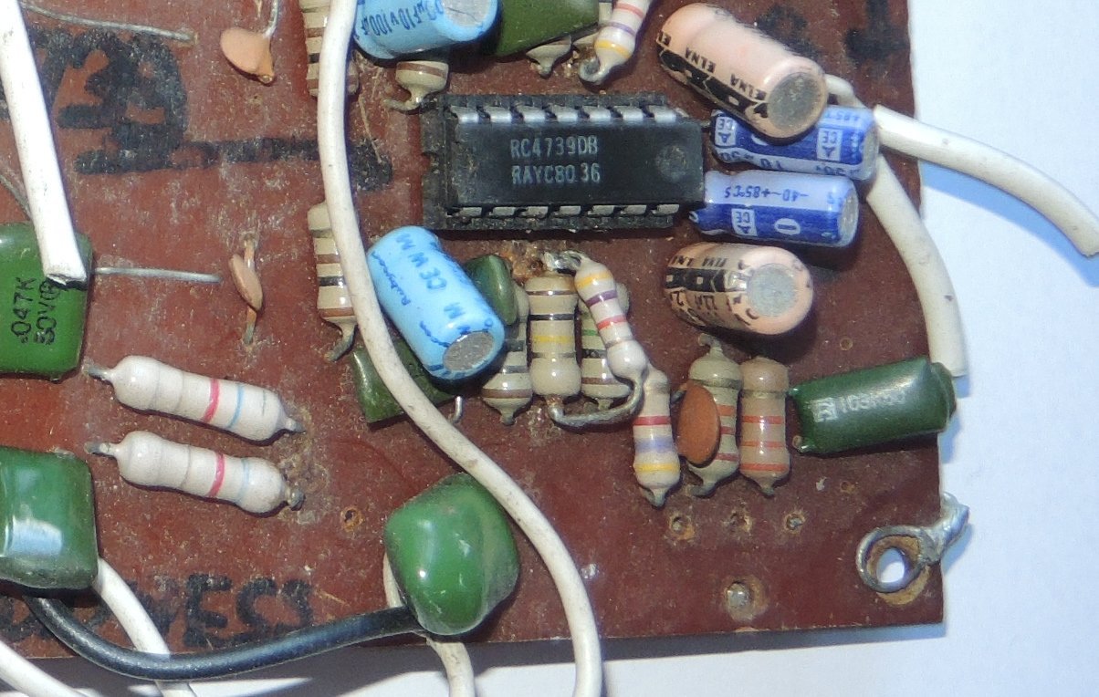

A good Paper Cutting Machine where it enables you to also cut PCB's. (check out Picture 1.6)

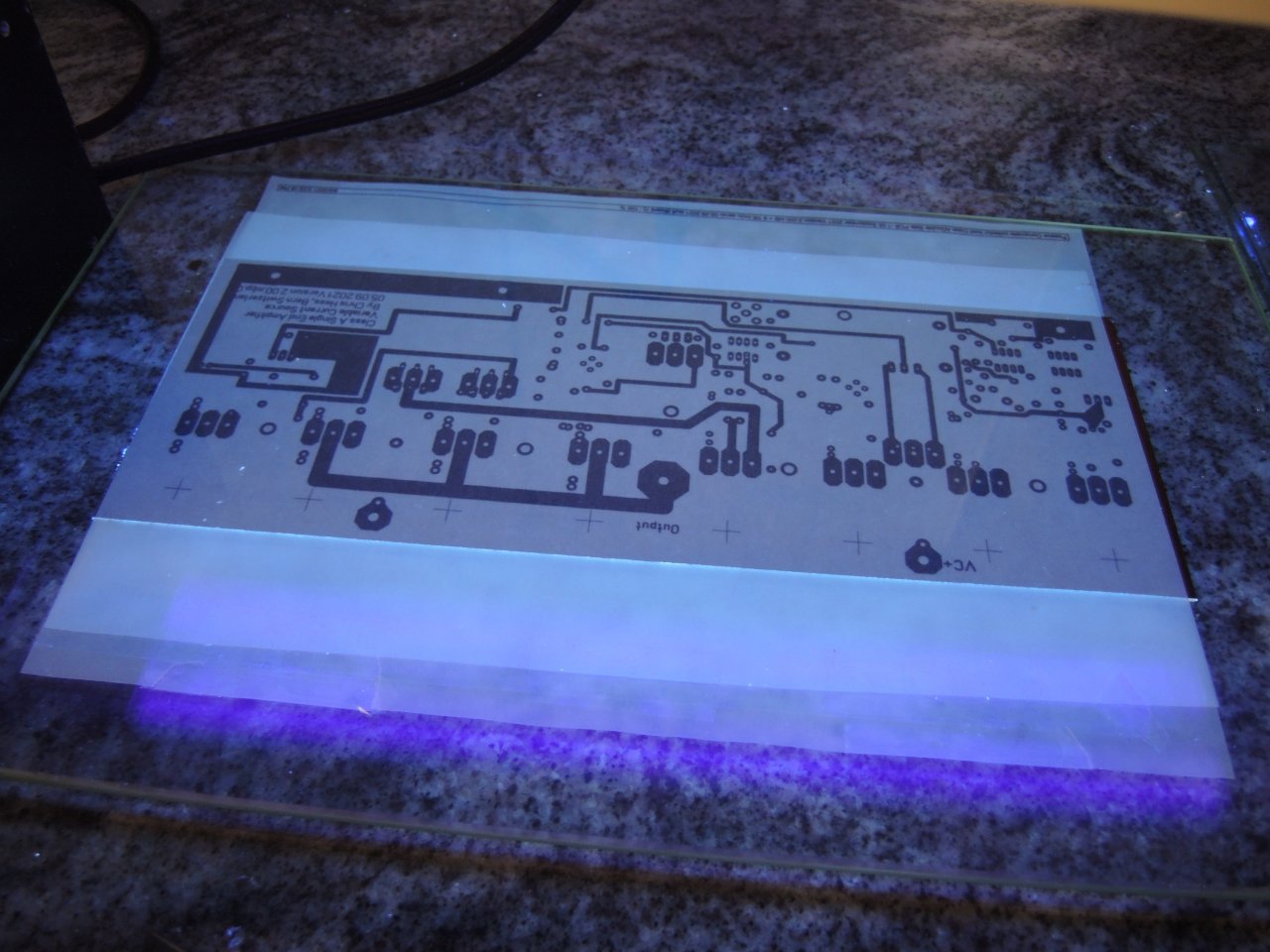

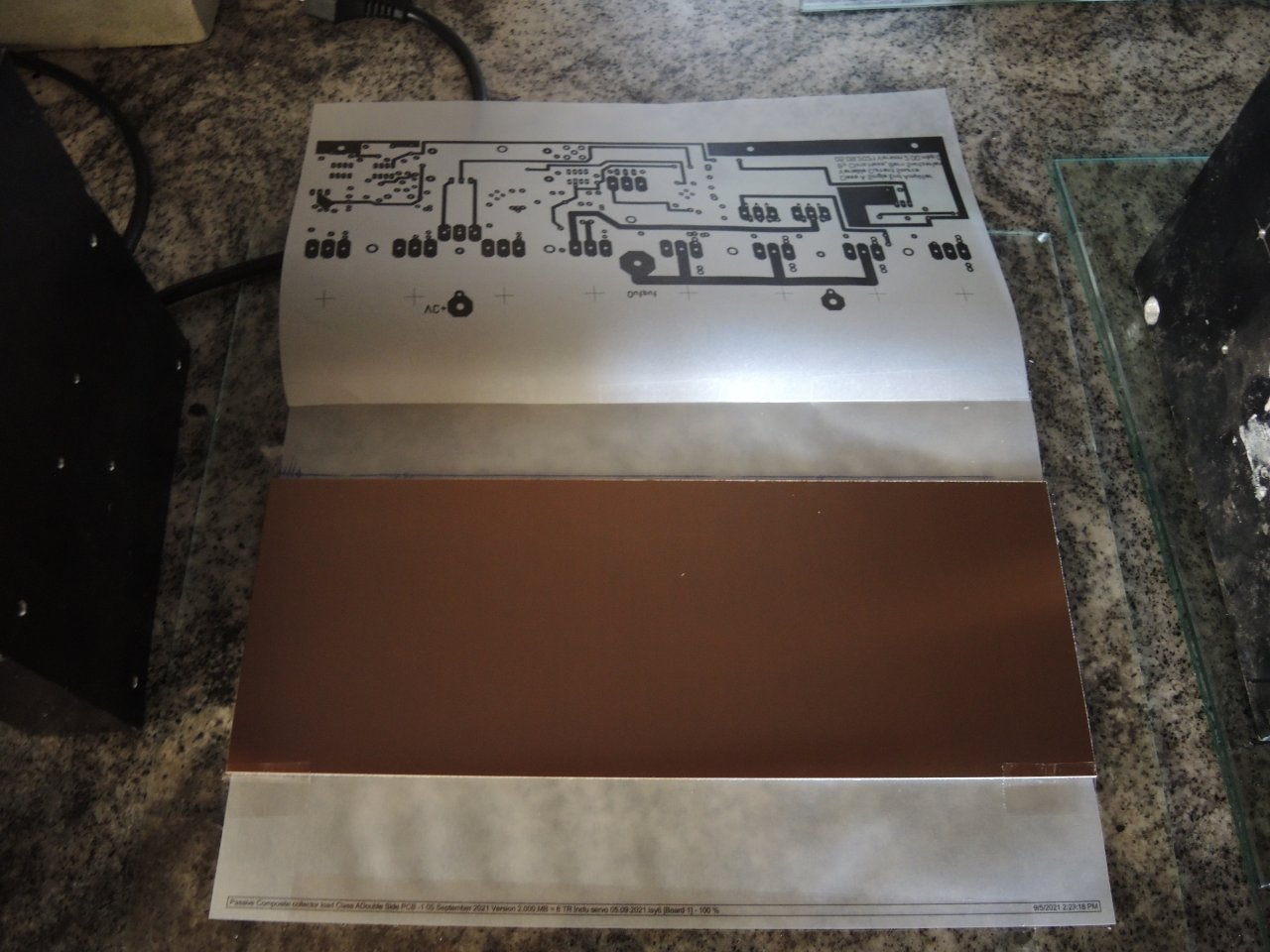

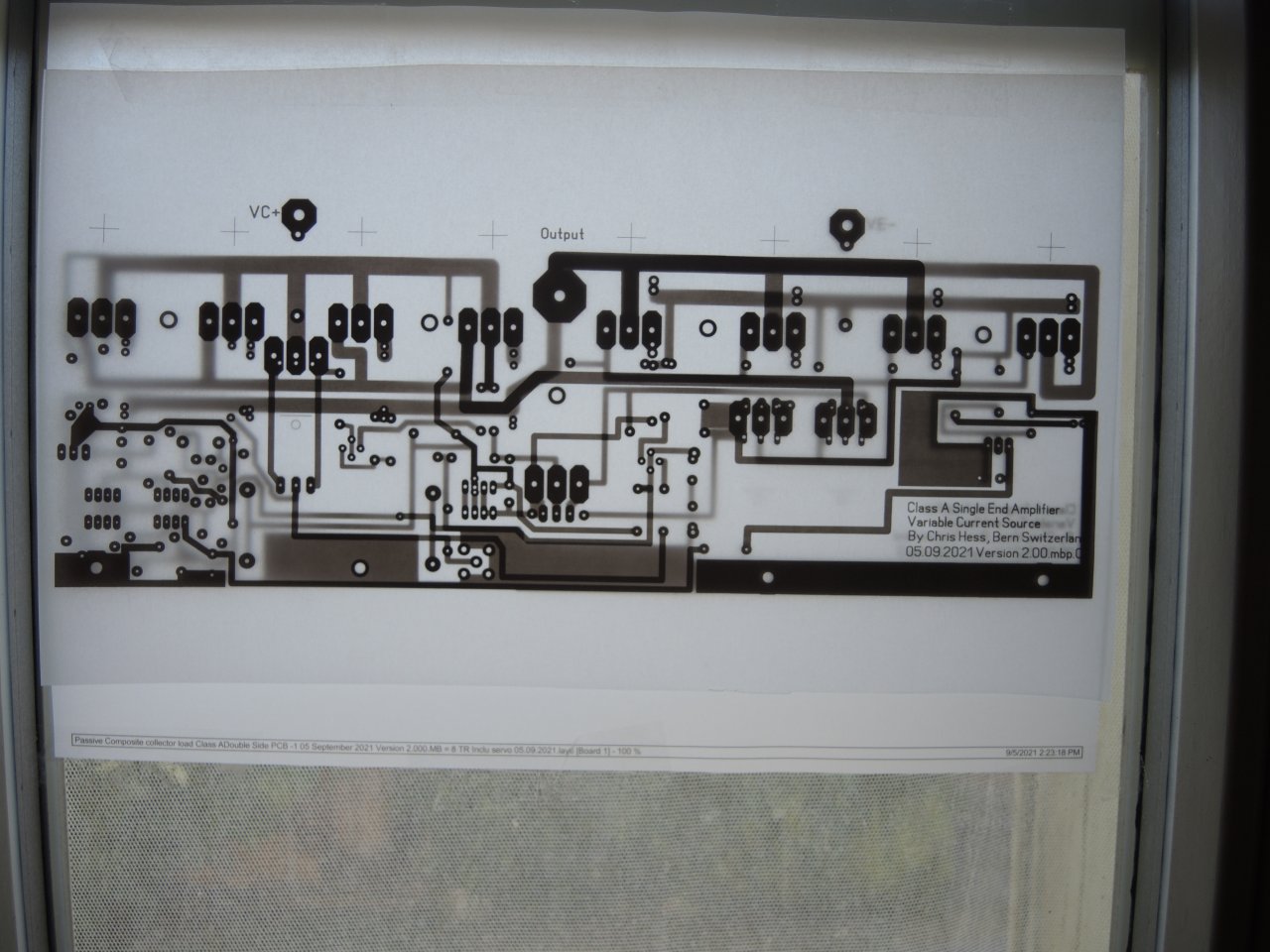

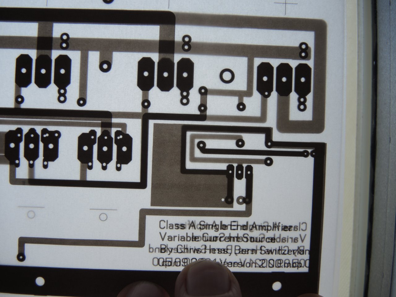

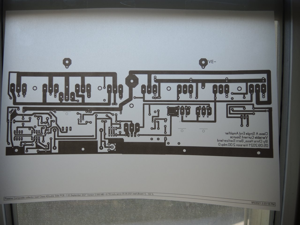

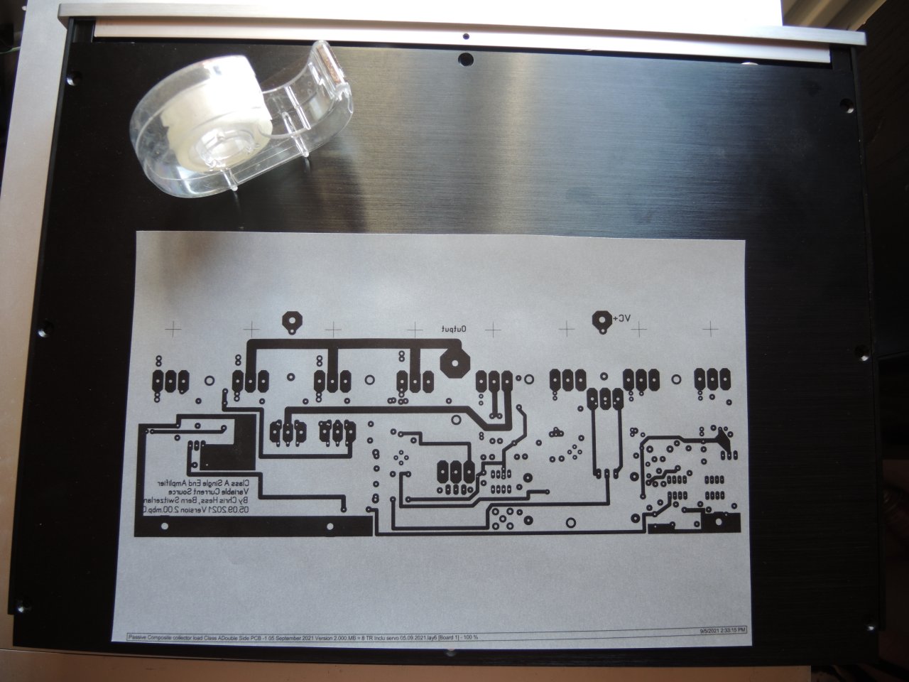

Make sure that the printed side of the Artwork faces the PCB Copper side..
This counts for both the top and the bottom side, that's why it might be necessary that one side of the "Artwork Paper Film" is mirrored.
Usually I mirror the top side.

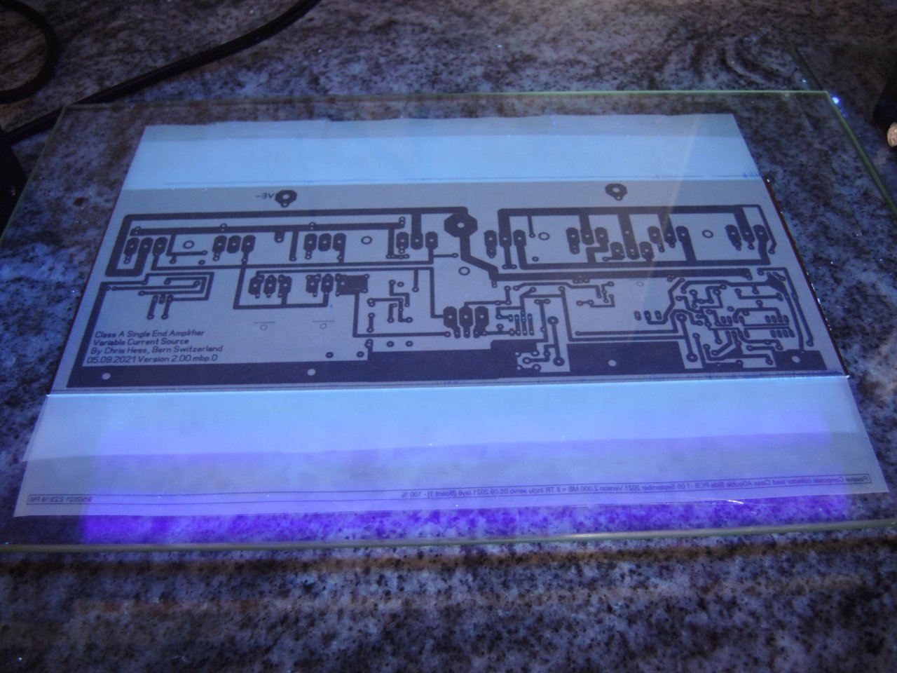

Heat up the ultra violet lamp prior to use for at least 10 minutes, make sure the lamp surface are free of dust or other none welcomed particles..

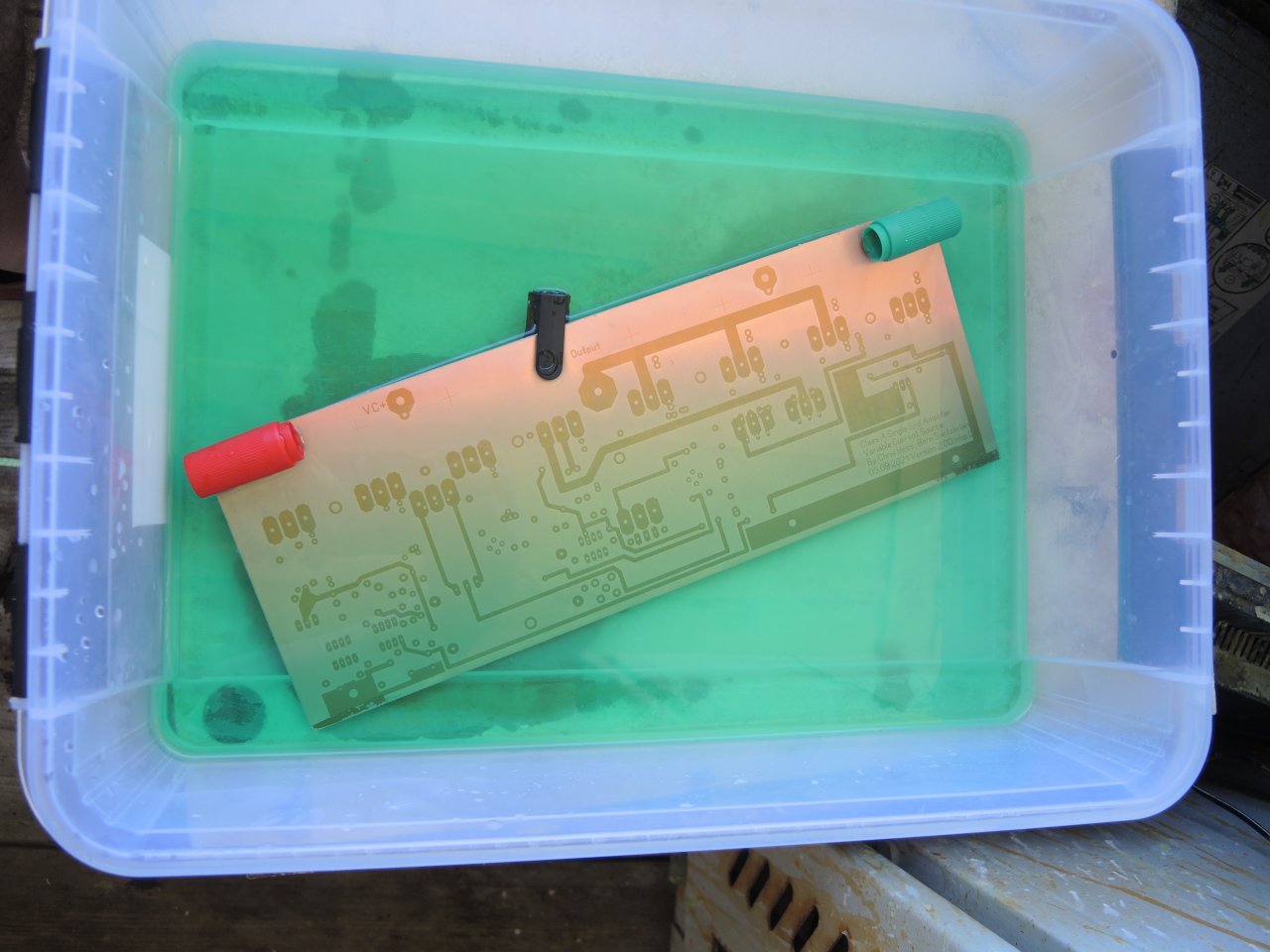

Make sure the the DEVELOPER Solution does not exceed TEMPS ABOVE 22Degrees Celsius. Neither the container where it is used in. Also check the temp of the PCB must be in the range between 20 & 22 Degrees, if it is higher then put it in the FREEZER until Temp is acceptable.
Using developer below 20 Degrees Celsius, then the film may will not be developed at all or badly, using temps above 23 and more, will give to a fast reaction to the film and the PCB will be unusable.
Check out the picture where I align, both sides of the PCB ARTWORK, using a simple Window method. Check out the Pics.
Double sided board must be made in one shot, unless you use to one sided PCB and glue them together..

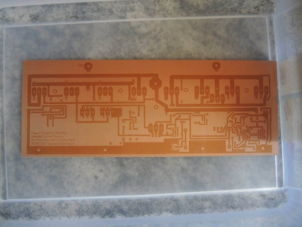

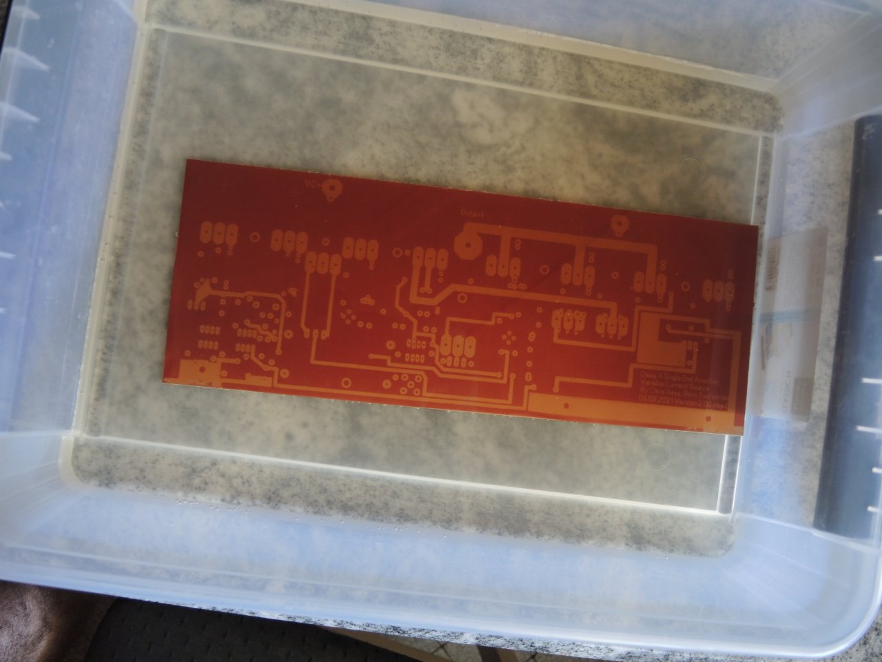

Proper Developing is not over 2 minutes and that is already long. usually it takes about 50 seconds.

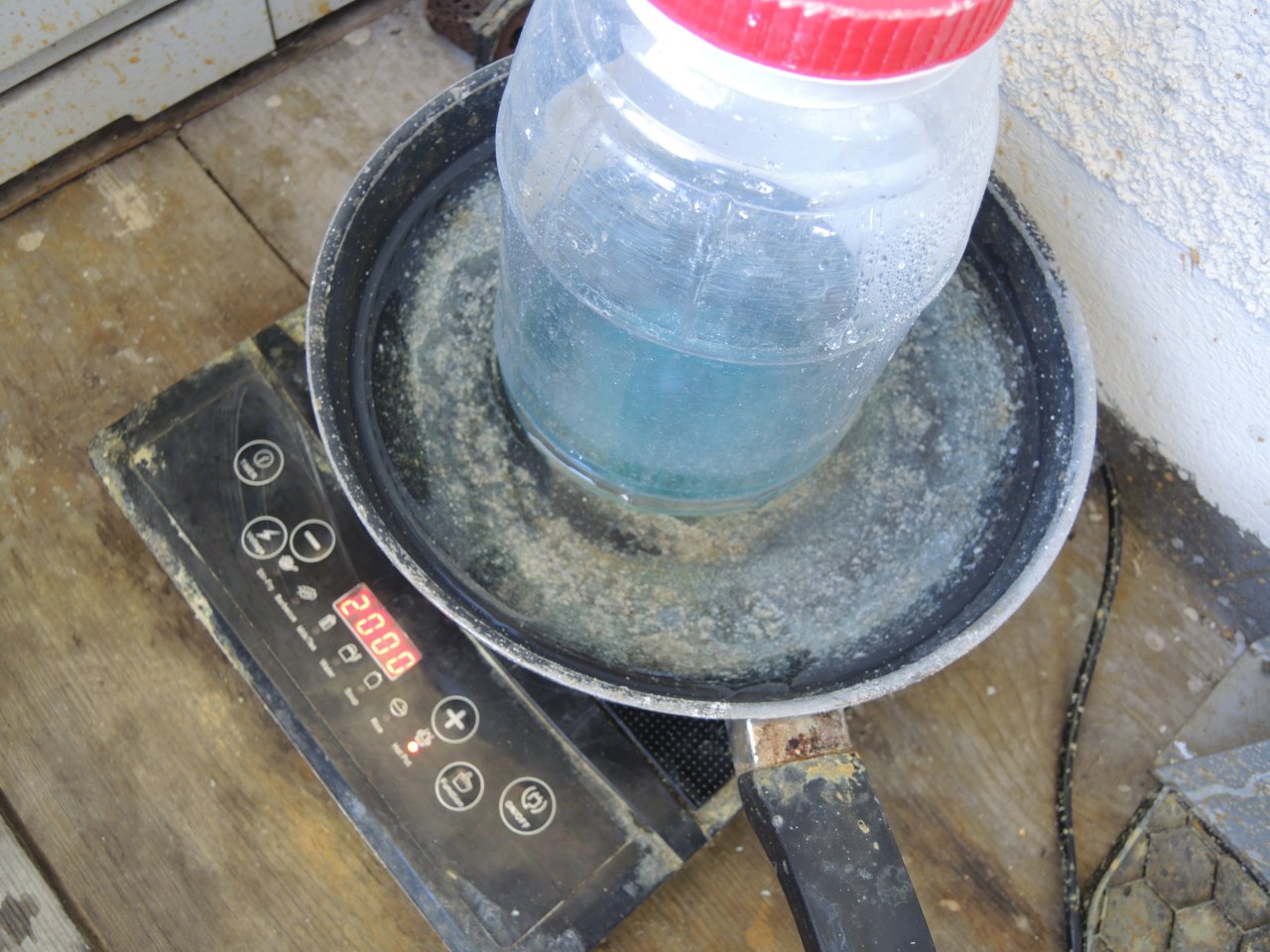

Proper Etching can take up from 5 minutes to 1 Hour depends also on the Solution, the temp of the solution and how much the percentage the mixture contains.
Heating up the solution to 50Degrees will speed up the process quite a lot..

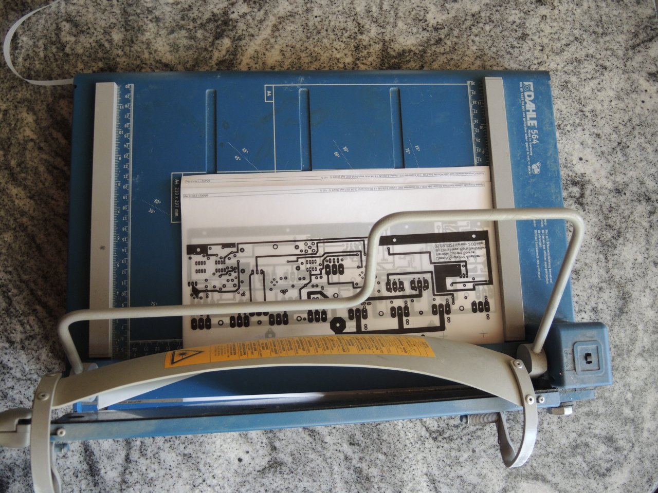

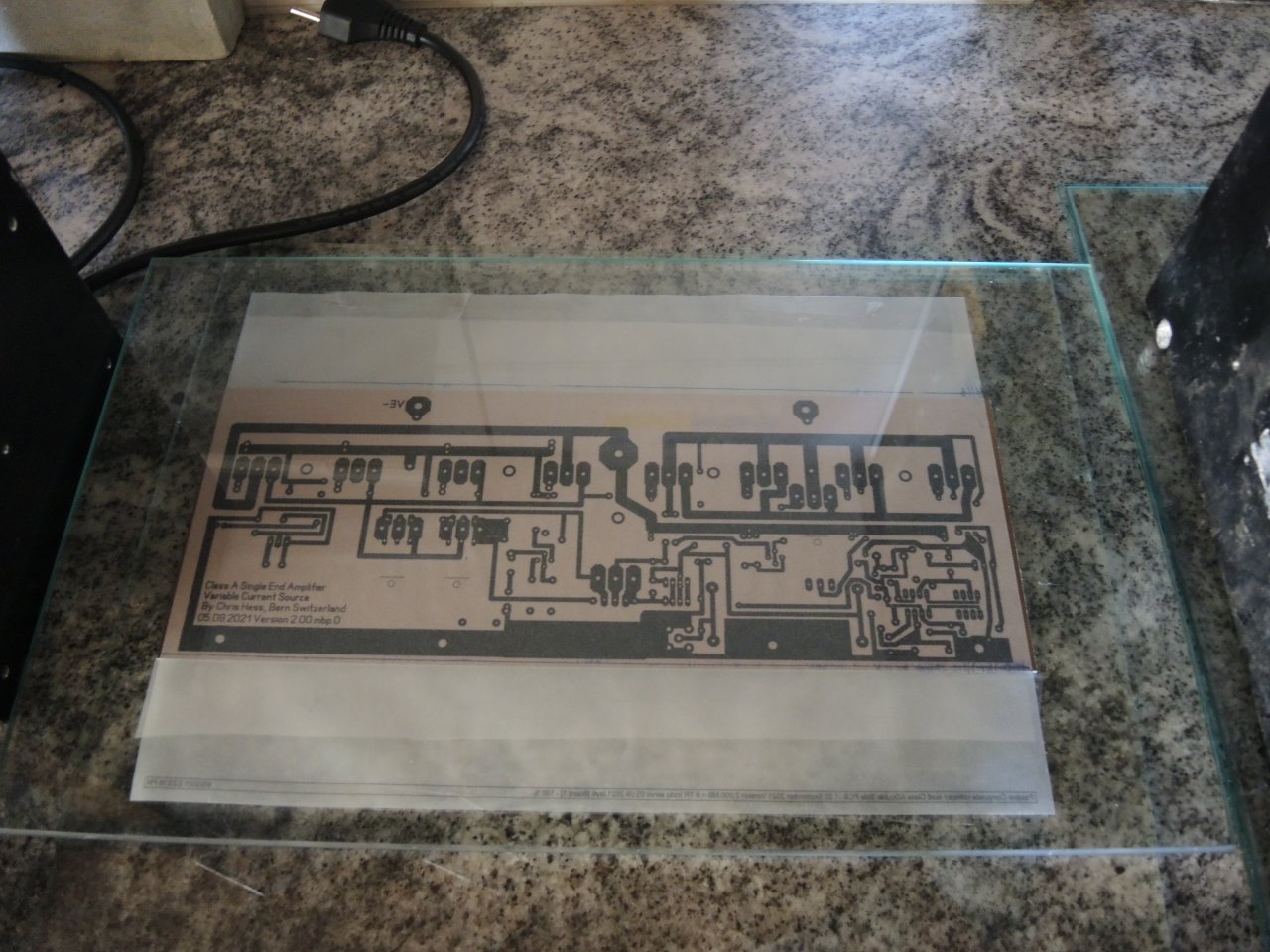

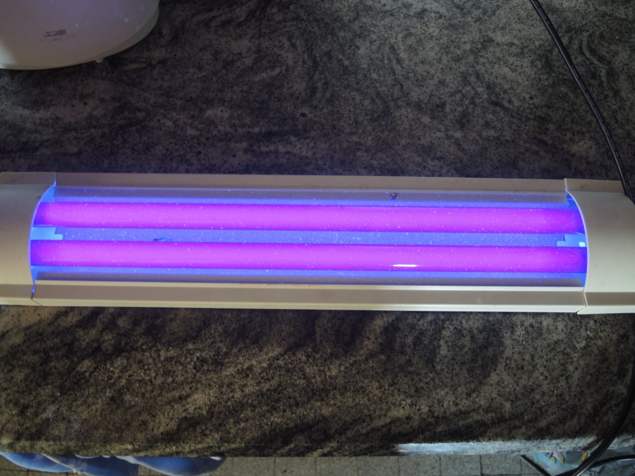

1.8. Getting The PCB into Sandwitch between the Artworkt.jpg157.7 KB · Views: 215

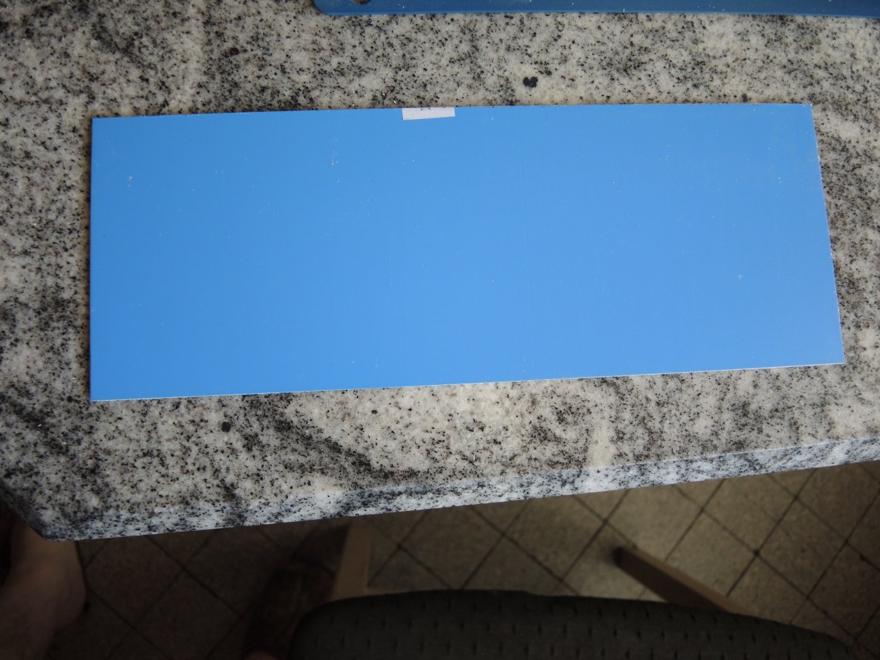

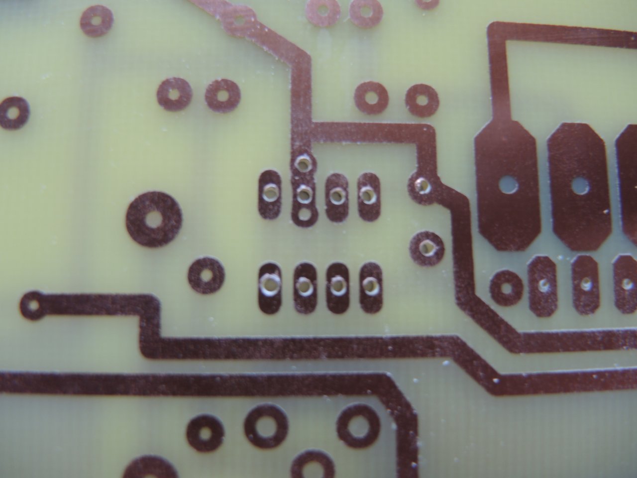

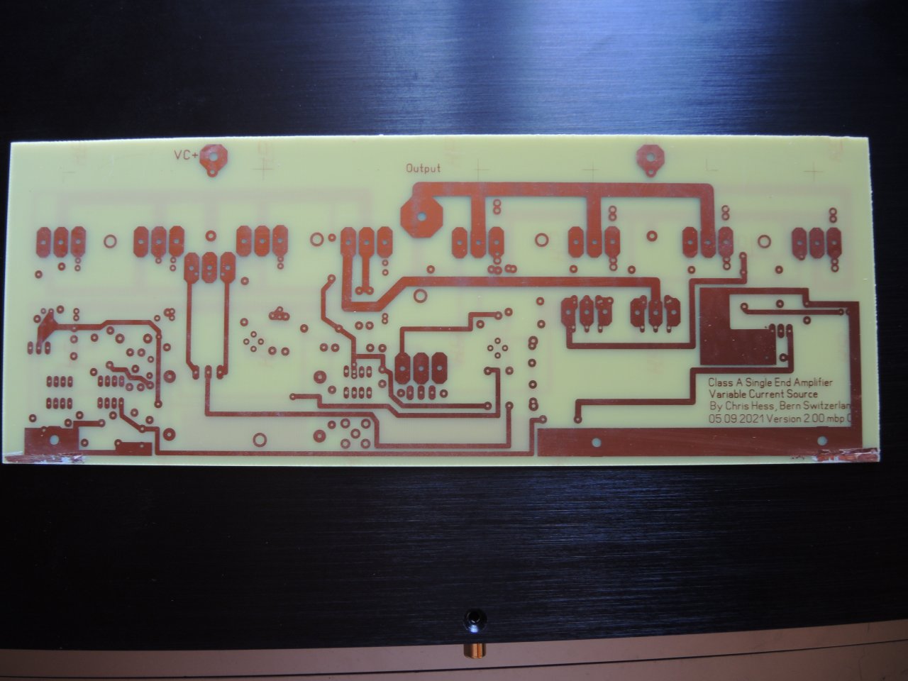

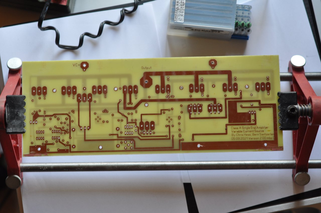

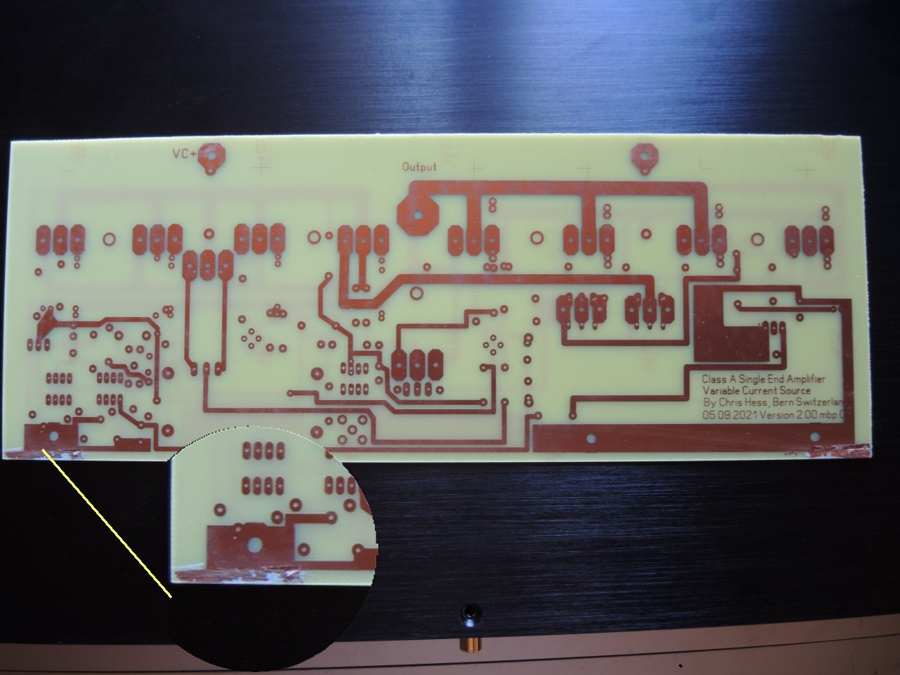

2.7 Bottemside after etching..finished and ready to drill.jpg154.1 KB · Views: 190

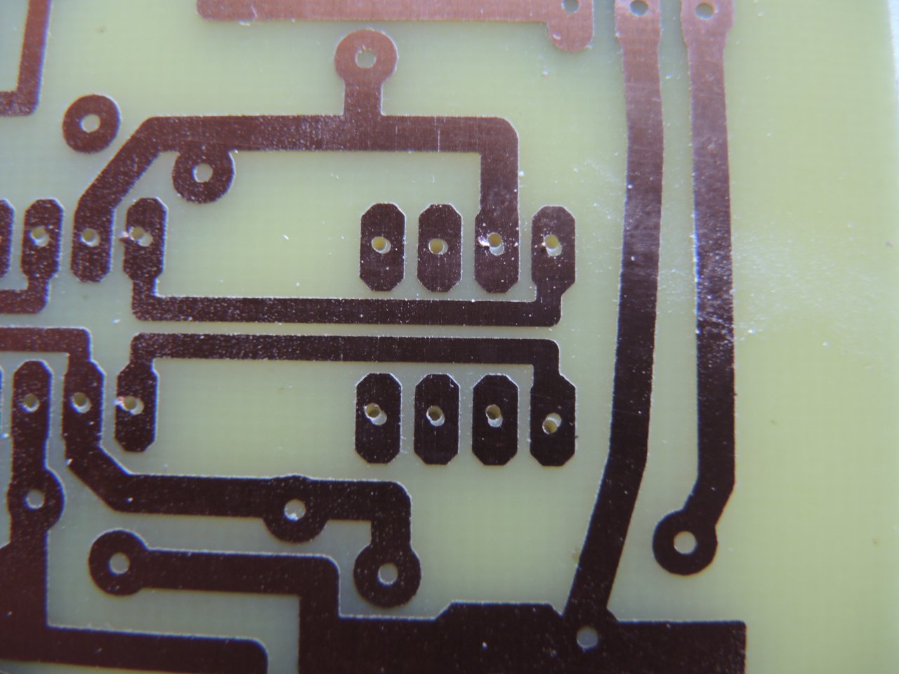

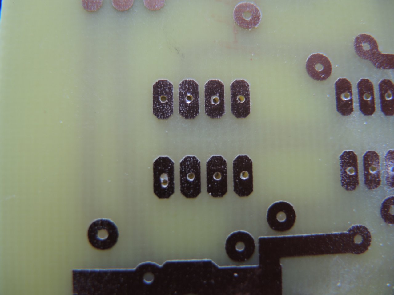

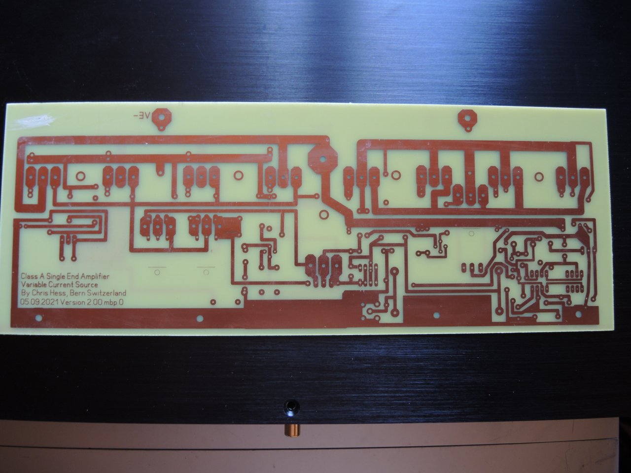

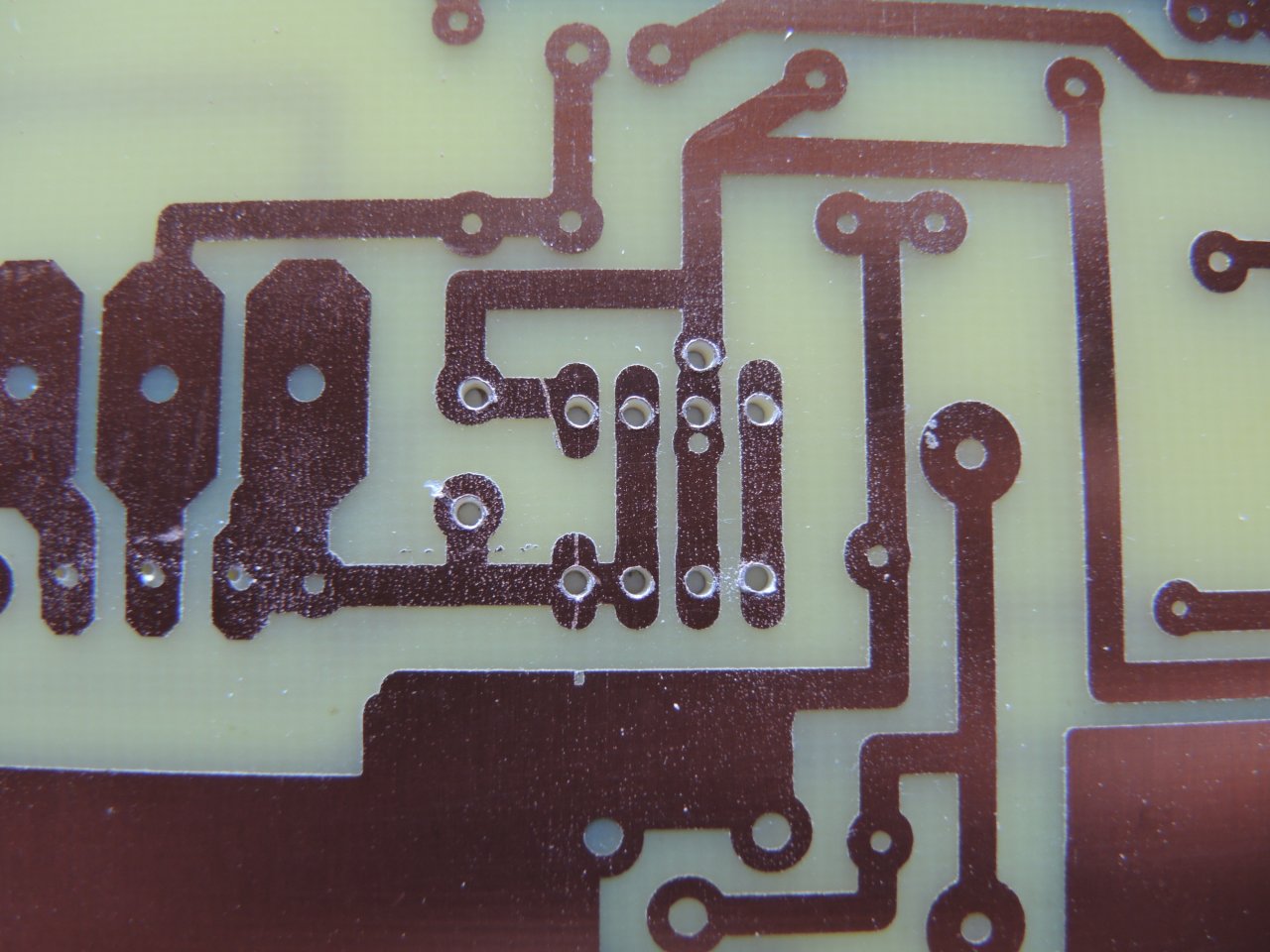

The picture in this post shows both edges of the top side of the PCB looking quite ugly.
This is because the PCB was fixed using duct tape with the Artwork Paper..
but this is of no concern and can be taken care of very easy.
In the meantime I checked the VIAS of the two sides, couldn't be better..
Meaning the holes of top and bottom side matching as it should be..

PCB looks good
Good Day
8am something September 6th 2021, controlled the Vias and through pads of that board I made yesterday for accuracy.
So see by yourself. It's quite acceptable for hand drill and hand made, it's withing 0.1 mm or less for a 0.5mm hole. with this I mean not hitting the center of the holes..
Picture 1.0 is from left side of the board, bottom side. Picture 1.1 is from left side Top side of the board the same piece, so we can see that this is QK. to insert the component which in that case is a NE5534 IC used as a PID Regulation, or just call it Servo Control. ( this is pic most left and most right) sorry for that it's because of it's naming.
The same counts for Pictures 2 and 2.1 but residing in the middle. Also made from right side, and all are withing this limits stated above..
This PCB, was done in less than 1 hour time, not including the Artwork, (drawing) but form the moment of printing it out on paper.. till finished PCB Finish meaning Etched..
It will take another 30 minutes to drill it, as this is all made by hand drill..
After that Board will be cleaned and prepared for assembling components.
also Holes on the heat sink will be drilled and threaded..
Enjoy the day and thanks a lot for reading..
Regards
Chris Hess

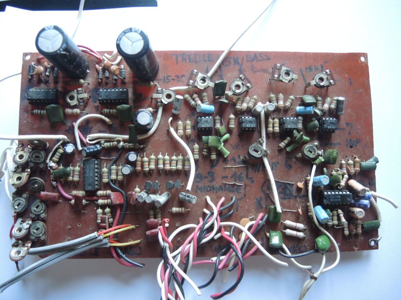

Preamp RC4739 build 1981 PCB drawn by hand
@nigelwright7557
Here two Pictures of a Pre Amp, Tone Control, Line drive I build and drew it directly with MAGIC PEN, Staedler it was if I remember right, on to the copper and then used a Art knife to shape the Tracks,.,
This was already beginning of the eighties sometime close to Xmas 1981..
I had done other things in the 70'ies but most of them got lost, when we moved back to Switzerland in 2002.. *If I find them I will place them at a later time..*
and the tracks kept till today and I'm sure that this one still works..
buy good Basis material, don't save the penny on the wrong place, invest something for your peace of heart and it will hold a life time..
Your able to see the date of manufacturing on the RCA Chips number RC4739 which were some of the best OP AMPS that time.. besides the Raytheon there are the numbers 80 36 this means 36th Week of 1980 was manufacturing date of these IC's.. This one run on +- 16 Volts.. Tone control was created with 4 UA741. the 4739 was used to switch the channels bounce less.. it's 40years , long time may I set up power supply to test it..
Regards
Chris Hess

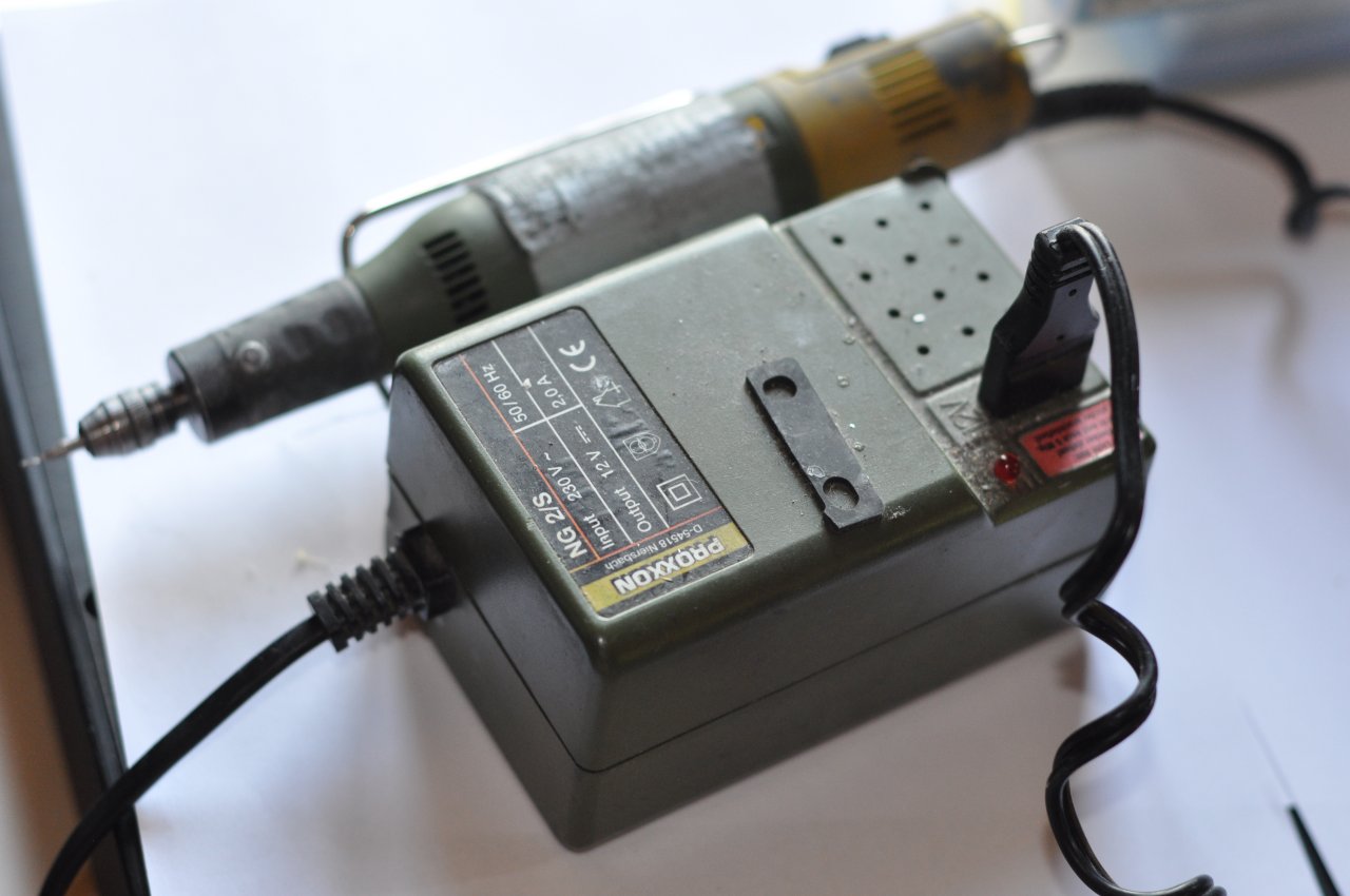

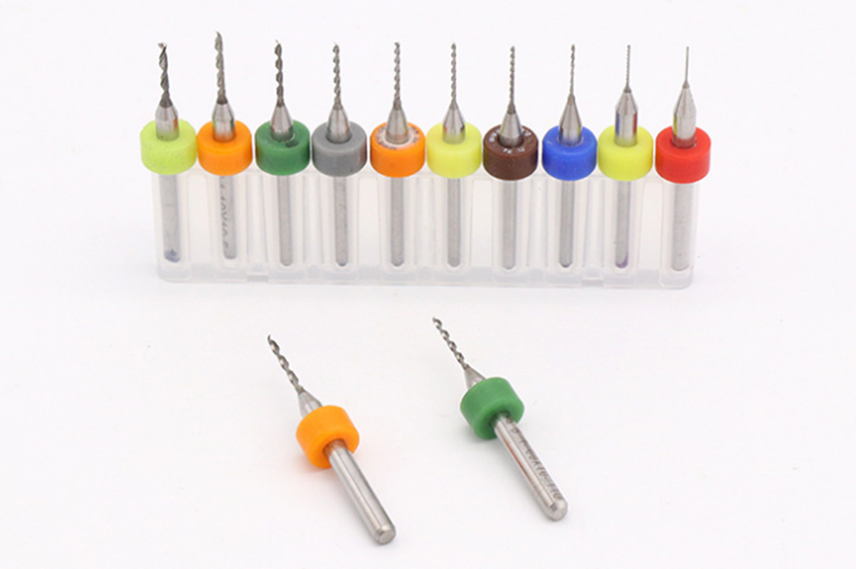

Drilling is a problem by itself.
Regular steel drills are fine, but last little if glass fiber is present.
Of course they are cheap, so you buy a pack of 1mm (easy) or 0.85mm (not that much) and consider them a somewhat disposable item.
No big deal for home builders.
You can buy dedicated "PCB drills" with a uniform mounting base and Tungsten Carbide (Widia) tips
BUT, and that is a problem at home, requires a special drill press, both very high RPM and, most important, ZERO chuck vibration, they are very fragile.
Counterintuitively, mounting them in a handheld Dremel type tool damps vibrations and is relatively safe.

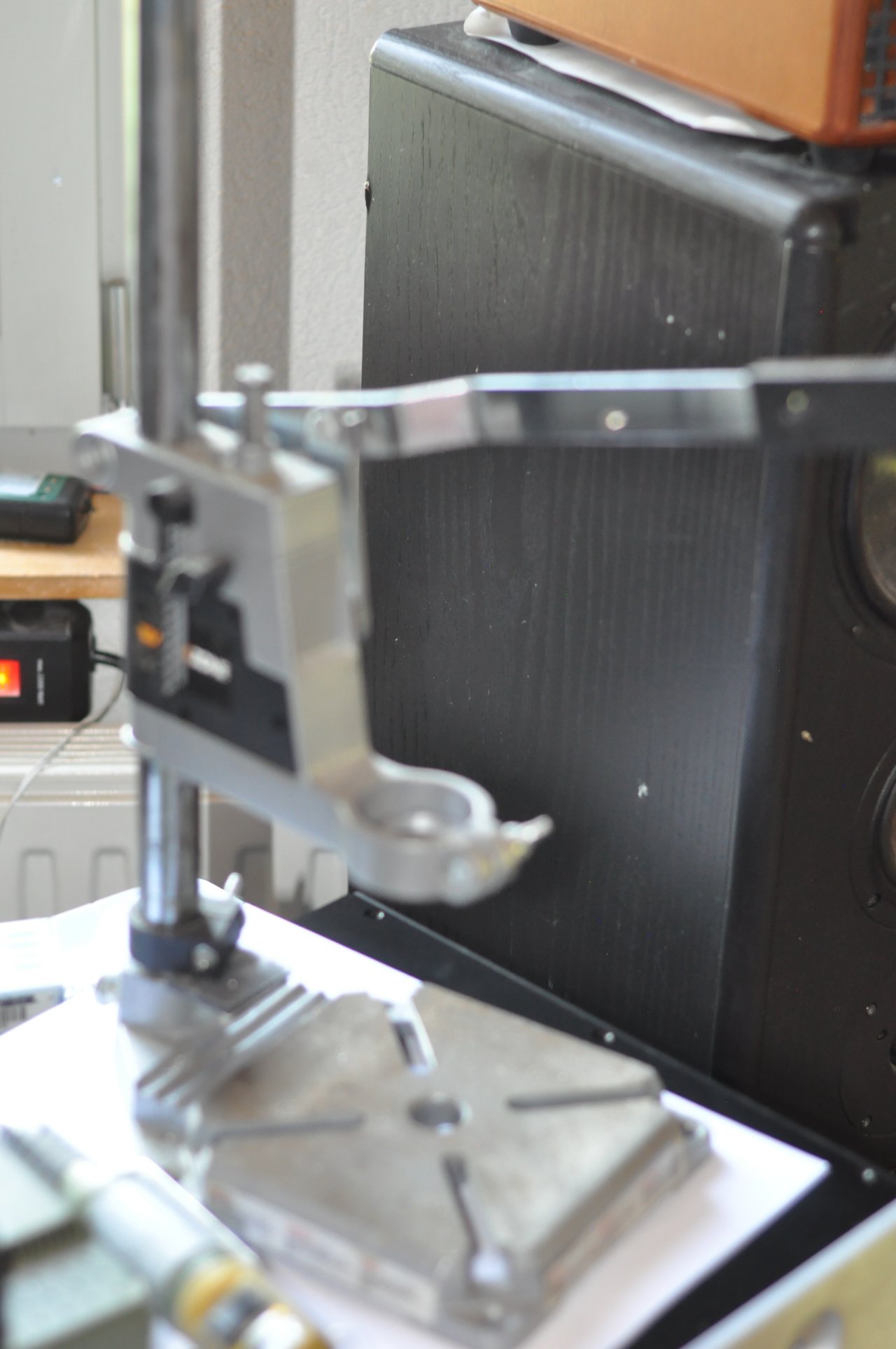

FAGILE Yes, but easy to hand drillif one has a steady hand.. I very seldom break a drill using a Proxxon Dremel.. drilling with exactly these drills starting at 0.mm (this fits IC pins..) then 0.8 and go on to 0.8mm and then 1.2mm - 2mm and 3 mm for the screws. 6mm for holes to tighten Transistor Screws passing the screwdriver (inside Imbus HEX) through to PCB..
I use also that PCB holder to fix the PCB while drilling..
I also have a drilling Stand.
