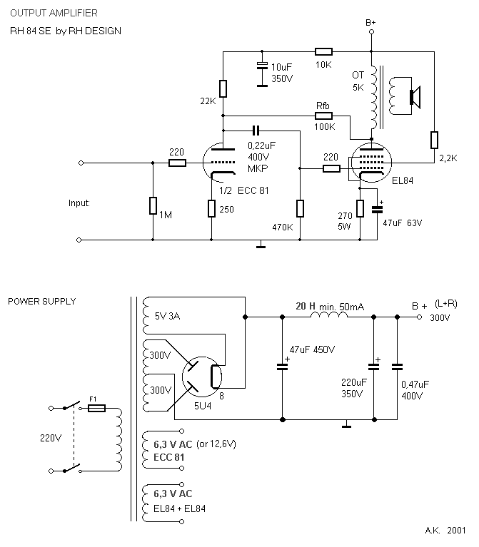

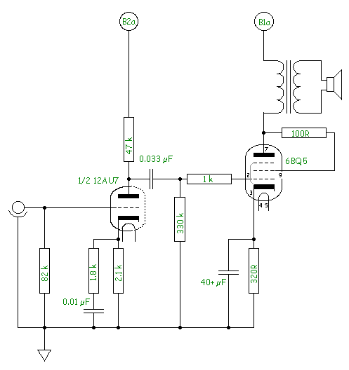

A pentode mode EL84/6BQ5 yields approx. 5 W. Speakers of true mid 90s or higher sensitivity are needed and they should have a "flat" impedance curve. Speaker manufacturers don't outright lie in their published specifications, but the claims they make frequently need to be adjusted, especially when tubed power power amplification is part of the equation. For instance, a nominally 4 Ω speaker is said to produce an 89 dB. SPL when driven by 2.83 VRMS. As 2.83 V. into 4 Ω is 2 W., not 1 W., the "true" sensitivity of the speaker is 86 dB.
I find myself concurring with Dave (planet10) in thinking use the power trafo and EL84s to build up something new. Perhaps the O/P transformers can be used too.

I will probably build a new amp with it eventually. I have never really done anything like this, so I will need to learn some more first. Ive just done a few electronics projects, mostly from kits, where you just have to solder all the parts together.
