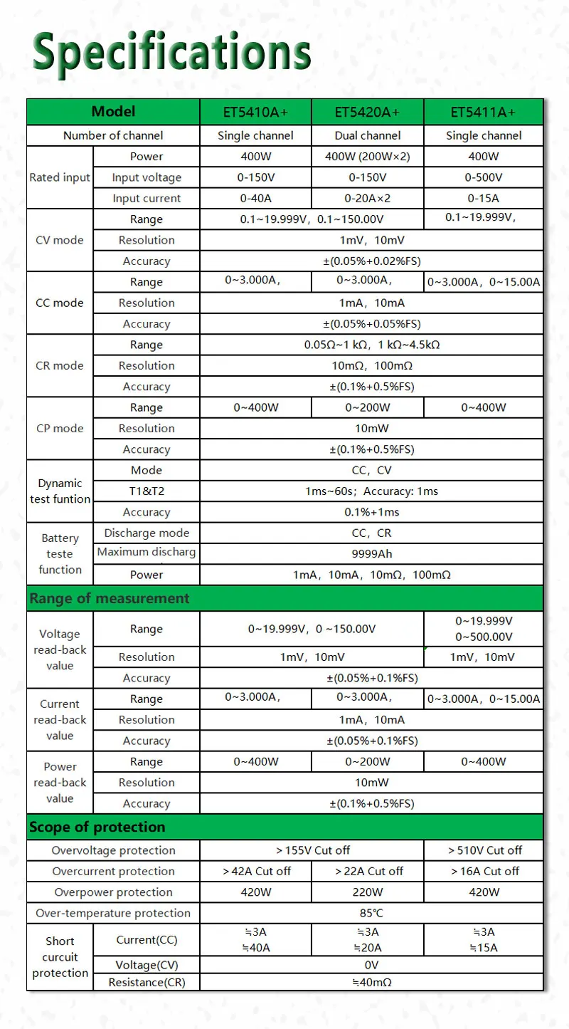

Beware, the specs are not misleading but they are perhaps confusing. The model below has these absolute maximum ratings:
  1. Vin < 500 volts . . . . and also
  2. Iin < 15 amperes . . . . and also
  3. Power = (Vin * Iin) < 400 watts
Thus if you run it with Vin=499.9 volts, Iin must be less than 0.8 amperes.
If you run it with Iin = 14.99 amperes, Vin must be less than 26.6 volts

Wow, thanks, all the ones I saw commercially were $2000 range. This would fit the bill and save my time. AliExpress has several models, search for "dc electronic load" and there is a model that goes to 500V.

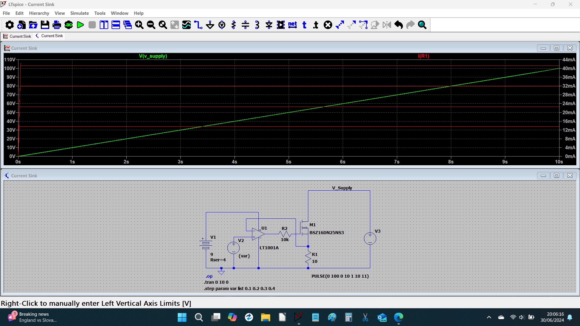

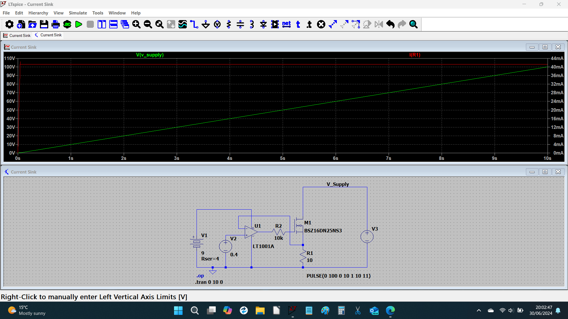

Would something like this work? Just a quick proof of concept. Battery powered, voltage and current limits determined by FET choice. Voltage on opamp input sets current limit so could be a pot fed from a micropower reference from the 9 volt battery (if accuracy needed) or otherwise just a suitable pot padded with a resistor to limit the range.
Voltage in Green and Current in red (right hand scale)
