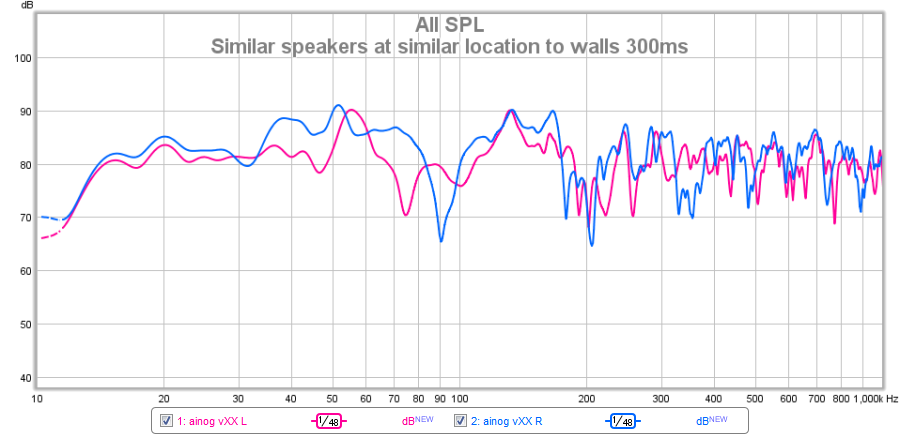

A practical example of room measurements. Similar downfiring woofers+dipole mids at similar distance to front and side walls. Mic at one spot, distance to speaker equal. 300ms gating, 1/48 smoothing. xo LR4 at 130Hz
Lowest room mode at 40Hz, below that response is even and bass response is boosted to straight line!
Room modes between 40-150Hz are different because back-wall is not symmetric (left side opens to corridor). Moving the mic 30cm or more to any directions will give a very different result.
Fortunately humans have brains that do a wonderful job to sum and process the sound perceived by left and right ear!

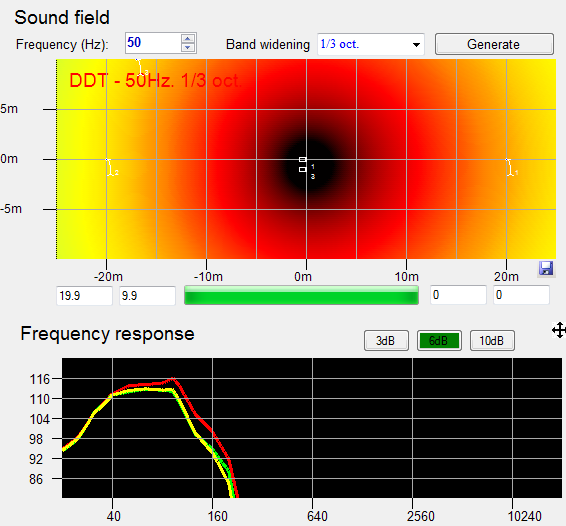

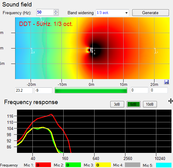

From what I have seen with simulations it does seem to add a tiny bit at HF 1dB or so. At LF it subtracts 1.5-2dB. At least with my suboptimal sims.
Stack of 3 TH118 with the middle one facing back.
With and without the rear facing delayed cabinet.
