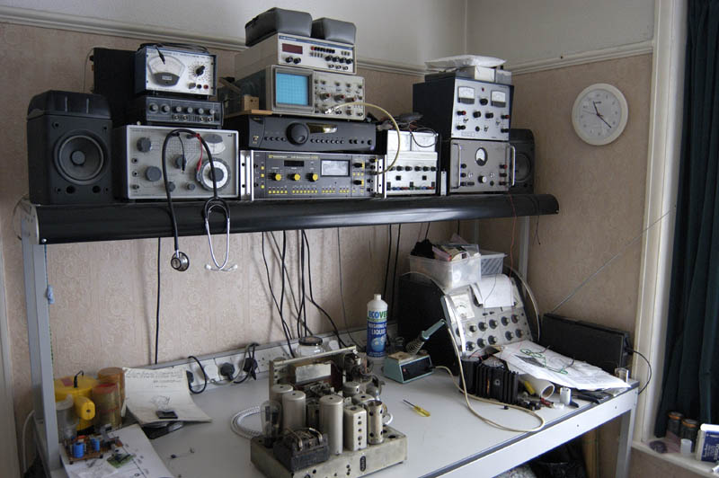

I'm with EC. The only thing I would add are a couple more cheap, (5$) DMMs, not so much for precision measurement but for watching things like PSU rails, things you don't need total accuracy for, but need to see if any gross changes occur under fault conditions or initial testing.

I am with EC too, and I agree with pinkmouse about the DMMs, with a small twist: a couple of those analog multimeters you can buy at the supermarket for $5 can come in handy, instead of the DMMs.

Look at the workbench of pinkmouse : you want that kind of workbench. Mine is not so beautiful, but it is partly metallic, a diy one. As I did it, I find it very very OK.

Thats like 5 dmm's LOL..

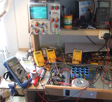

You really can't have too many meters. You need one (or perhaps two) good ones, and some cheap ones. Moving coil meters react faster than digital and can be useful for warning of impending smoke release.
I've added a picture of my bench. The inverted black guttering (lined with kitchen foil) shields the direct light from the 1.5m fluorescent and gives plenty of diffuse light on the bench surface.
EC, thats a nice lab, indeed🙂

Very nice bench EC. Is that an Alpha 10 I see up there? I have one too, but mine is off the road at the moment with a damaged DAVE module.
Jason, I have two more out of shot. 😉
