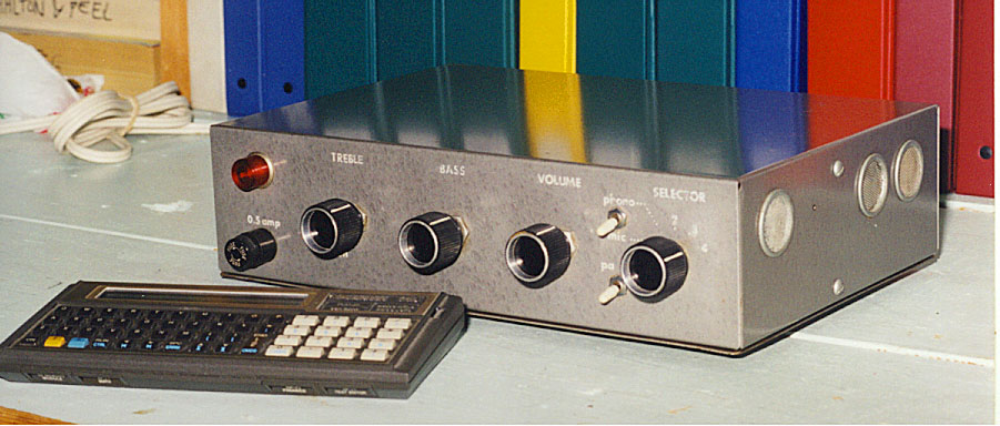

The circuit with this lineup has plenty of gain to support full loop NFB from the OPT secondary. I've built several like this, never with an expensive OPT. And used up to 20 db NFB with no instability problems at all. And got measured results to confirm that.🙂 Like what's in this one, 6AQ5/6AU6, built in 1968, still running in the workshop every day.
