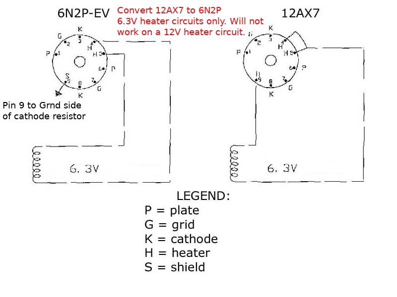

The difference between the 6N2P and 12AX7 are:
(1) the 12AX7 has the two 6.3V heaters from pin 4 to pin 5 tied in series with the center tap connected to Pin 9.
(2) The 6N2P has both heaters tied in parallel from pin 4 to 5. Pin 9 is a shield between segments of the 6N2P.
Since 12AX7 has no such shield it is best to connect pin 9 of the 6N2P to the ground side of one of the cathode resistors.
You will need to change from 12.6V for pins 4/5 of the 12AX7 to 6.3V for pins 4/5 of the 6N2P. You will probably need to add a 6.3V 2A (3 X 600mA) transformer to supply the heaters of the 6N2P tubes.

6n2p vs 12ax7 tube comparison - Tone Snob
here's a link to his pic
Photobucket
says its the one on the right for 6n2p, its just pin 5 bent over with some heatshrink and soldered to pin 9. is it really that simple?

here's a crummy ms paint drawing. i believe the one on the right is what bancika describes. the one on the left i think is what's advised in this thread.

Yep it is confusing and crazy simple too and you are nearly there.
The left hand drawing 'I think it's gotta be wrong' is. It's a dead short across the heater supply for 12 volts or 6 volts! You will get smoke.
The right hand one will work as drawn.
Just bend pin 5 over and solder it to pin 9. Now the issue is you have the internal screen of the 6N2P connected to one side of the heater supply rather than ground. It actually might not be a problem, I cannot see on the Tone Snob link where he does?
The left hand drawing 'I think it's gotta be wrong' is. It's a dead short across the heater supply for 12 volts or 6 volts! You will get smoke..

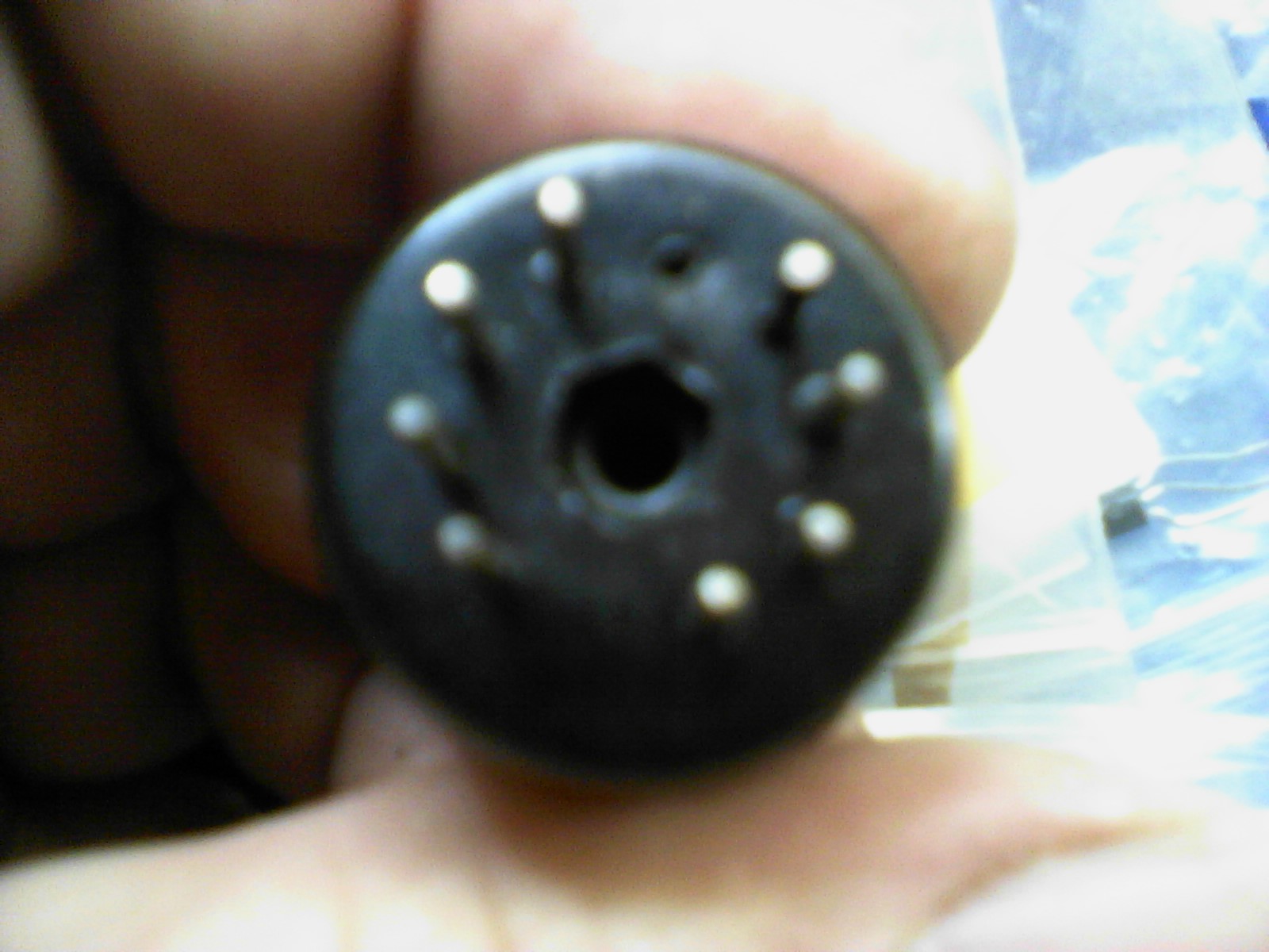

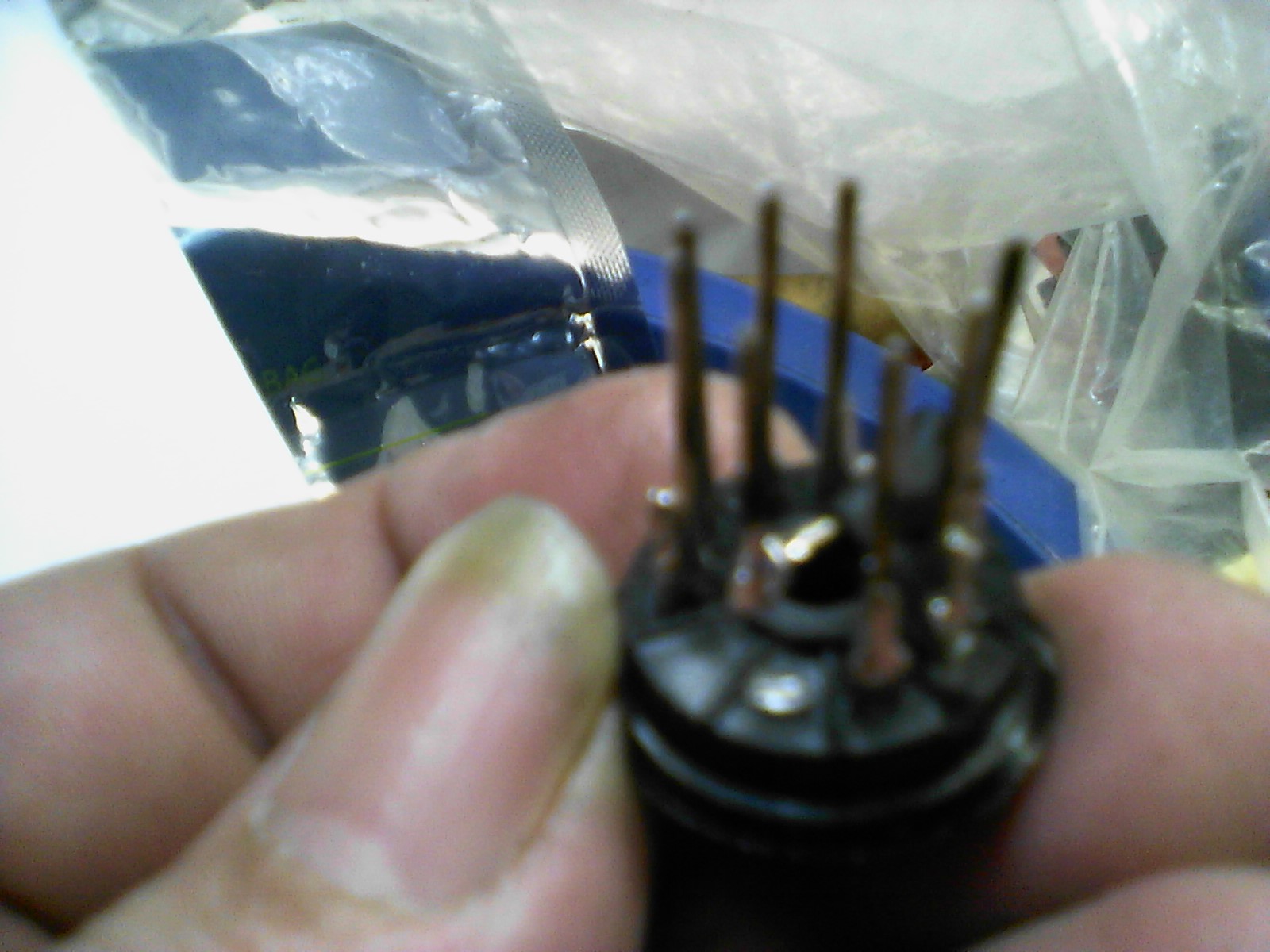

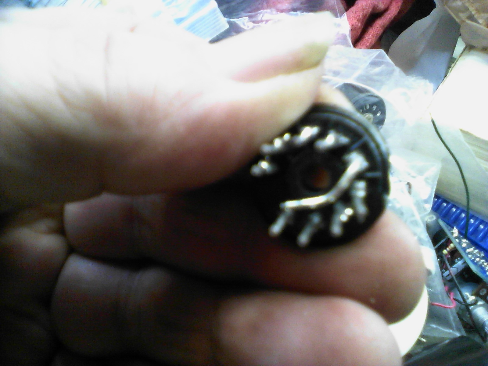

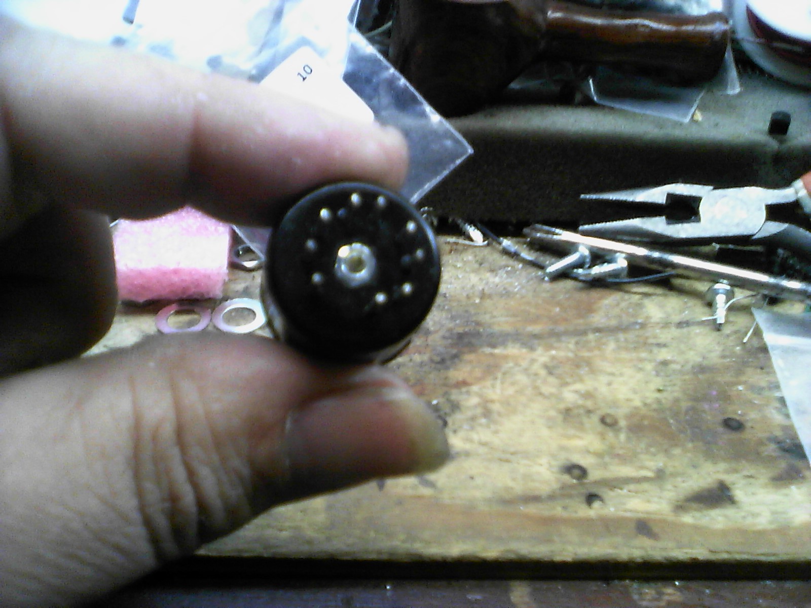

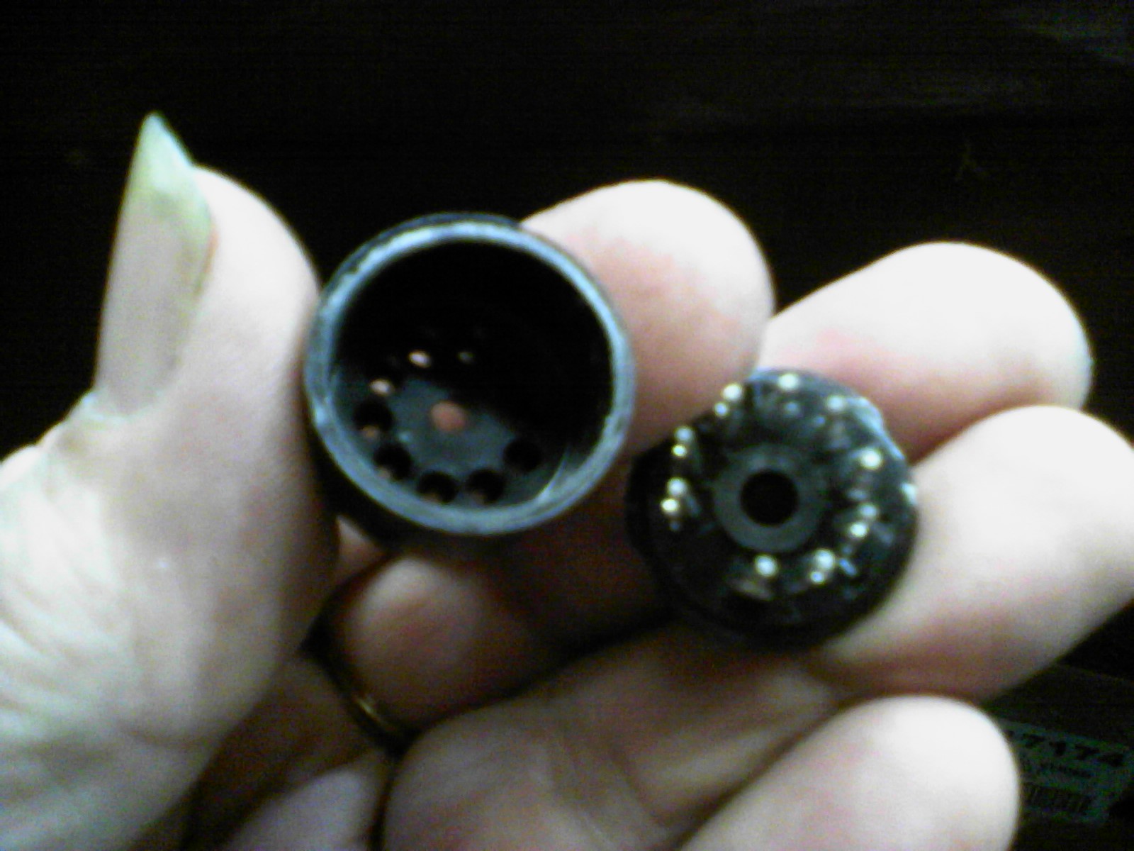

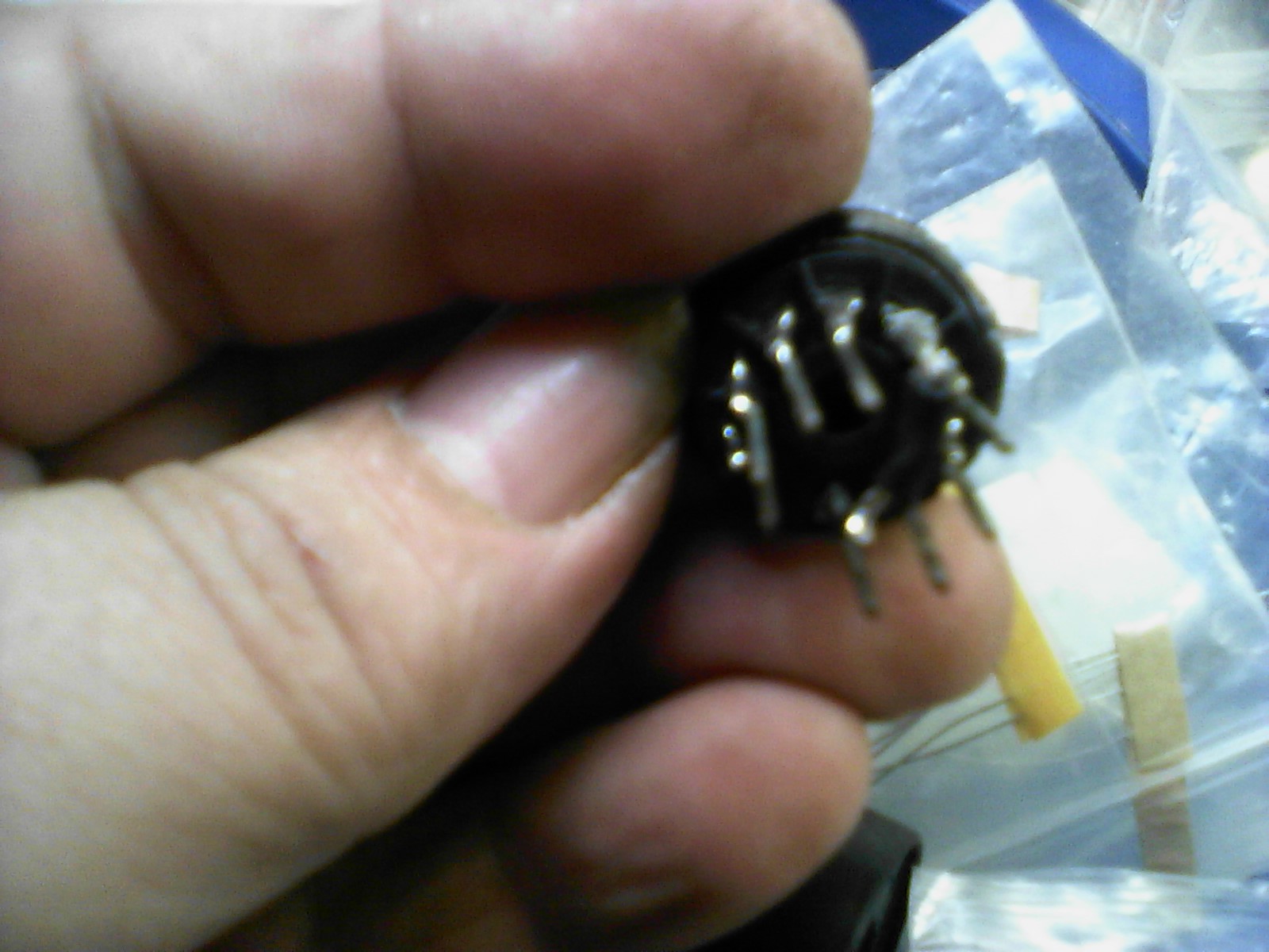

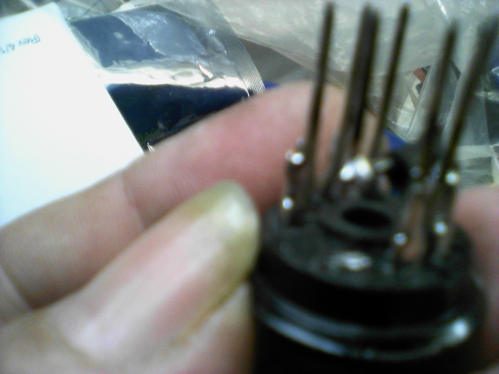

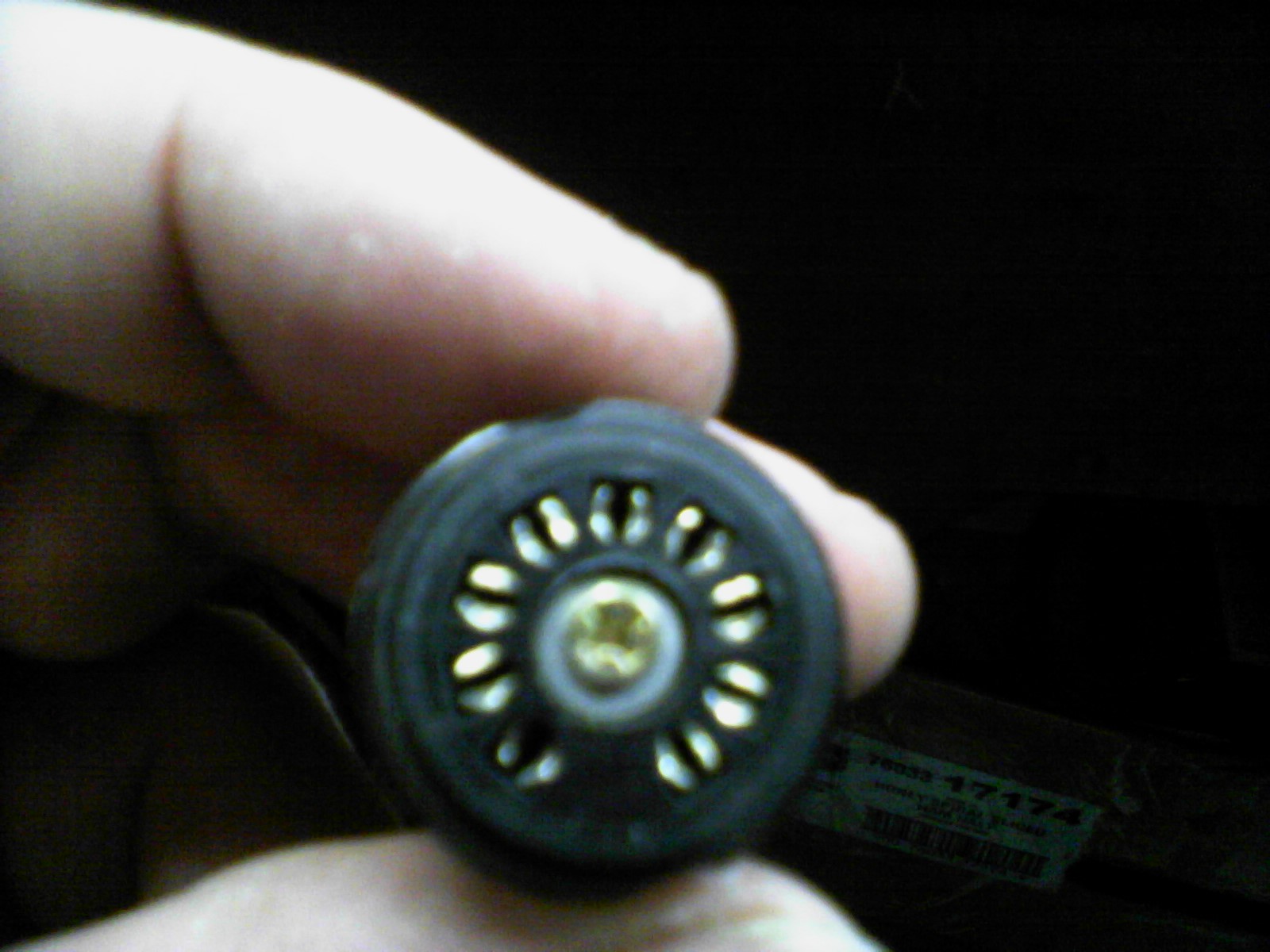

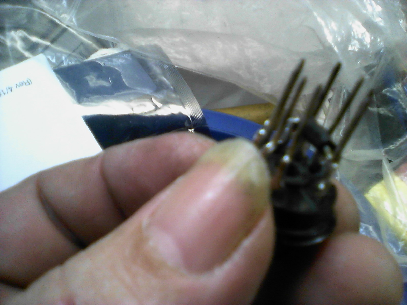

here's what i did. i didn't bother grounding the internal shield, when i tried connecting it to the cathode i got more hum
pics~!
main downfall is ya have to be careful with insertion, as with pin5 removed, you have two keyways.
literally, to make these, all ya need to do is unscrew them, open them up, bend pin 5 in a little arc to make room for the screw, put a little shrink wrap on there, and solder pin 5 to pin 9 right about where the pin joins the socket insert. use some heat, get a good joint. then cut it close to the phenolic with some fiskars or whatever, and then below the solder joint you just made. get the pins back thru the plastic holes, stick the screw back thru and screw it unto the little nut. done.
since the heaters in the 12ax7 are pins 4 or 5 in parallel and pin 9 as the center tap, to do the conversion is that easy. since pin 9 in the 6n2p is normally just an internal shield thats gonna be grounded, no need to even hook it up. works great!!
thanks for the help my friends. you guys freekin rock!!!

so i been messing with russian analogs of more common tubes, and my new fav is the 6n2p. they're cheap, robust, plentiful, and have a really great presence in the midrange going on.
they're only for fender style 6.3volt heaters.... some 12ax7's sockets are wired up for 12 volts, the 12ax can do 6 or 12, but the 6n2p can only do 6. but 6.3 is fine.
to start, go to tubedepot or whatever and get some socket savers, the kind that have a screw running thru them. check the pics.
unscrew the screw, and set the washer and screw and nut aside. i stand it up to unscrew it so the little nut just falls out. this is what the guts look like
here ya can see where i bent pin 5 across <with a slight arch in it to accomdate the screw>
and connected it to pin 9
here ya can see where i used my fiskars to nip away pin 9 from the socket where the tube will be installed. first i cut up by the phenolic as close as i can, then a little bit below where i soldered pin 5 to pin 9. the pin is stiff enough to support the soldered on post, make sure ya get a good joint before ya snip it.
pins stuck back thru the phenolic... note no pin 5. be careful with tube insertion, as effectively there's now two possible keyways on the tube. you could take a piece of medium paper clip and solder it to pin 4 if ya really need a pin 5. i just said the hell with it.
some peeps suggest leaving pin 9 connected to pin 8, the cathode, but then you're floating the shield above ground potential cuzza the cathode rc networks in most guitar amps. since its just a shield no need to even bother with it. when i did connect to the cathode i got more of a hum. you also don't want it connected to the heater supply, as it would be like an antennae i'd imagine.
anyways.. easy breezy, way easier than i thought it would be. here's the assembled socket sporting one of them beautiful tubes
and here's a crummy shot in action inside my pro reverb, first tube <dry channel>
so .... if ya been wondering, this is how ya do it. its easy, and the tubes are cheap and sound freekin great!
