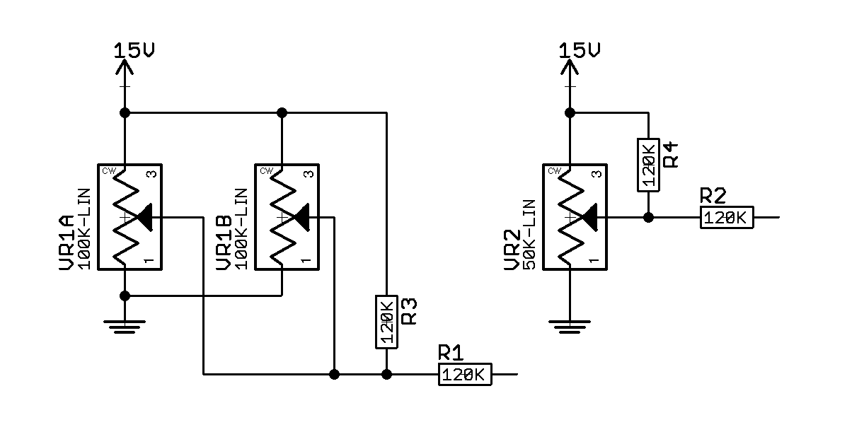

I'm trying to find a specific pot for a balance control. 50k single gang, linear taper, 6mm dia x 30mm long splined shaft, and ideally with a center detent. The only thing I can find that's close is a dual gang 100k.
My question is, would wiring both gangs in parallel, and affectively making a 50k single gang pot of it, be a viable option?
