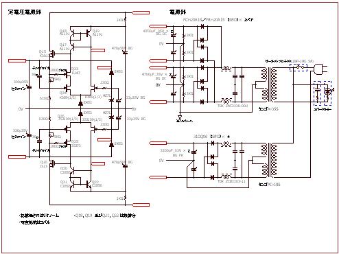

CASE 1 CR tye equalizer type
http://www.minor-audio.com/bibou/NO-NFB_EQ/NO-NFB_EQ.html
is interesting , it's no NFB pre and CR tye equalizer, But not English.
So only see the curcuit for refer
CASE2 Only FLAT amp (LINE amp) type
http://kobe.cool.ne.jp/sinotec/opamp/opamp.html
it's simple to use OP amp.This is not in English,but ther is PCB like fig.
(there is unique means using input VOL ,but II do not check it.
I think that for pre ,it is important the constant VOL regurater.
It is only reference, attach a circuit
