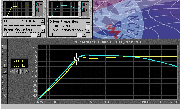

mikee12345 said:
omni-
i think we must agree on most things..
i think we both admit
--that the 15inch700 does not give quite the optimum response without eq.
..but with no other choice! its good enough.Not ideal,but ok.
because it is 97db i can afford 3db of Eq.
if i was wanting true(normalised as u say) -3db at 34hz a shiva would do it better BUT it happens to be 10db less efficient and does more 20hz bass ofcourse but cant match the effiency in the midbass.
Ah. :nod:
The good 'ole Low Bass -vs- Efficiency dilema.We all experience
this at one point or another.
Thanks for the help! I hope this works ..................... :scratch:

yep i see the graph.
yep and at the moment efficiency wins.>im studyinbg the labhorn at the moment :p
later with more money perhaps more lower frequency stuff eg lab or peerlesss or shiva...but thats later when im not a poor student :p
the eminence box program looks ok.
i wouldve tuned the peerless lower since thats where its meant to be used :-D personal preference though.
<25hz

mikee12345,
I never saved the design. I do remember that they were
in 200 liter (EXACT) cabinets dual drivers. (100 liter a
driver) Both tuned to 21, and, some change hertz.
I don't remember what was the efficiency rating in dB's
However, I can run the numbers again if you like.
Remember that was the Normalized Gain Chart. Expect
a lower response (-3dB) once you use the 1 watt or
2.83 volt method when using dual drivers in one box.
I generally use 2.83 volt for dual drivers
Best Regards,
