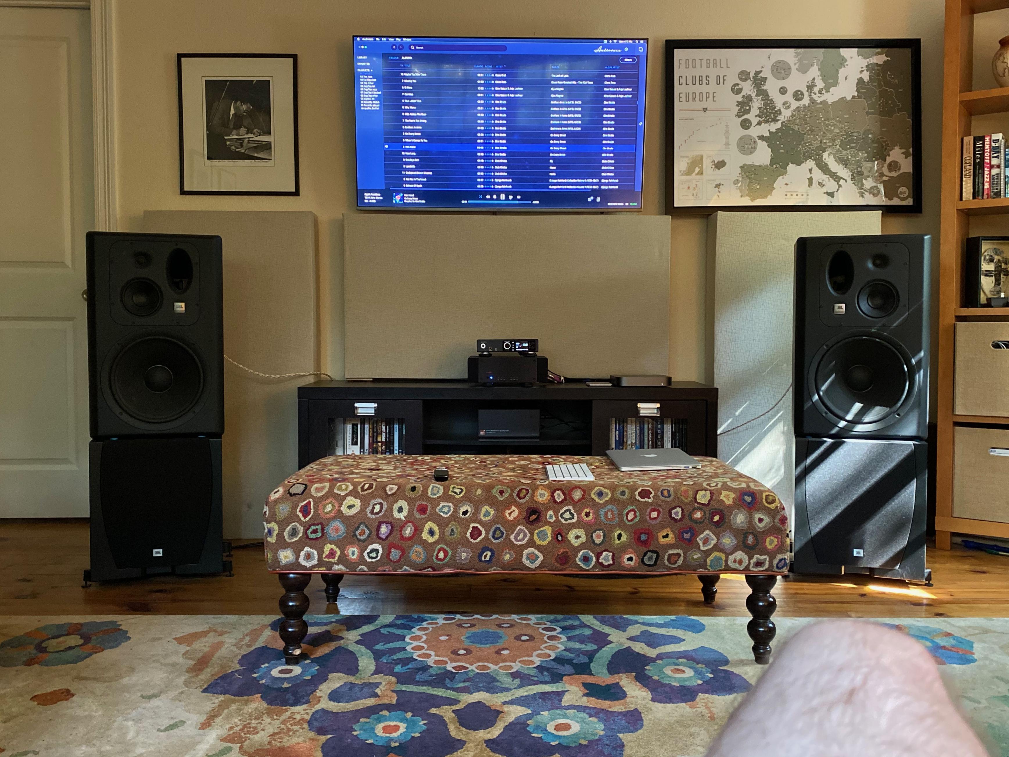

More recent. Still work to do. Wife's foot-rest thing pushed out of the acoustic path to the ears. TV all the way back, now a Mac mini to run Audirvana rather than my laptop. Similar absorber against window on the right for the first reflection. Son covered up Sinatra with a map of the European football clubs...
Just to be very clear, my interest is in making sure that I can't localise the sub. I suspect this is listener and room dependent.

Yes, the monitors (mid-field) are a fairly old design, but I think some of the first to manifest Harman's move toward controlled-directivity.
One of the nicest benefits to me of deep, effortless bass is actually an improvement in the sense of venue in concert halls/recording spaces (and the punch in pop stuff is fun, too). And yes, much of what a casual listener would describe as bass is actually mid-bass, 70-150 Hz or so.
I had sold off all of my equipment before moving to BZ for 3 years. I had been through years of all the exotica before that. My goal as I re-built was timbral accuracy and a sense of unconstrained dynamics.
I agree re. sealed bass. Anything I build will be sealed. I tried stuffing the ports without much success, but like that the subs are sealed.
And yes, the multisub approach is all about smoothing out the bass, decreasing the typical peaks and nulls around the room. In the States we have to deal with sympathetic vibrations from our sheetrock walls (Geddes uses two layers separate by compliance to absorb bass).
My next move is to tear out the ceiling sheetrock and install thick absorption extending into the attic, both to reduce higher-frequency reflections (the "ceiling cloud" described in monitoring circles), and to mitigate the ceiling-to-floor modes. Have to work on the wife 🙂
A parametric EQ in the RME at 70 Hz has also been very helpful.

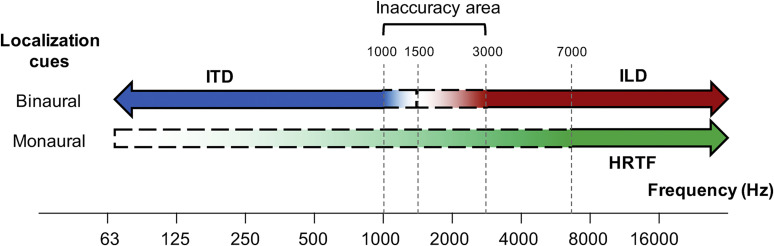

I came across this paper on sound source localization.
Sound source localization depends on 3 types of cue: 2 binaural (ITD and ILD) and 1 monaural (HRTF).
Interestingly, due to the physical properties of the head, preponderant cues depend on sound stimulus characteristics. There is thus a change in cuing around 1500 Hz, with ITD used below and ILD above [9], [12]. This leaves a “gray area”, roughly between 1000 and 3000 Hz, where the binaural cues are inefficient (Fig. 5).
Something else interesting from that paper above.
Human subjects were shown to be able to be able to determine monaurally the vertical localization of high but not low-frequency sounds, probably due to the small size of the pinna, which allows it to interact only with short-wavelength sounds [38]. Sounds can be accurately located vertically only if:
•they are complex;
•they include > 7000 Hz components;
•the hearer's pinna is present [39].
