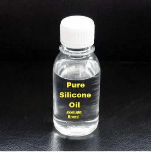

As you seem to be in Germany, from time to time at your local ALDI, they sell a silicone spray in small red/white or orange bottles. This stuff is very clean and thin silicone oil. After cleaning the speaker with a soft brush, then a damp micro fiber cloth, spray this stuff an a small piece of cotton and carefully apply it to the surounds. You should be able to remove some of the greyish coloration from the rubber. Another option, after cleaning, would be to use "Armour All" for cars. It leaves a thin film on the surface that proects from UV radiation and oxygen. Reconditions the look just fine. Don' use too much of it, just enough to evenly coat the rubber. It contains latex formulation. Don't use too often and only on a clean surface, as it builds up a film if used excessively and mixes with dirt. Used carefully a good product.

Thank you all for the valuable advice.
I might try silicone oil at first as it's easy to apply and I have used it before, although this was on ABS plastics not natural rubber.
