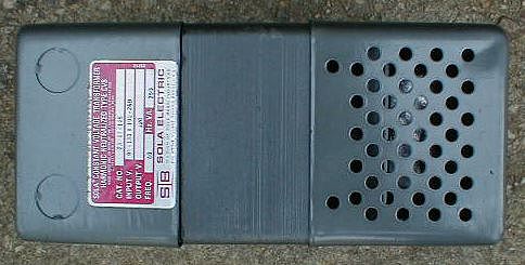

Have you considered something like a constant voltage transformer? They are also sometimes called boot buck transformers.
These guys posted a nice schematic:
http://www.aelgroup.co.uk/hb/hb511.htm
Two secondary, as the primary voltage fluctuates the output of the secondary averages their values.
