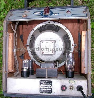

MAP-105 is a good little amp. Not even that little; it may be for small clubs at SPLs you can talk over (so, pre-1954).
It is hard to believe that rewinding PLUS ad-hoc shipping two ways is cheaper than drop-shipping stock product from a major factory. Let's at least write that out and see if the customer faints.
Hammond 290AAX, $51-$66 ($67.50 shipped from Mouser), physically good, 490VCT@90mA, 6.3V@1.25A, 0.6VA low on heater winding but 11VA high on HV winding

It will certainly work fine there. In theory filament winding is slightly overstretched, in practice no big deal.
If largerv than original, you have 2 options:
* mount it fully over chassis.
or,
* IF you insist on mounting "like the original one", *maybe* it fits on original cutout; if not, a hand nibbler can resize the cutout.
