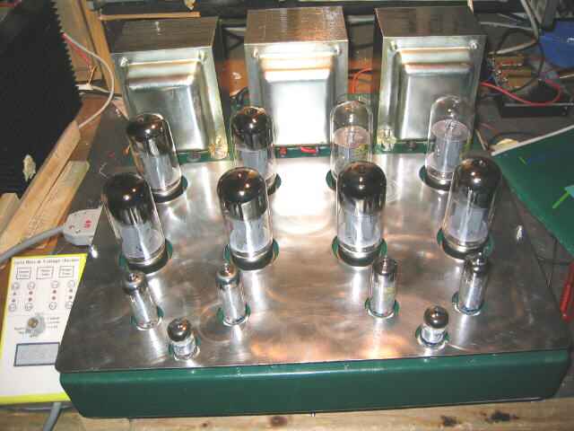

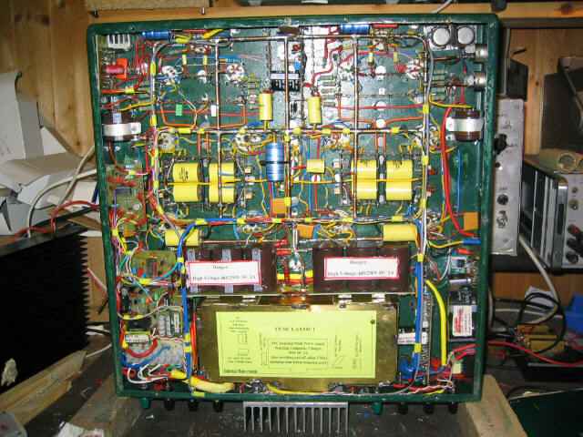

Hi there....I did this woppa 2x 175W amp several years back using switchmode pfc. Weight about 65Kg.
Interesting comparison and complexity when S State B+ is thrown in with also alot of protection circuitry required. This amp used a smaller sized mains tranny (600VA) merely for line isolation.Note absence of tube rectifiers and uses earth busbar circuit.
A massive bonus is dual switched B+ one setting for normal listening Class A 250V+ 30wpc and AB2 530V+ for full 175W....the former ideal for tube longevity. As mentioned a lot of hard nights working took nearly a year bis complete.
Complete digital setup for bias and hosts of other features....Brill performance but Would I do another build , No!
hope pics come through
richj

Rich,
That is OUTSTANDING!!! I am humbled and tremendously impressed all at the same time.
Having built a much simpler circuit-but with the same layout and circuit design asthetic as yours-I can truly understand what it took to build that masterpiece.
I'd say there are very few builders in the world able to do that kind of work. I can only hope to get there one day myself.
Wow. I wish I could say something more profound, but I'm too stunned. Wow!!!
Rich, if you've got some time and don't mind me taking up some of it, I'd sure enjoy asking you some questions by e-mail about your build.
Sorry for the hi-jack, Almost-but that thing deserves recognition!

This bit of preamble is also for others to read....when one builds a tube amp one has to decide keeping matters simple i.e how much power one is after and type of topology, but when one enters the real power game, designs require more thought.
This 2x175W tube amp audio circuit design itself (as you know) doesn't consume much brain time....some research was done on getting the performance of the drivers right which after alot of josling I ended up with good ECL82's strapped as triodes....sloppy gain but ideal low thd Z Miller dump characteristics for o/p stages....requires p-p driver stages sucking 35mA at 360V. (sep B+)
...in the case of using solid state en force... it's all the subsidary safety circuits that take time....... I did the pfc (in biscuit tin) using surface mount (smd).
I would advise anyone using smd on standard pcb to solder a bit of reinforcing pcb (edgeways as a stiffner across back) to avoid any possibility of bending. This is important with pfc or other designs as a broken joint/component spells immediate disaster.
This high power supply firing AB2 has to supply at least 1 ampere at 530V without sagging so it won't budge if a tube goes down, and with fixed bias some sort of interlock is required to avoid meltdown. Fuses in each o/p tranny primary is essential to avoid permanent damage. It's this and other watchdog circuits that complicate issues. As a system designer, the step into the realms of true power supply design can be challenging when every fault condition has to be allowed for. The simplicity of the standard EL84 /34 design has alot going for it and cannot be overstated and walking into pfc design is more than a high wire act.
Understanding this stuff is fine but so often reads on other threads the interference problems gets many bogged down. unfortunately solved emc over forums cannot be done without proper RF experience. Putoff ?
The bit I would really like to mention is the attractivity of the class A parallel p-p pairs condition at 30W per channel with reduced B+ of 250V allows so many tubes to be used from 6L6's 5881's + KT's in fact the whole power pentode class and with great longevity. For HiFi this amp can deliver poke.....But a lock and key is required so one doesn't accidently fire up fledglings on board with 530V .
Some might notice the 600VA tranny is small, isn't really as pfc tracks true rms so one can use one size down. The use of a mains transformer isn't novel.....remember heater supply for 8 power tubes will suck nearly 100W and other smaller tubes down chain can be ignored but the tranny simplifies heater juice and also the interstage B+ 360V . ....
For trumpet powers I use solely KT88's to make a noise but many have tried this amp with guitar without feedback (16dB) and like different combinations of o/p tube.
What I've really ended up is the same as the Mesa boogie but not so flexible.
Quick Anon---more later
richj
