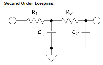

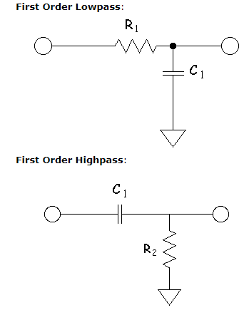

Here's a picture from that page:
A highpass dampens the frequencies below a specific frequency.
A lowpass dampens the frequencies above a specific frequency.
A 2nd order filter (falls by 12dB/octave), is basically just two first order filters that work together to make a steeper filter.
The active analog filters are basically the exact same thing as those passive line level filters, just insert two op-amps, one before and one after the filter to act as a buffer that ensures specific load conditions, ensures that it behaves in a predictable manner.
If you want to go fancy you can drop the op-amps and make the circuit yourself, but it's the same thing really.

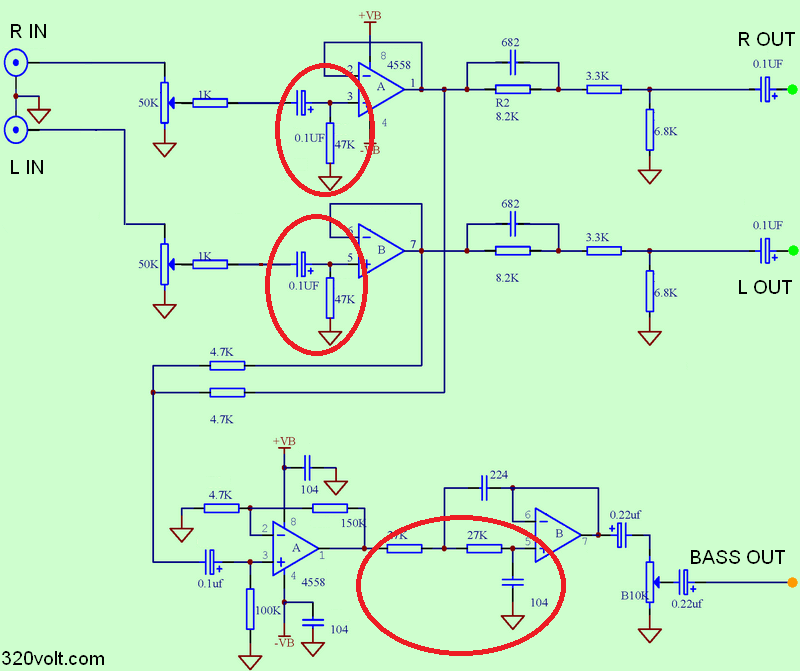

Sorry man, lots happening with extreme weather events here. I will definitely teach her what I learn. She has her own collection of electronic parts like LEDs, buzzers, resistors, switches and such and a large work board that we made for a with low density fibre board. I hope she not only masters music but things that make music
From what I can understand from reading so far
Series caps and resistors to ground is high pass and series resistors and caps to ground is low pass and that is what I should be looking for in the schematic that I originally posted and then try to use a formula to work out the filter point? Can anyone please confirm if I am understanding that correctly, circled in red
