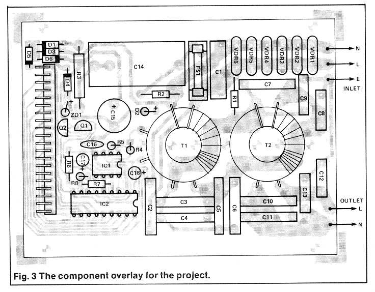

I actualy picked up the whole thing from a guy selling the kits on ebay (well, the PCB and components to go on it), but now that I have seen it, I think that it wouldn't be too difficult to come up with something better by yourself.
Also, if you look closely at the picture below you can see how the main tracks have been routed for the PCB if you want to try and coppy the design for yourself.
