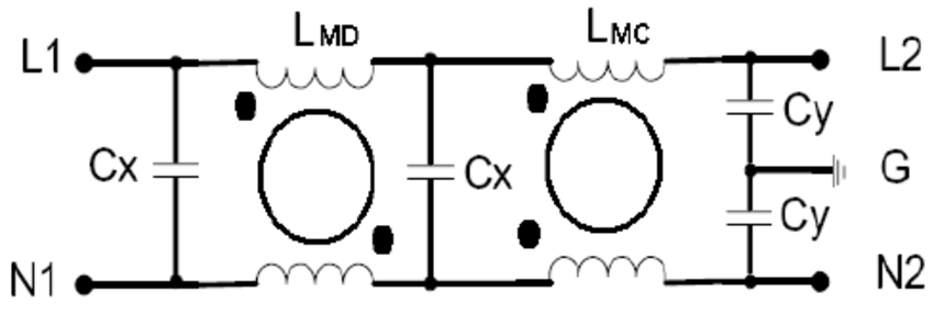

Schaffner specify the frequency response of the filter (<3 dB attenuation below 10 kHz rising 35 dB at frequencies above 1 MHz) for '50 Ohm/50 Ohm Sym' and '50 Ohm/50 Ohm Asym'.
Ermm... what does this mean? Is this the impedance assumed on the line side and amp side? What does sym(metrical) mean in this context?
Thanks Osvaldo.
50ohm/50ohm for source/load impedances
Asymmetrical is common-mode, symmetrical is differential-mode
Most likely the LISN (Line Impedance Stabilization Network) test setup. This is a common filter test configuration. Unfortunately is seldom reflects real world situations.
To measure a filter you need to have some terminating impedances. It is convenient if these happen to coincide with the impedance presented by most RF test gear. At other impedances the filter will probably still do something useful, but we don't know.

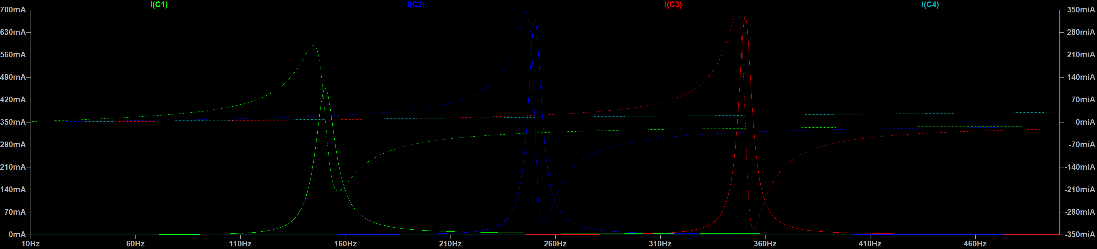

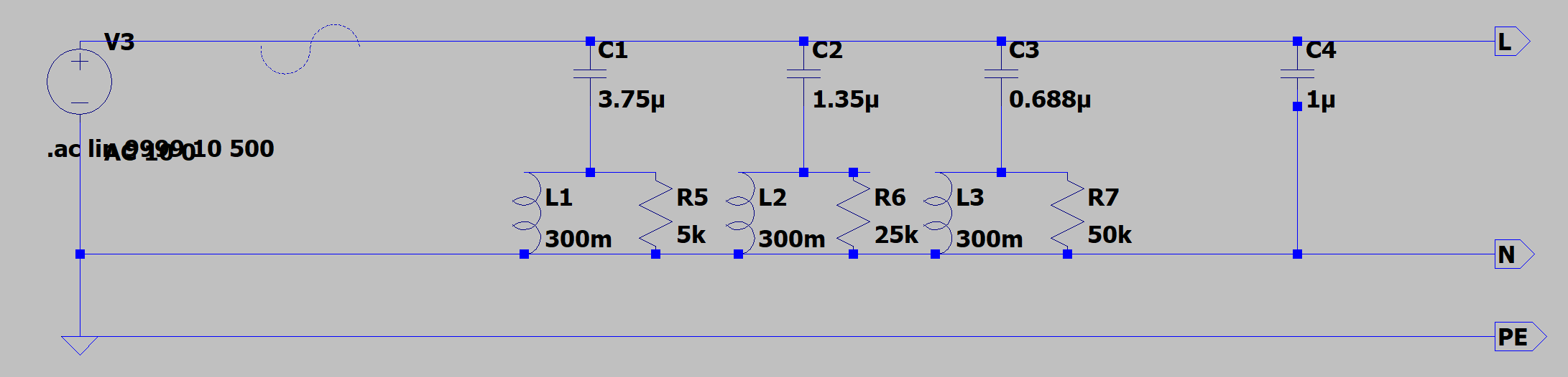

Motivation: DIY Class A Amps with beefy CLCRC filtering always sound awesome. Beefy Denon AVR sounds awesome in the evening/night but shitty during the day. Tried isolation transformer on AVR with little effect during the day. Measured THD on the mains and found a significant difference day/night. Day: 2% THD mainly 3rd harmonic; night 1.2% THD distributed over 3rd 5th 7th harmonic. As there is a good correlation I´d like to get rid of the mains distortion.
As I do not want to buy a regenerator to test this, I want to try a parallel notch filter for each odd harmonic first. Surpisingly I did not find any design like that, which might have a reason. Attached is a schematic with the notch filters. Of course caps will be line rated and the coils will be 1A rated (reactive current from fundamental 0,5A + 0,5A current at notch in case of 3% 3rd harmonic). I guess tuning the cap values to the inductors will be PITA.
Any comment is welcome.
Edit: no series element is a design decision (dynamics restriction etc.)

Many thanks Phase. Sounds like you are running the usual EMC/EMI filter. I want to aim at 150, 250 and 350 Hz.

With a mains line impedance of 0,5 Ohms and earth impedance of 0,5 Ohms the filter reduces THD only by 10%. So it is a brain fart 😱
