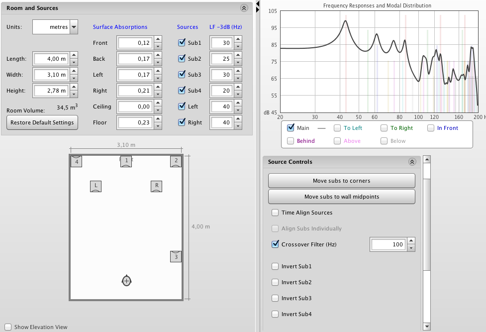

Recently I went for the Dr. Geddes approach of aplying multiple subwoofers to get a really flat bass response in my small room, and it's really awesome what this can do.
Them I came with other problem, after placing 3 subs is my small room, my main speakers are just too big for my space, they are 220 liters each 🙂
So I'm planning to build a 3-way or 2-way speaker that does not need to go low because I already have the 3 subs, 50hz is a good starting point for the lows.
The crossover is not a problem because I will go for an activeone, so the main concearn is the drivers choice and type of enclosure, sealed or ported, 2 or 3 way... I really have no idea where to start, I only now that it has to be small, at most 50 liters each. Any idea?

60Hz has a wavelength of 5.73m, 80Hz is 4.3m. The directional features people hear are probably simply caused by modal pressure gradients. There is no real localization of a low frequency source in acoustically small rooms.

My mains are a JBL L300 clone, with a difference that the mids and tw are ScanSpeak, 8545 and 6600 illuminator.
Of course I could use the SS drivers in a project... As the bass concearn is not important, maybe a sealed project with these drivers could work, but I'am afraid that the low-mid quality that I am hearing from the JBL 15 inch drivers be lost. The Xover is at 200Hz so the 50~200Hz region is my achilles heel.
