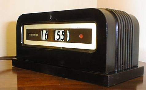

I have on old "digital" clock from the 1930s that I found in the rubbish in San Fransisco. At first it ran slow, until I cleaned it and lubed it. Now it keeps accurate time.
It's motor driven from the mains. I don't think they did oscillator clocks back then, at least not for home use.

Lesser things than that have been called digital. Its quite nice actually.

And if a synchronous motor can't run slow, why did my mains powered clock run slow until I cleaned and lubed it?
Synchronous motors can *not* run slow, its in their basic function principle. They run synchronous until the load is larger than their torque, then they just drop out of synchronity and stop.
Your clock did not 'run slow' in a continuous way, I think. The sticky mechanism imposed a too large load on the motor and it probably stopped for a short period from time to time, until the repeated starting attempts (in both directions) succeeded to overcome the friction. Averaged over hours or days, this would appear as 'running slow'.
