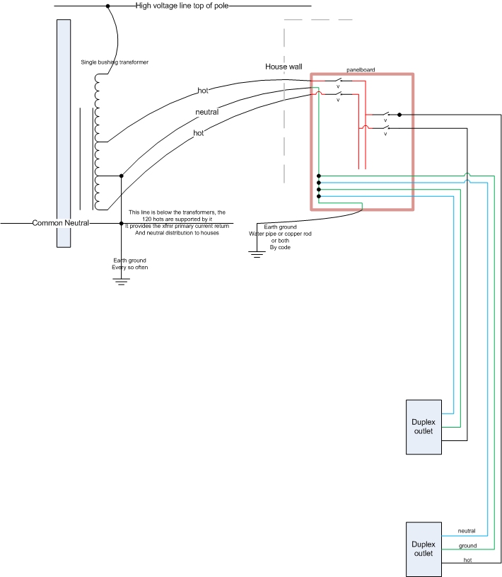

rowemeister said:Also what's the 'aluminum service drop'
"Service drop" is defined by NEC:: ""The overhead service conductors from the last pole or other aerial support to and including the splices, if any, connecting to the service-entrance conductors at the building or other structure.""
On this side of the pond, the aluminum wiring can be the cable from the meter pan to the main breakers in the panelboard in the house. It will be type SE or USE.
This is the standard house feed on this side of the pond, east coast. It refers to a single bushing transformer on the pole. On the west coast, I've seen two bushing xfmrs..
ps..note that I didn't think to include the meter...oops..
PPS..note that there are grounds everywhere....the three phase powerfeeds on the top of the pole( in residential areas, only one phase is up there). The pole neutral will be earthed within a pole or two of your house, the house will be earthed where the service entrance comes in, you'll have a bonded ground to the water pipe feeding your house. And the ground and neutral are tied at the panelboard. But the duplex grounds never carry the current from the appliance.

Here in the USA, the source impedance presented to residential customers is limited by the utility provider. The reason for this is to limit the bolted fault current that can be delivered to the panelboard within the house. If you examine the panelboard, you will find that it is rated for a fault current, typically this will be in the hundred or so kiloamp...the breakers are typically rated for fault currents of 10 kiloamps.
So you could take the wiring resistance drops from the pole transformer to the panelboard, use 240 volts as the voltage, then back into the lowest overall system impedance necessary to produce 100 kiloamps.
But quite honestly, it's an exercise in sillyness. The NEC does not give drop figures to the outlet, but gives a recommended total line drop of 4 percent in order to limit the problem of lights dimming as a result of load. And to top it off, source impedance is not the reason a line cord would alter a system. If it did, then the supply is terribly designed, and you probably need to upgrade your house wiring.
Industrial consumers are not impedance protected by the utility. As a direct result of efficiency gains in power delivery (such as better transformers which dissipate less heat), the bolted fault current available to industrial buildings is causing an ARC flash problem. Now the bolted fault currents are sufficiently large to breach the containment structure of breakers and switchgear. This has forced everybody to alter their safety procedures. Now, class 4 gear requires the "back to the future" 40 cal suit.
