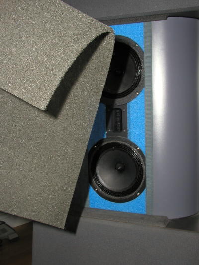

I'm using Velcro to hold my grills. I usually don't use grills at all, but found out that a simple solution to grills is a window based airconditioner filter, which attaches to the speakers with Velcro. Basically, the same idea that Wilson incorporates in their speakers. The filter material is also pretty transparent and only some of the highest frequencies are "filtered" 😉
...which to my ears usually isn't a bad thing. 😉
