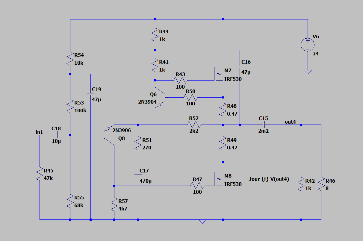

You have to sum the upper and lower currents, not just the upper as done here. The sum of the two currents should be a constant for a class-A amp. This is a simple class-A amp where the sum of the two currents is constant:That's obvious, but that very difference is also inside the bias contol loop, and thus counteracting the signal ''drive'.
I expected a sort of low pass effect on the bias control to valid your statement (aka somesort of servo), but's not present.
That's only true for the dc state, whereas the ac is a modulation upon it. Then the sum is not constant anymore, or there is no current driven into the load.The sum of the two currents should be a constant for a class-A amp.

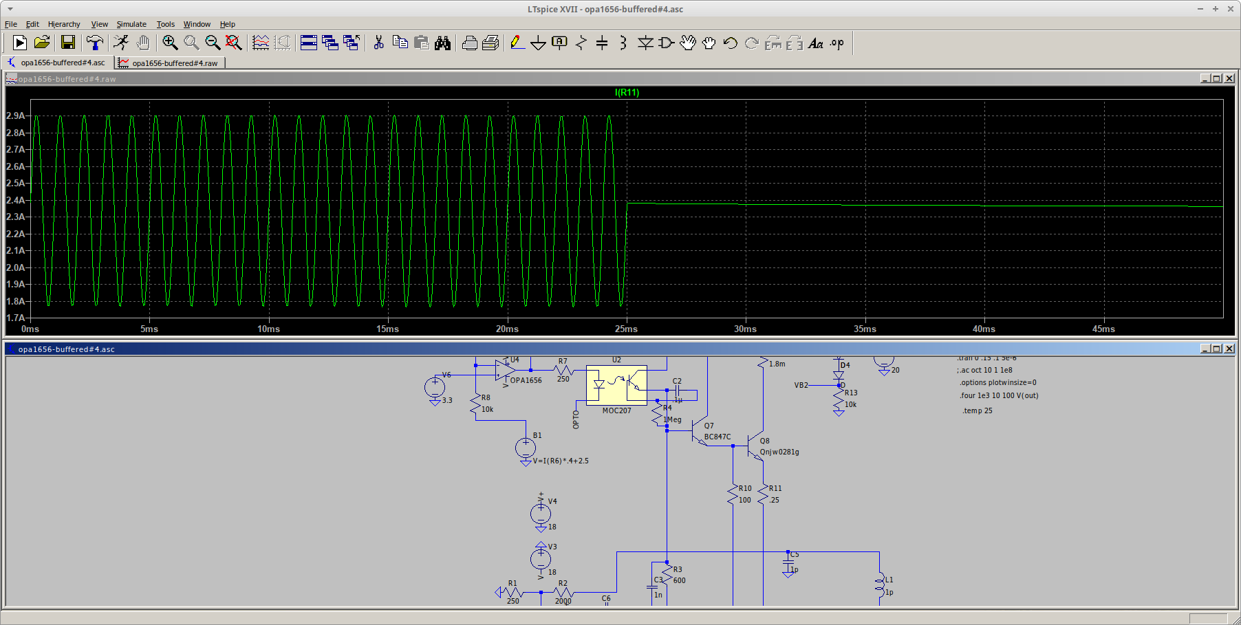

The autobias scheme I am describing here is not affected by the signal delivered to the load, as long as the outputs stay fully in the class A mode. The average sensed current is THE SAME as the idle current. This is in the context of a push-pull class A design.
I have verified this by turning the input signal off and examining the idle current. It just returns to its designed set point once the signal has zero amplitude.
In addition to the requirement of always running in class A, the current sensing circuitry also cannot clip due to the max/min current excursion. This also would cause the idle current control loop's set point to shift. I dumped some of my designs due to this issue.
The latter issue affects the JLH symmetrical headphone amplifier, but it has a reputation of producing very good audio. Perhaps it simply has a "tasty" balance of harmonics?
Another issue the JLH design has, and one I don't like much, is that its autobias scheme produces a pretty substantial spike in idle current at turn-on, because the capacitors in the IC feedback loop have to charge up before the autobias circuitry begins to work -- and in the meantime, the output transistors are pretty much ON full-bore. I know this because I built one and observed the current spike, and simulations confirmed the cause. I mentioned that kind of problem earlier in this thread.

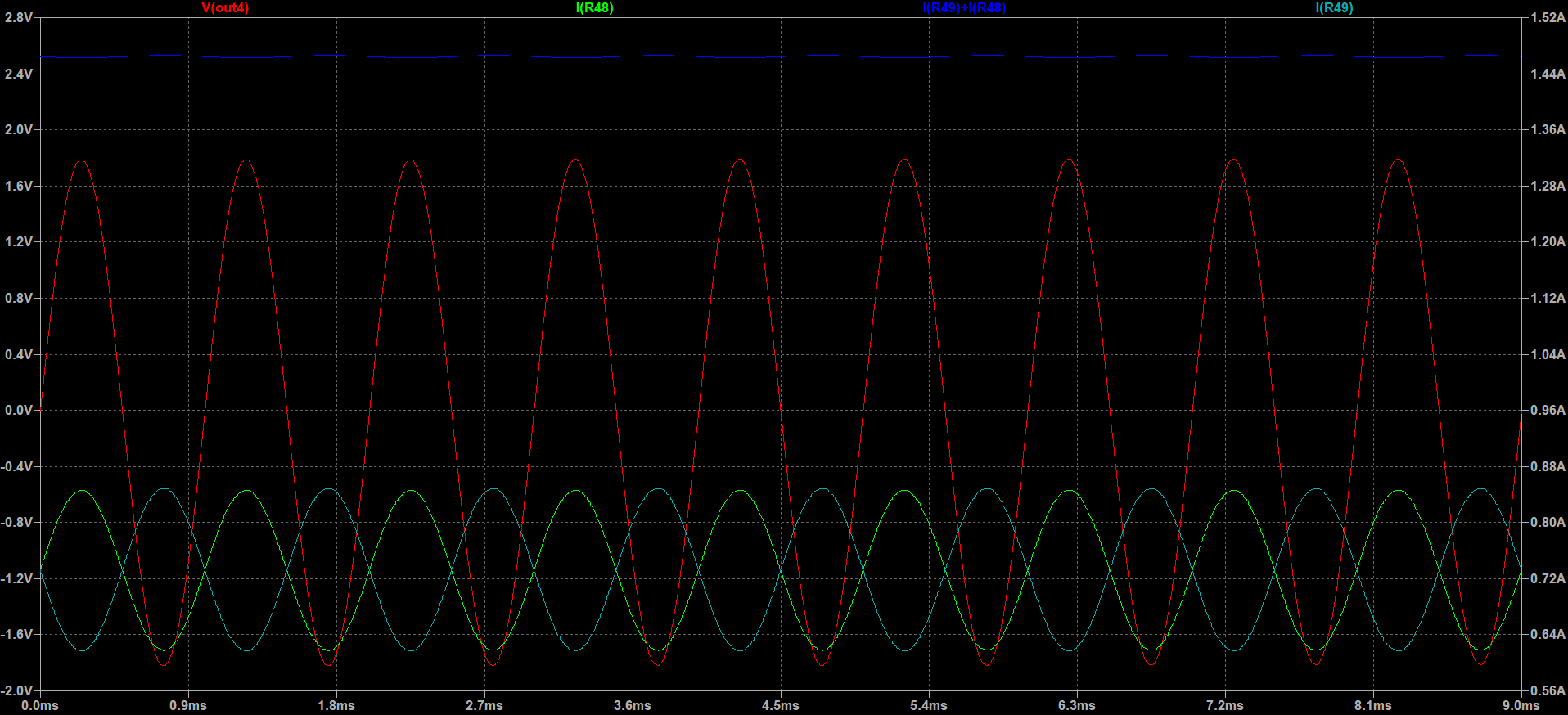

Here's a simulation showing the current flowing in R11, one of the .25 ohm output resistors. Output data for plotting started at 100mS so the autobias circuit had pretty much settled down to its stable operating point. In this simulation the IC control loop's LPF capacitor is in the feedback leg of the opamp, which also helps to reduce the likelihood that the idle-current control signal will clip.

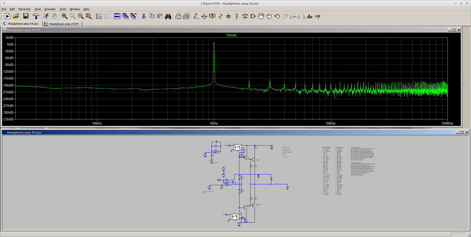

Here's a version that has been altered to make it suitable for a headphone amplifier (but it does drive an 8 ohm load OK). The idle current is about 1 amp.
The optoisolators are wired a bit differently, more like the way I'd want in a real-world design. The input resistors to the LEDs are different, to account for small differences between the + and - halves of the amplifier.
Harmonic distortion results this good should be taken with a very large grain of salt. I used a maximum stepsize of 1us to generate the FFT.
It doesn't look too bad for an amp that uses one opamp and 4 transistors in the signal path. It doesn't hurt that the opamp is well-suited for this kind of application.

The performance @10KHz is similar in terms of THD.
