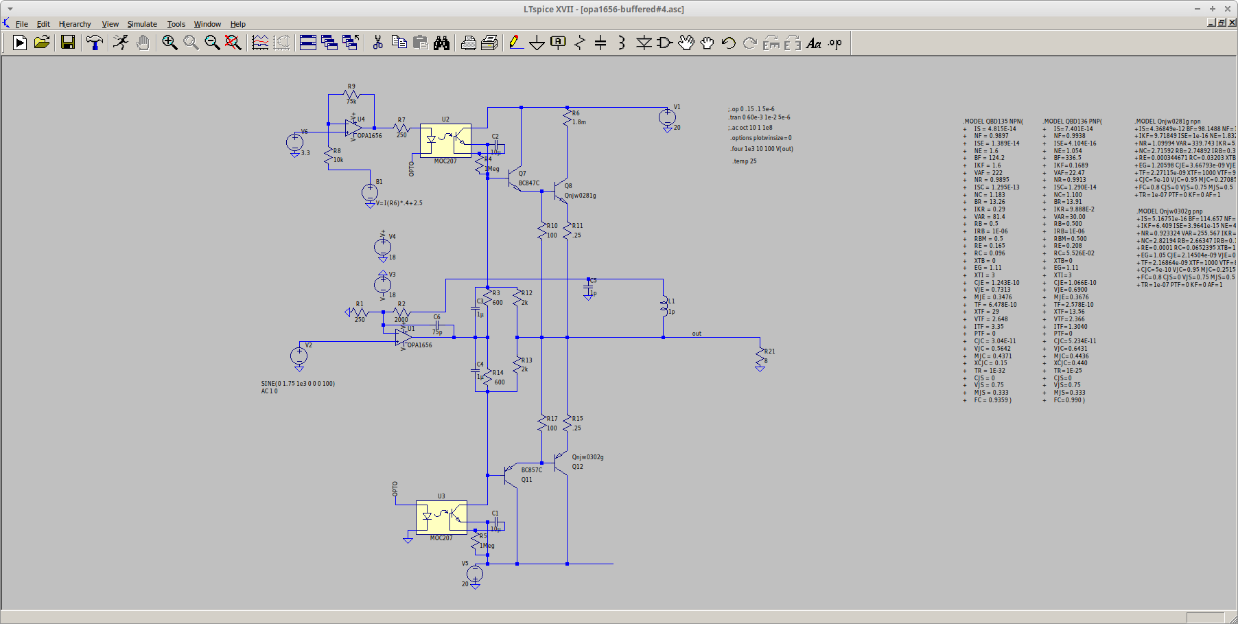

Inspired by this finding, I put together a class A amplifier circuit, using two of these guys to set the idle currents for the positive and negative halves. Here's the top portion:

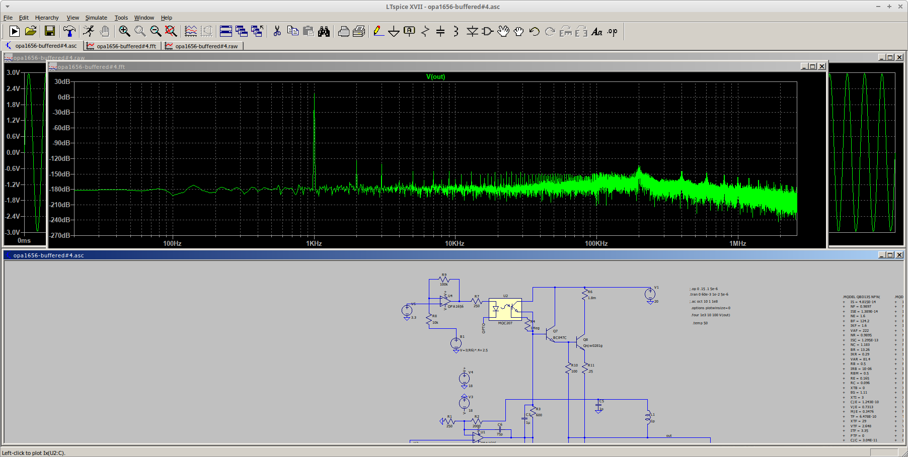

This particular implementation produces 2 amps of idle current. With the transistors as shown + the OPA1656 this circuit's THD is fairly low driving an 8 ohm load (1KHz/2.8WRMS = ~.002%). Changing the overall temperature from 25C to 50C changes the idle current by 5% -- 2 amps to 2.1 amps.
The spice model isn't good for performing transient analysis, it imposes a huge processing overhead. So for transient analysis I devised a behavioral model using a 1.8 milliohm resistor and a "BV" voltage generator. A comparison, also done using LTspice, showed a very good match between 25C and 50C. The behavioral model sims much faster.

Here's a study circuit I'm experimenting with. This approach produces a 10mA shift in idle current between 25 and 50C (only Q1 was swept over temperature). It also permits the output to swing much closer to the rails.
Sims don't want to converge unless I provide an initial condition on the capacitor C1 that's close to the final operating point. This was problematic when doing the temperature sweep so I just snuck up on the 50C operating point. Increasing the loop gain by increasing R6 became more and more difficult so I stopped tweaking things once I got the delta-I down to 10mA.
This study was done assuming that the TMCS1108A4 would be used for sensing the idle current. It outputs 400mV/A. It costs the same as the 50mV/A version I simulated above.
It isn't necessary to use an OPA1656 in this circuit, I just grabbed a model I'm familiar with. A TL071 would work just fine for this.

Here's yet another variation on the theme:
This uses just one current sensor (this particular simulation is using a faster-to-simulate behavioral model). It uses two optoisolators to source the currents that bias-up the output EF's. This version could move the current-control loop's filter capacitor to the opamp side but I chose not to take that approach due to the bootstrapping advantages. Purists might like the fact that it would remove all capacitors from the signal path, though. I'm not counting the 75pF cap needed to keep the circuit from oscillating. It can be an NPO so wouldn't contribute much, if any, coloration to the sound.
I don't think these opto-isolators' transfer ratio is all that tightly specified so a real-world design would drive each opto-iso separately, using a trimmer on one of them so their effective transfer ratios are equal. Going with two current sensors wouldn't eliminate the need for a trimmer so that's a wash.
As in the example shown in post #3, the idle current changes by just 10mA between 25C and 50C. Attempts to further reduce it cause the simulations to time out, likely due to oscillation problems.

Here you go...
This schematic has the additional 10uf caps on the optoisolators. If they're not there the upper optoisolator's current is modulated by the drive voltage, not a desirable thing! BTW the particular optoisolators are spec'd to have a nominal 100% transfer ratio -- 1:1.
@28WRMS this guy's THD sims out to .0015% @ 1KHz. Its -3dB point is a little more than 1MHz.
There's a small "oopsie" in the above schematic. There are two 2K resistors connected between the output and 600 ohm resistors. They are remnants of some troubleshooting I was doing, before I figured out that the optoisolators' current was being modulated by the drive signal. They are not needed.

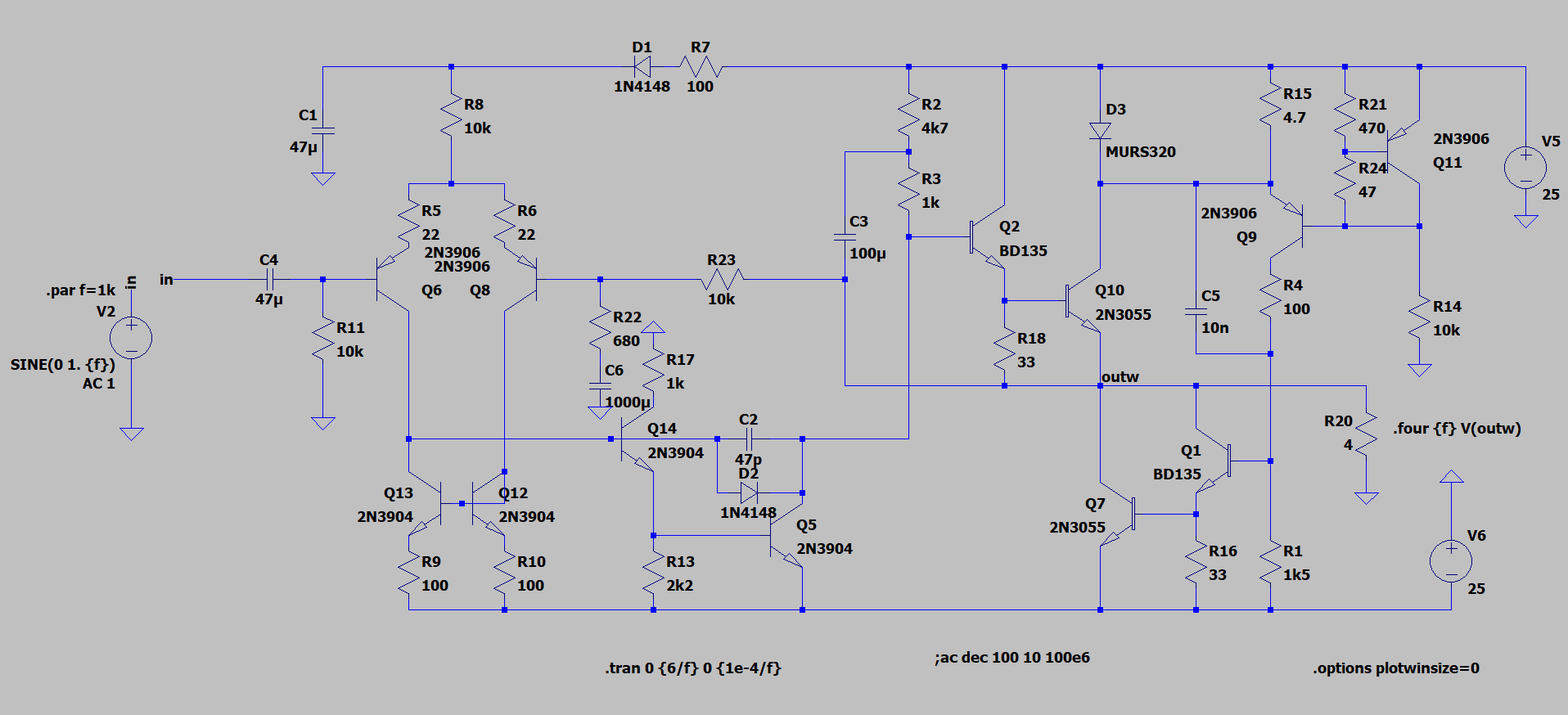

Yes. The bias is going to take some time to recover after a burst of audio. Averaging the OP current over time is not a great plan. The bias needs to react faster than the audio signal. LV has some cool ideas for auto bias including his "tandem" circuit similar to the one I posted, and the base current detection bias. Some time ago there was a DIYA post of a commercial NMOS amp in a receiver that used the R+diode supply sense to servo the OP bias, but I don't remember the details. I've had good results switching the fast drivers and not the OPs.
Also note that newer amps combine R10 and R17 for cross coupling. This improves high frequency shoot-through current by pulling OPs off as well as driving them on. Often a cap between the bases of the OPs is added. It also increases the slew during the cross-over where the OP bases unload the driver.
Even class-D amps have bias issue, aka dead time. An important feature of UCD amps is a resistor that sets the bias/dead-time.
V-fets solves some of these issues, but there is no flawless solution. It's not difficult to get better than 0.01% THD and that's good enough for me. Some prefer about 0.1% deliberate 2nd harmonic, IE "single ended class-A" and JLH.
Reducing the maximum time step to 1e-6 second produced a substantial drop in the calculated THD. for the circuit shown in post #11. It's FAR below what I would expect from an actual implementation. I was troubled by all the higher-order harmonics that were showing up in the FFT's, despite all the screwing around I was doing. So it mostly was simulation "noise".

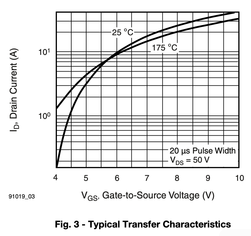

V-fets have a zero or negative thermal co-efficient, so they are not prone to thermal run-away. However, that may not be completely true for some devices.
