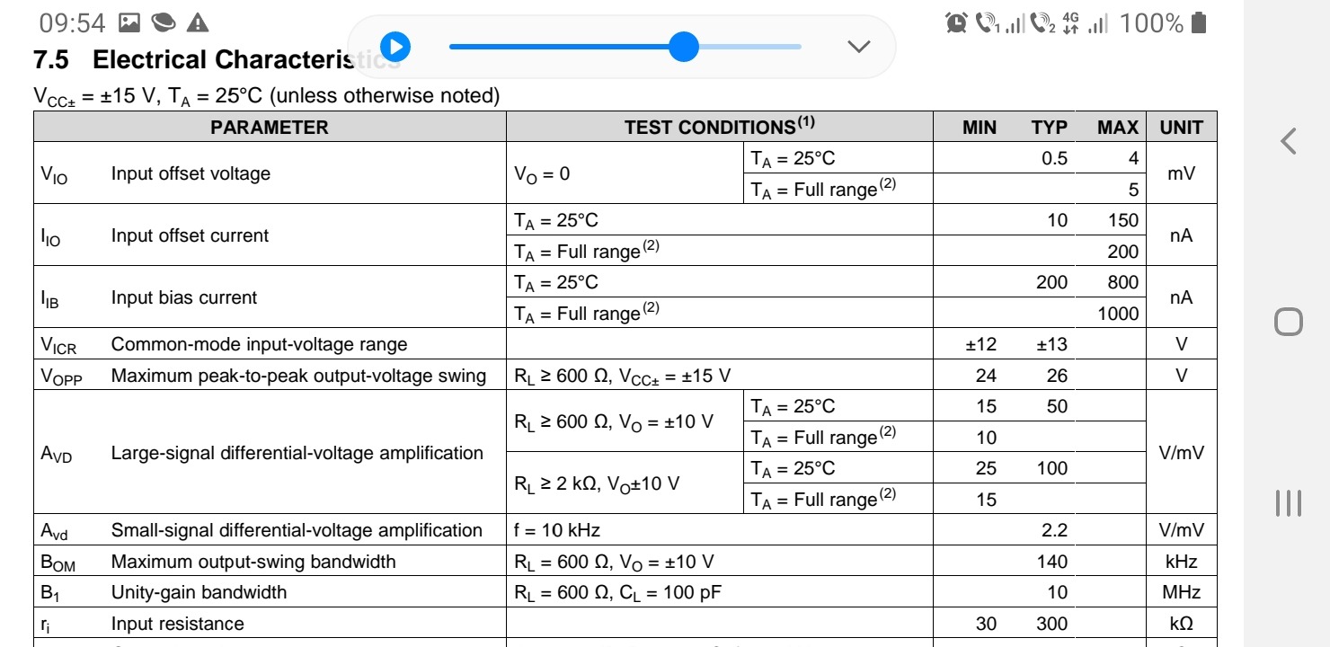

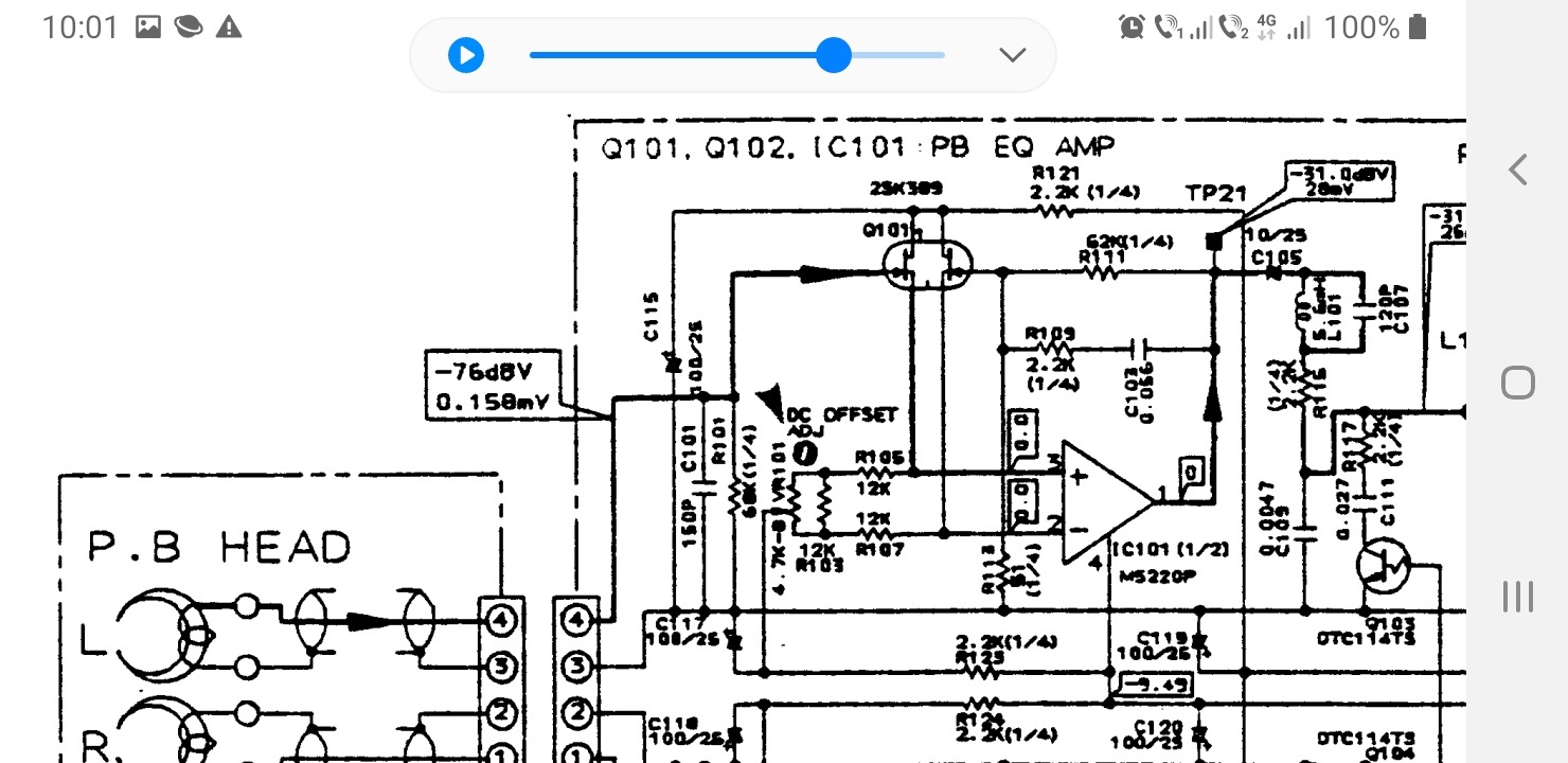

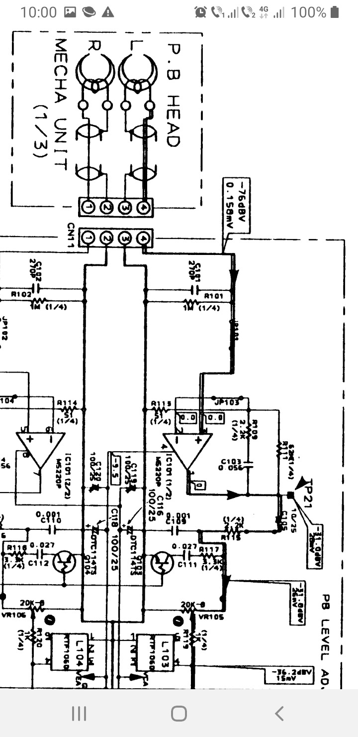

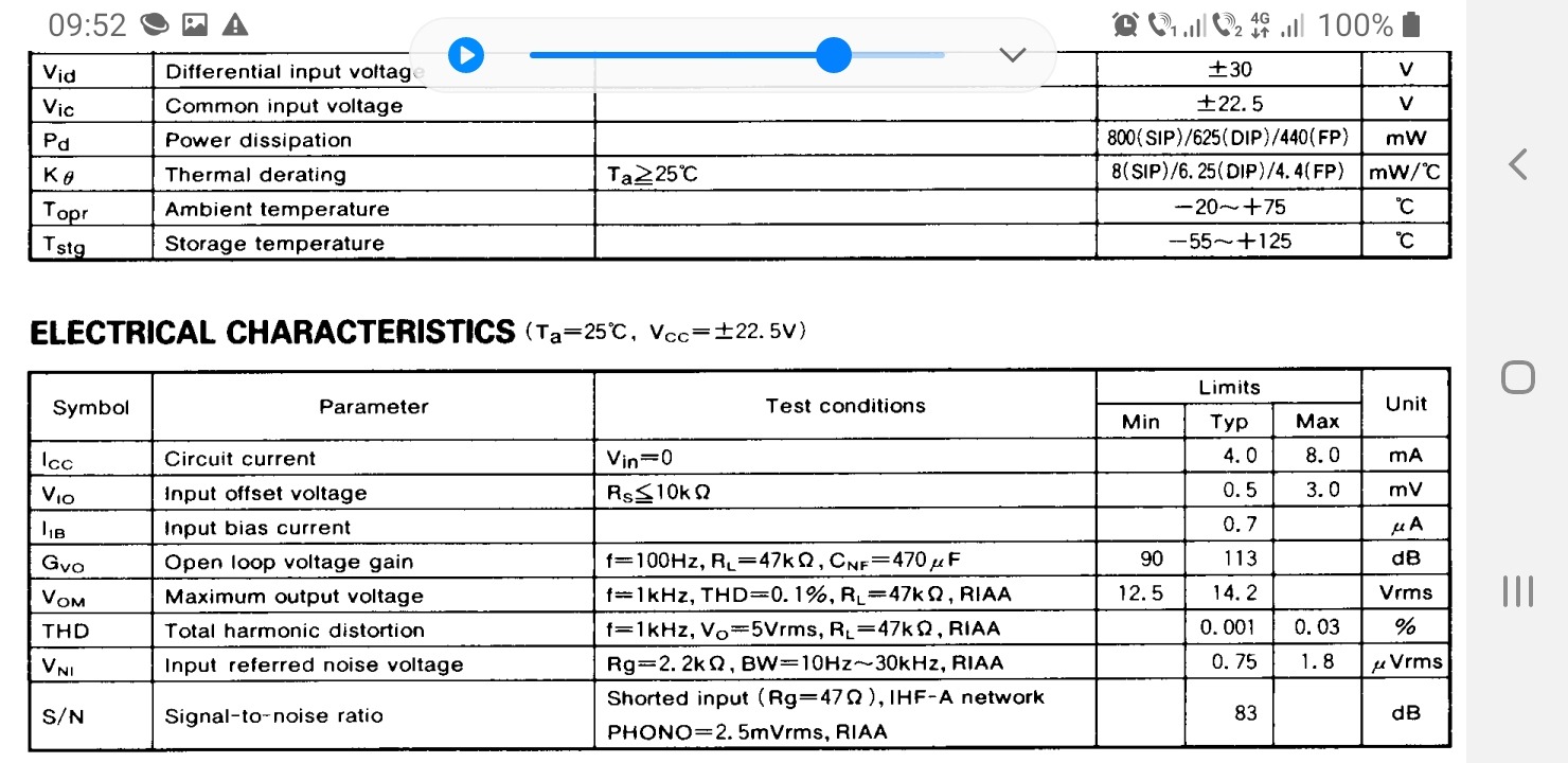

Really? Is ne5532 so bad?...My Pioneers and Sony used m5220 chips for decades without magnetizing anything...and their offset and bias currents aren't very different from ne5532...Pioneer ct 979 and ct777 have identical heads.The difference is in the loading which takes into account the higher resistive loading of bipolar input and the higher capacitance loading in the jfet input , but the output of the heads are the same.Maybe in 40 years of continuous use a head would magnetise from that current, but that tapehead won't last 40 years of continuous use anyway.
The 5532 is good compared to the opamps of its time. Hell it is a still livving legend.
Magnetisation isnt a overtime process. And it usually happens during power up and down because the power supply( both negative and positive) just cannot power up at the same instant time so it sends a large DC current trough the inputs.
The approach on the readably rotated schematic is the correct one. My Fostex G24S uses a very similar approach to it aswell.
The Revox A700 heads have a much higher impedance than any cassette head, so even small current will DC magnetise the heads. Other heads might be less susceptible to this, but overtime excessive noise will develop on the tape as you play it. Hooking an opamp of the NE5532 caliber straight to repro heads is a nono. You can do it with TL072 062 082 or any CMOS/JFET input opamp (like I mentioned OPA1656) but not BJT.
Tl072 is noisier than ne5532 for a cassette tapehead kind of signal and impedance although it doesn't really matter.

If you think hooking the noninverting input of a NE5532 directly to the head is adequate, be my guest, but that has so much wrong with it.
The TL071 has a higher noise figure, all thogh inexoerience its still lower than that of a CrO2 cassette by some miracle. I never had a chance to test metal cassettes because I dont have the money to buy such overpriced media.
The best solution is to have the head feeding a Jfet like the 2SK170(modern day equivalently great would be JFE150) set it for 10x gain and then use a NE5532 / 5534 to do the rest of the ampliffication and EQ. This is the approach most if nit almost every manufacturer went that wanted opamps in the front.
The Fostex G24S I own has this exact approach, with a not so great opamp. And the discrete head preamps unless it isnt quite complex will not outperform the opamp solution. And when the discrete complicated circuit does outperform the opamp Jfet solution, its at 10x the price of the easy solution.
Today we have opamps much better fit for positions like that of a head preamplifier.
OPA1656 is just one of them that is also budget friendly. The JFE150 Jfets are also budget friendly, and you can make a composite amplifier with a Jfet and an opamp of any sort givving you the most freedom.
