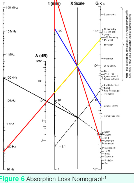

I have been digging around in the archives looking for some information on magnetic shielding with non ferrous materials. I saw varying opinions about its effectiveness. Looking for info on the internets in general I came across this paper
http://www.chomerics.com/products/documents/emicat/pg192theory_of_emi.pdf
Reading through it seems that aluminum can be an effective magnetic shield if it is thick enough. Playing around with the nomographs at the end it looks to me like .25” of aluminum is about as absorptive as .009” of Mu Metal (about 6dB of absorption losses at 60 Hz) the reflection losses look to be about 20 dB but I gather these are to be ignored if you are only worried about the magnetic portion of the wave.
Does anyone have practical experience or a better grasp of the math that confirms what I think I see?

No grasp of the math, but I can confirm that thick aluminum does provide some shielding. I've used a piece between the power transformer and output transformer in tube projects. Noticeable reduction in mains hum. In my case, thickness was about 8mm. As good as 5mm mild steel.

Aluminum will not provide magnetic shielding, since it's permeability is one; the same as air.
Well if I am following the paper I linked to it seems that it will just not as well as ferrous metals for a given thickness.
I have read others who say it will not work at all but I always had this nagging question. If highly conductive metals have no effect on a magnetic circuit why are they used as shorting rings in loudspeakers?

Your personal experience would be correct. I did a google and found out that there is such a thing as lossy magnetic shielding.
Magnetic Shielding Solutions
"Lossy magnetic shielding depends on the eddy-current losses that occur within highly conductive materials (i.e., copper, aluminum, iron, steel, silicon-iron, etc.). When a conductive material is subjected to a time-varying (60 hertz) magnetic field, currents are induced within the material that flow in closed circular paths - perpendicular to the inducing field. According to Lenz's Law, these eddy-currents oppose the changes in the inducing field, so the magnetic fields produced by the circulating eddy- currents attempt to cancel the larger external inducing magnetic fields near the conductive surface, thereby generating a shielding effect."
I read somewhere else on the bottlehead forum that this was only about 5-6dB maximum (according to John Swenson)
http://www.bottlehead.com/smf/index.php/topic,70.msg290.html#msg290
Nothing close to mu-metals but it still works a little.
I had to extend the thickness scale to get to ¼” so this may not be super accurate but a couple of things I take away from this
Aluminum works to absorb magnetic fields. 250 mils of aluminum is as effective as 6 mils of mu metal or about 100 mils of stainless all roughly equal 6dB of attenuation at 60 Hz. I didn’t see anything in the text that would lead me to believe multiple shields would have any unexpected effect with low impedance low frequency fields so stacking spaced plates should not be a problem.
Thanks for all of the replies, I am working on a layout for some sensitive tubes and output transformers and would rather keep the whole project on one chassis. I have plenty of aluminum and all of the equipment I need to fabricate so it seems like the easy way out for me. As it stands I have about 7” between the power transformer and the outputs with both being shielded ¼” aluminum cans. I have enough space for a couple of plates between the shields if required so hopefully that will work well enough.

This absolutely does work and I've used aluminum plate for shielding very high gain amps in scientific equipment. In some cases it can be way more effective than mu-metal. The problem is you need a lot of thickness for it to be effective. 1/2 to 5/8 inch thick plate works well. 1/4 inch is pretty much useless. Your circuit needs everything else done correctly- grounding for example, but if there's some residual level of magnetic hum from transformer fields, this can eliminate it.

What hasn't been mentioned in this thread is electromagnetic vs. magnetic shielding. DC magnetic shielding is what you want around your scope CRT so the electron beam flies straight. Electromagnetic shielding is what you want to keep nearby radio stations out of your amp.
At 60Hz and below, mild steel and mu-metal are orders of magnitude better than aluminum, as has been mentioned. If shielding is paramount, do the right thing and buy strips of permalloy, like those from Goldmine, and line your ordinary aluminum chassis with it. There is no need to use absurd thicknesses of aluminum except to demonstrate one's Freudian insufficiencies. 0.060" aluminum is plenty, easy to work, stiff enough to support transformers, and fairly priced.
At audio frequencies and up, aluminum and copper are better, because the field induces surface currents, reflecting rather than transmitting it. Aluminum is the metal of choice for my induction heater,

IMO, to accomplish anything significant with iron, tin cans or mu-metal, you have to close the loop- create a full ring or better yet, a box. Just putting flat shielding between the transformer and whatever's picking up the magnetic field, does almost nothing. Using thick aluminum should be reserved for special cases when everything else has already been done and is insufficient. It helped me get the last vestiges of hum out of some extremely high conversion gain current to voltage converters in an atomic force microscope, but you can be sure there are no aluminum boat anchors in my MM phono preamp. I might consider it for MC but even there conventional techniques should work. The cheapest solution is distance.
