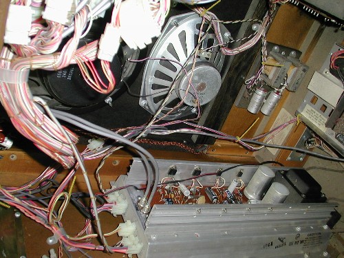

I just began looking into an electronic organ that I am salvaging and I found what looks like some really nice speakers. Since the organ has an open back (with grill cloth) I suppose there is no hope that the speakers would be useful for a horn sub but they do appear to be of fairly modern design with large magnet structures. The 12" would probably be good for an IB sub and the 10" and 6x9" could be used in a utility amp for my Korg Poly-six (once I finish repairing the NiCad leak 🙂 ). There is even a Leslie in there that I could probably find some use for.
As a bonus there is a good sized two channel power amp in there. There is a lot of noise when the unit is powered on so the amp may need some repair but even if I can't repair it that big long heatsink will make a nice platform for a new amp.
Later I will go write down the numbers on the drivers and see if anyone has any information on their specifications.

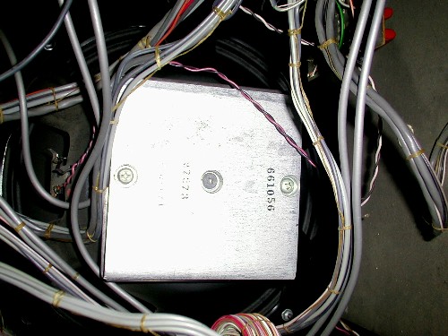

The big speaker: Looks like 12".

Thanks Planet10. The donor organ is a Wurlitzer Centura Professional (full console 24 note pedal board) with Orbit III synth.
Each driver has three numbers printed on the magnet. The numbers as best I can read them in the dark garage are as follows.
Largest driver (I can't quite tell if it is a 12" or 15" until I get it out):
661056, 27273, 2207421
10" driver:
668459, 24651, 2857420
Oval driver:
651805, 21739, 2857407
Leslie driver:

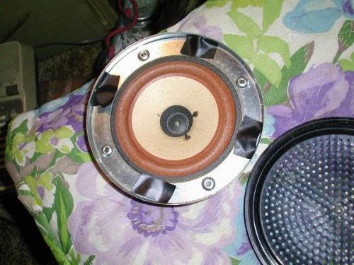

  1. Two Radio Shack 12-1708 5.25" triax with heavy magnets
  2. Two Radio Shack 12-1848 5.25" Whizzer with heavy magnet

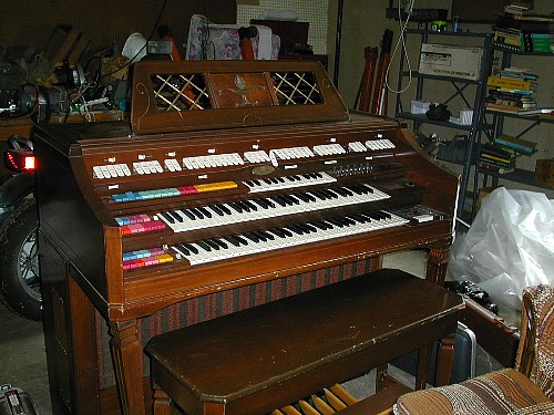

    The Donor Organ:
Re: Here are the numbers
Leslie driver:
made by Jensen in 1974
10" driver:
Oval driver:
made by Rola in 1974
[*]Two Radio Shack 12-1848 5.25" Whizzer with heavy magnet
brownish/yellow cone & a cyclops eye in the centre of the dome?

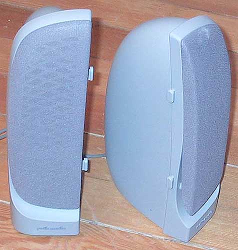

[*]And finally two cheapo Polk computer speakers.
Are these the ones ranked among the worst computer speakers ever? I have a set of those downstairs.
dave]
