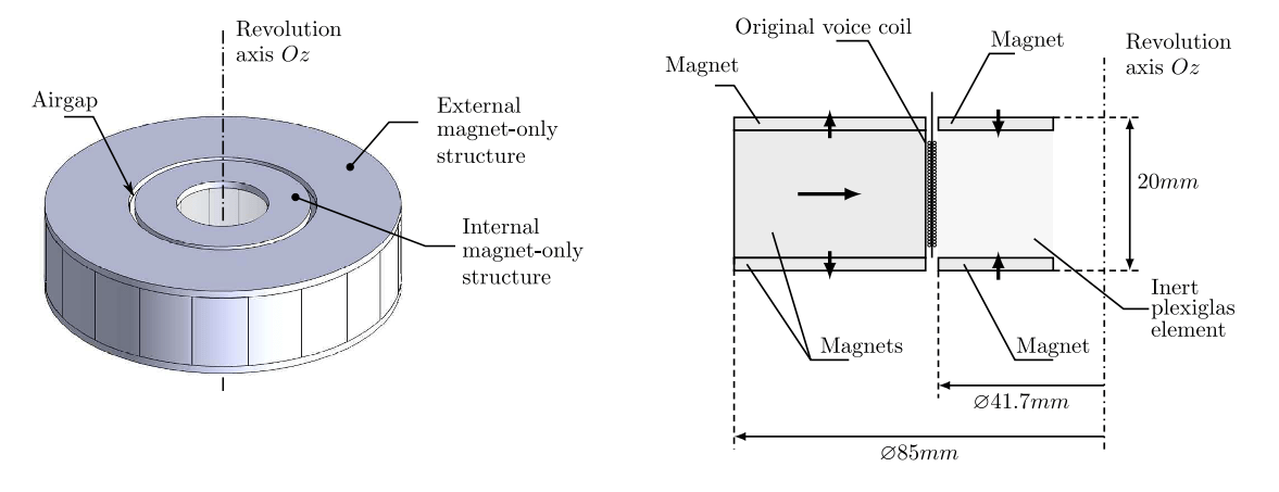

What I understand is that -basically- the iron centre piece of original the magnet assembly has been replaced by two ring-magnets and a plexiglass piece to hold it all in place. Also, the overhung VC has been replaced by an underhung VC. To my best of knowledge, the Purify motors also have a centrally placed magnet instead of an the classic all iron centre piece.

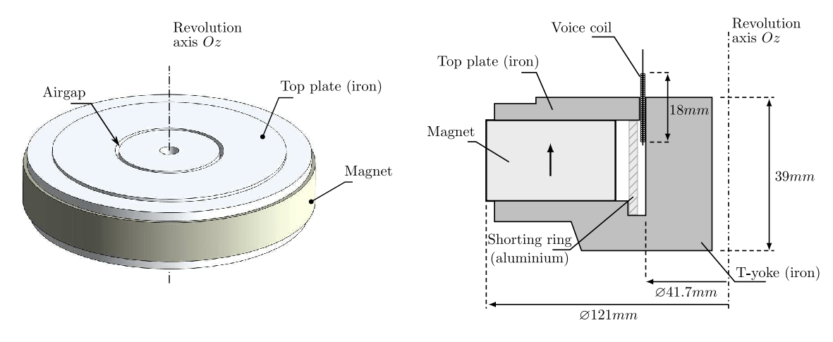

Original circuit vs "no-iron" circuit:
No, everything remained the same save for the magnetic circuit; no-iron magnet assembly was designed in such a way that original coil of 18 mm height became underhang. Thus VC had more area to collect much more sparse magnetic field and Bl (=sensitivity) remained the same, albeit with much smaller (1.5 vs ~6 mm) Xmax.the overhung VC has been replaced by an underhung VC
You are reading the paper wrong (well, too small illustrations doesn't help). They don't fill the space around the coil at all - from magnetic point of view, it is suspended in thin air, so nonlinearities from magnet material (NdFeB discs in this case) are irrelevant. Merit & Novak threw away any "canalization" attempt.BUT fill that space with some more magnet material

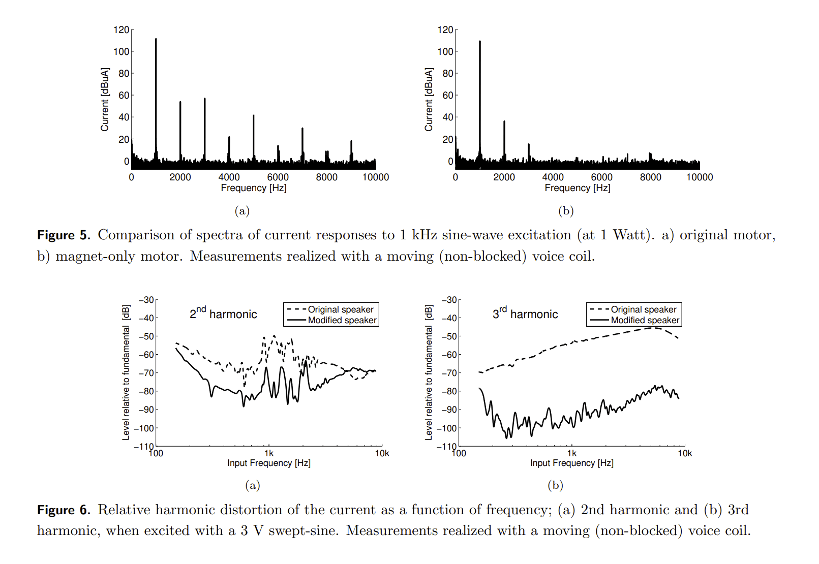

Distortion elimination. There is no high order distortions left, 2nd order is reduced by 10 to 20 dB, 3rd by 40 dB. Without any complex arrangements, half a kilo of copper in the motor or peculiar VC winding they produced possibly the most linear motor I have ever seen.I don't see the overall advantage to their plan

Air gap contains DC magnetic field from permanent magnet an AC magnetic field generated by the voice coil (i.e. AC field modulates DC field). The Voice coil with a metal core (a pole piece) behaves as nonlinear inductor whose inductance depends on both the voice coil current and the voice coil coordinate (i.e. Le(I,x) ).
Going a little bit deeper into physics, dependence of the magnetic polarisation J of the metal core on external field H is essentialy nonlinear process in the simplest case described in the frame of phenomenological Mean Field Theory, particularly using hyperbolic Langevin function for J(H) dependence. For this reason, the voice coil inductance also will be nonlinear and responsible for nonlinear distortion production in the mid frequency range. (because the J(H) dependence is described by hyperbolic Langevin function, which is odd function, the use of the metal core will cause nonlinear Le dependence on the current in the voice coil and results in the rise of odd order harmonics in the mid range. Moreover, additional source of the second order distortion is dependence of inductance Le on the voice coil coordinate).
In sum, the use of metal core led to an increase of odd and even order distortion in the mid range, the reduction of which is not an easy task. So, the magnet-only ironless construction looks quite reasonable.
