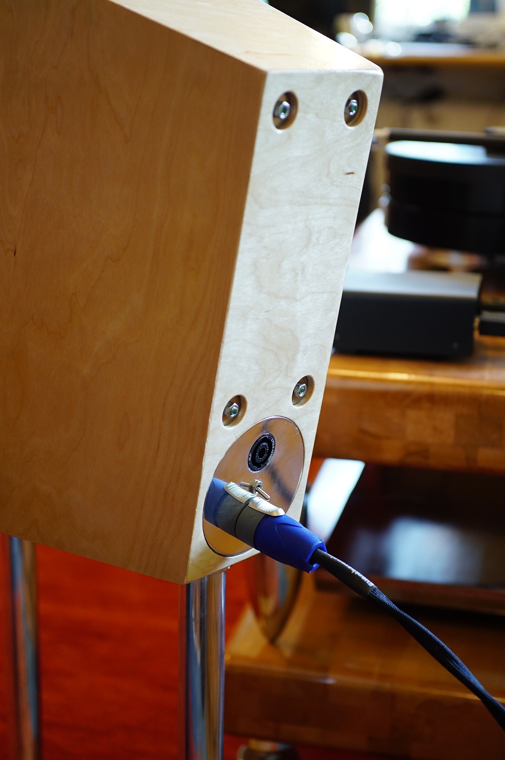

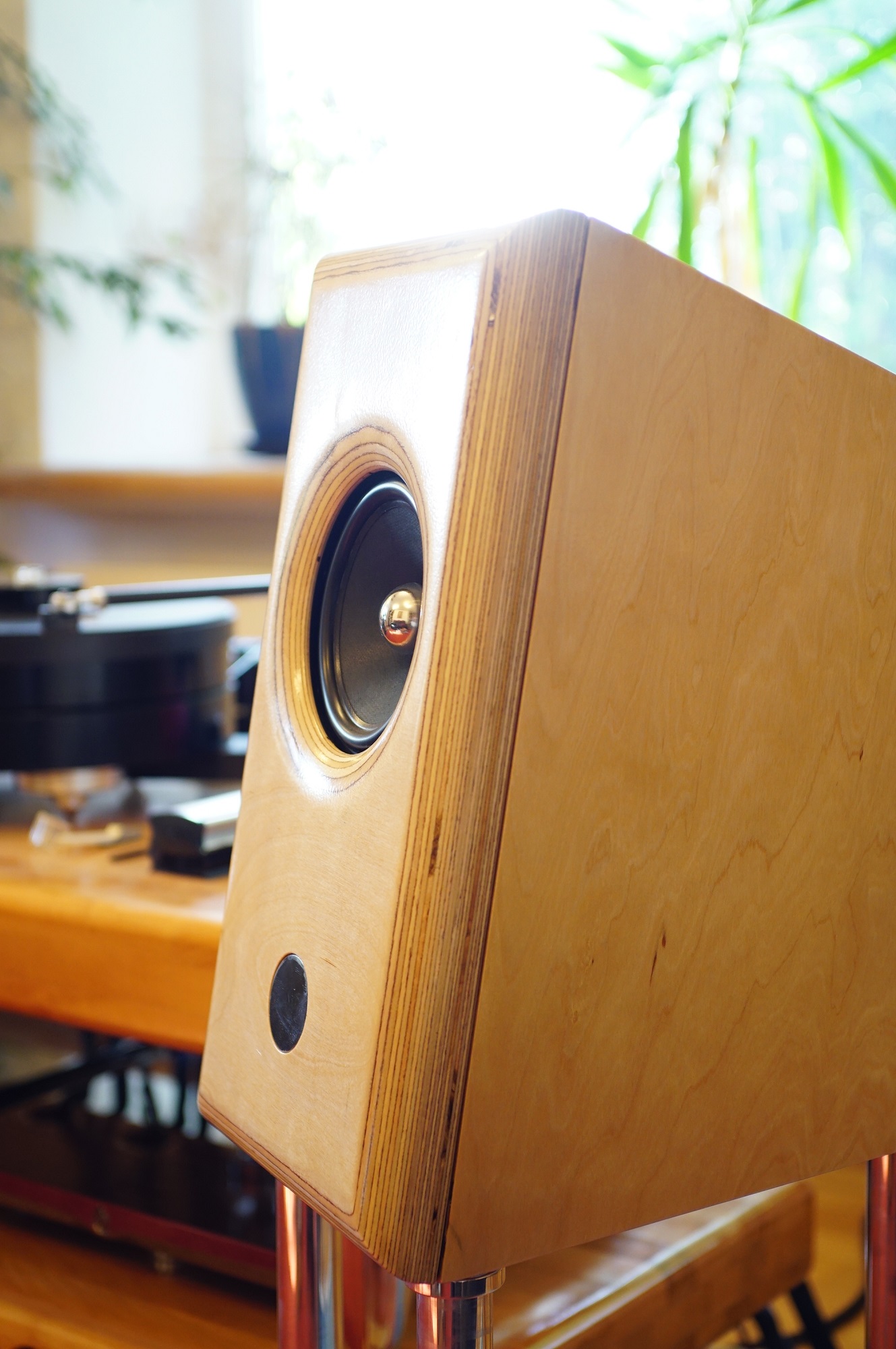

Hi Milus,
Whenever possible, I use magnet mounting with drivers, only softly coupling the driver to the front baffle. Although I haven´t done it with Satori drivers, I could imagine 2 possible ways to to it:
1. Glue several ring segments made of wood to the back of the magnet, allowing to screw down the magnet from behind. Segmented because you must be very careful not to block the rear vent.
2. Clamp the driver between front baffle and an internal brace, again careful not to block the vent. That means that you´ll "mount" it to the baffle from behind. This requires quite some efforts to avoid additional diffraction, but that´s worth it. You could also mount/fix the front baffle from the back and decouple same from the enclosure.
Some photos might hopefully explain a little more.
All the best
Mattes

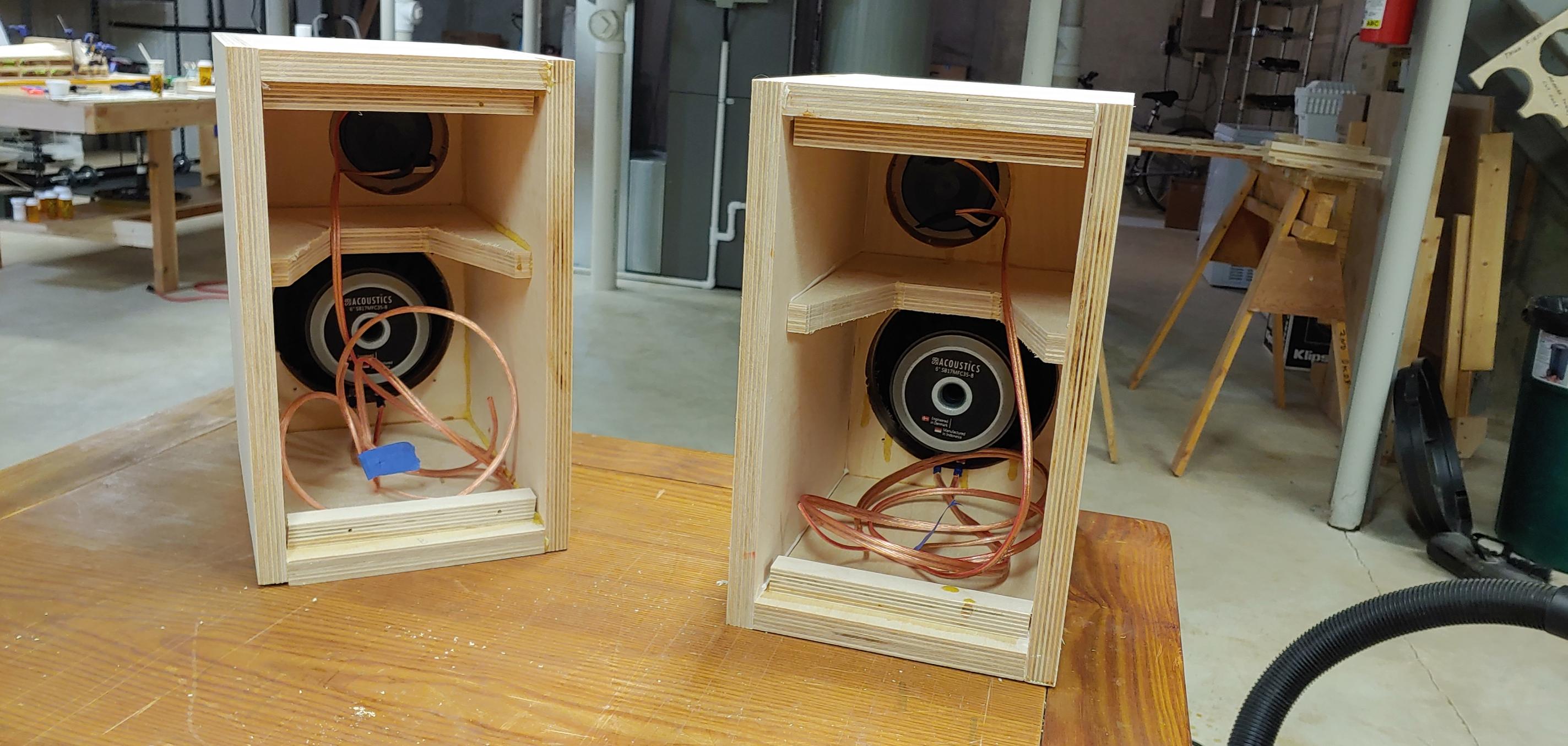

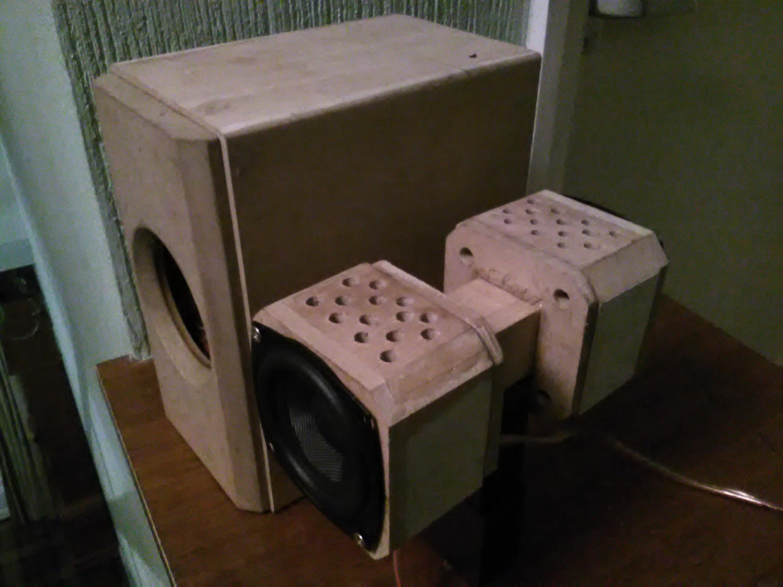

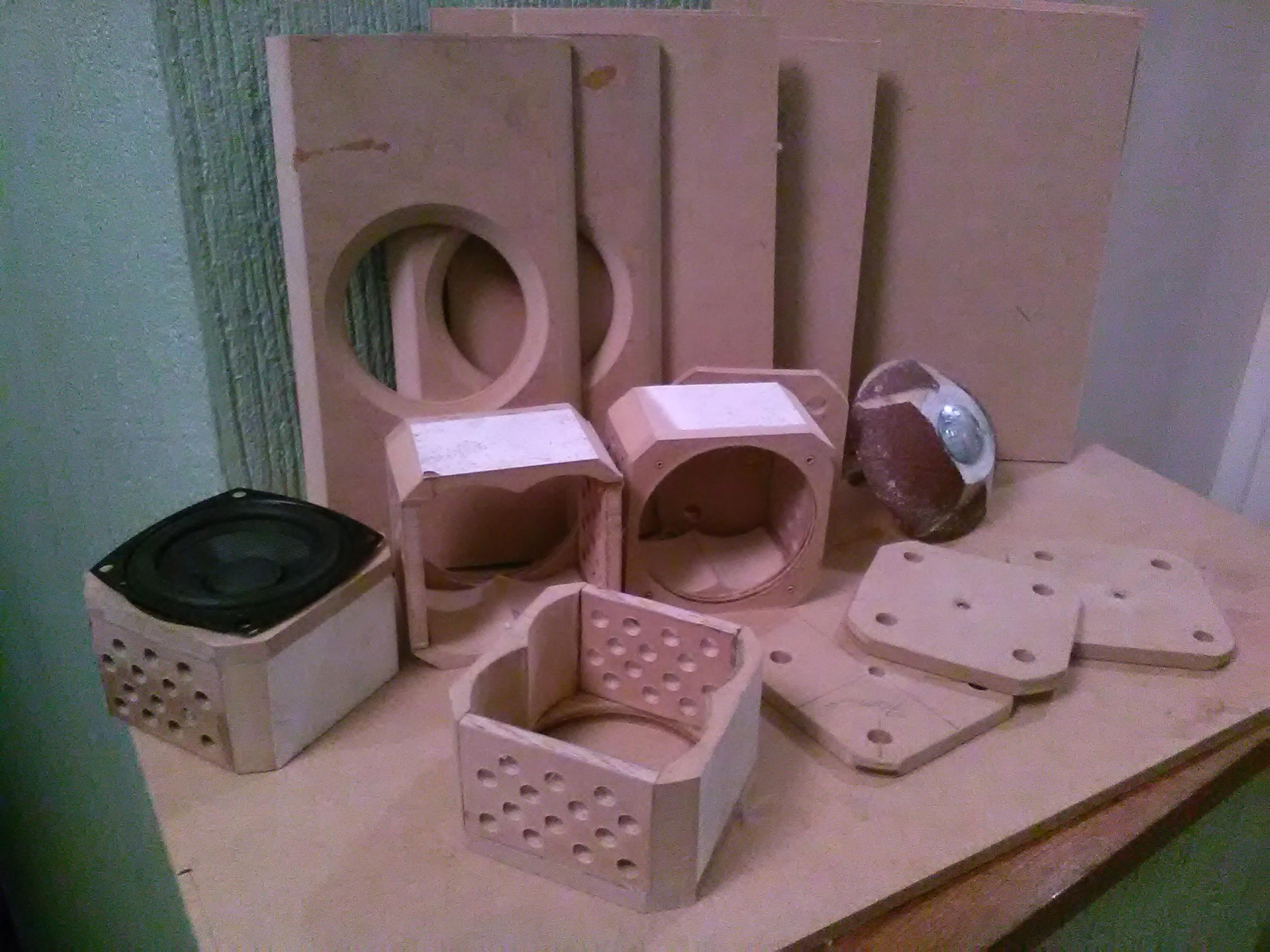

Another way to isolate the driver vibrations from the main cabinet, is to have the mid in it's own separate enclosure, inside the main cabinet and mechanically isolated ( with soft foam or felt ) from it, this should also stop the sound inside the mid box transmitting through the walls of the main cabinet. I've done this a few times, the pictures are of the latest ( and smallest ) examples that I've made using this idea, on these particular speakers the full range drivers are mounted back to back to try to cancel out the forces. I've previously used the same idea ( box within a box ) for mid/bass drivers. The main problem is you need a hole ( and cover ) to get the box inside.
