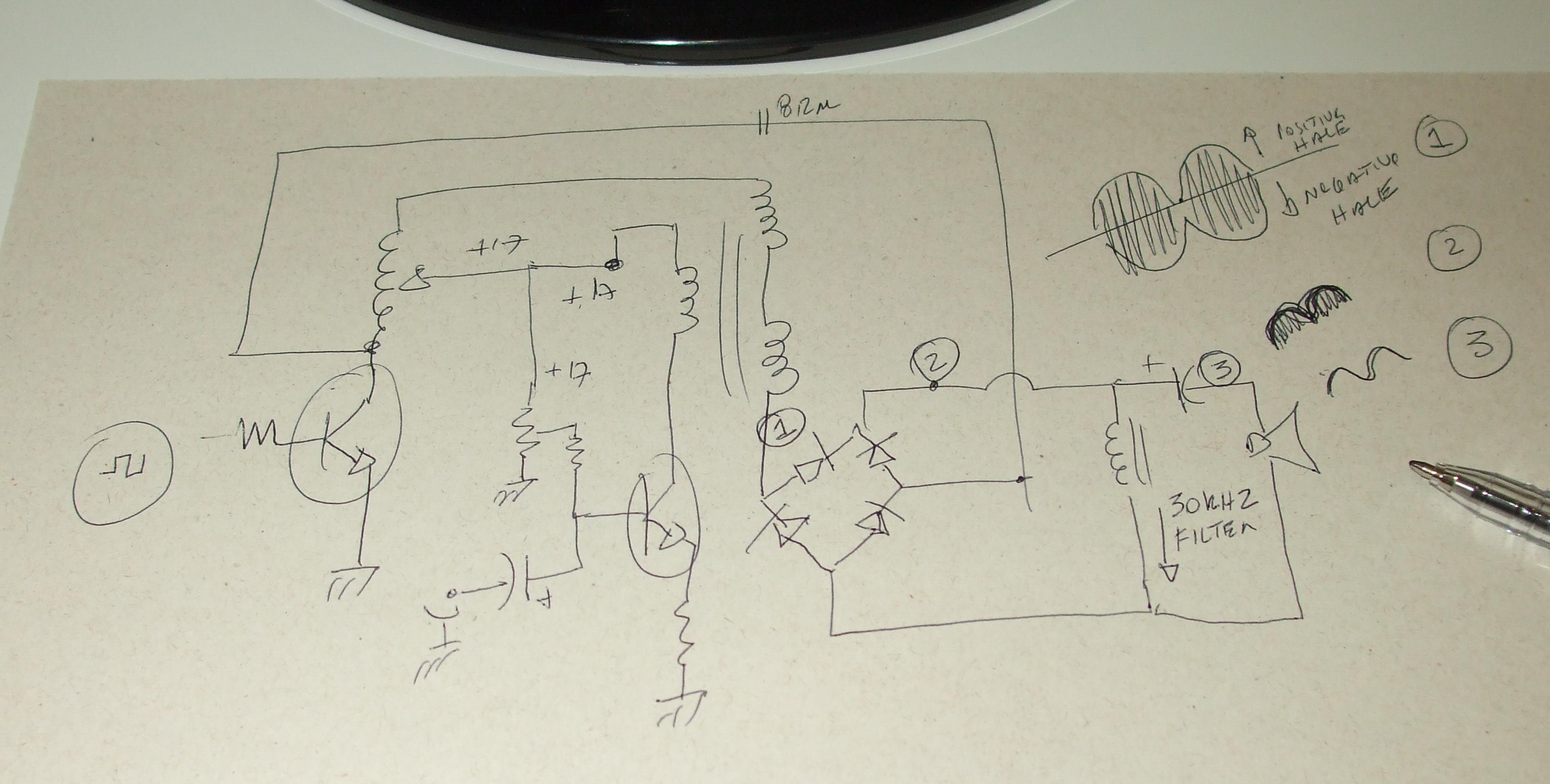

AcousticPlans Magamp was demontrated at the HighEnd im Munich. This is a slightly modified/improved Lundahl magamp. Under the circumstances given it sounded nice. If you consider that most of the sound produced at the HighEnd was lousy the performance was quite all right. So it does work.
I have an idea Temuk.... watch my schematic..it is the same schematic
drawn different.... seems to me a modulation process...anything complicated there...if you are not an engineer and do not want formulas or description of saturation process, i can explain you almost 95% of how this works.
I can understand the same way people understand electron and nobody could see electron..we know how electrons works... also i know how this works.
Modulation and demodulation is what you have.... there's 1,2,3 numbers pointing positions where you have these signals (more or less this way)....at rigth the signals....1 is modulated, 2 is rectified and 3 is the audio signal after filtering..an filtering here is the 30 kilohertz carrier drained to ground througth the choque, the inductor that took a sophisticated name of saturated core and so on.
First stage, the one receive the square wave pilot signal, is a not perfectly tuned 30 kilohertz amplifier that will be modulated by the audio transistor.
I think you already understood...if not..send me an email and then i will have your personnal email adress.... this way i will be able, tomorrow (more 8 hours) to send you an audio file (MP3) and some sketches, explaining how this works.
carlos.eugenio1951@yahoo.com
Radio amateurs...all them..will understand this very fast...if you have one in your surroundings, talk with him in your own language and he will exterminate all this mistery, and very fast.
I suppose, watching my simplified and non tricky schematic, you will already understand..the mistery is the way was drawn.

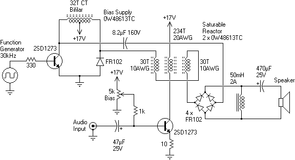

The problem is with the choke across the output of the bridge rectifier. You do have to rectify the modulated HF at the output to retrieve the audio, but that gives a high level of DC along with the audio.It does clip easily though.
Unfortunately you can't get rid of the DC by just shorting it with a choke. Doing it properly requires some extra complexity, as with the Lundahl amp.
btw: The key to the Lundahl amp is that the cores go in and out of saturation at HF, but the "depth" of saturation of the various cores depends on the audio signal.
I like that it works with a HF square wave. That means the HF generator can be rugged and high efficiency. If core losses are also small, then a mag-amp should be able to reach overall efficiency similar to class D amps.
I know a choke across a bridge will simply short out the negative-going phase. But this does not explain how I was getting any signal at all.
Turns out, the particular choke I was using was quite resistive, and had about 20V across it under best operating conditions!
I replaced it with a 10 ohm wirewound resistor (optionally in series with a much lower resistance 50mH choke), which allowed more power output.
The heavier load necessitated some changes:
Instead of connecting the reactor across the ends of the AC bias transformer, only half was used (i.e., 2SD1273 collector and the CT).
Since current was getting quite large, I switched from 2SD1273 to a 50N06 MOSFET; I also added an RCD snubber to protect it from voltage spikes. (The spikes got so large (~70V, with currents up to 5-10A for pulses of maybe 1us), I blew up two electrolytic capacitors trying to contain it. I ended up with an 8.2uF film cap, which served admirably.) These changes are shown here:
I also found some peculiar results.
While a square wave is convienient, if its harmonic content changes, the sound changes. For instance, while operating at less than 50% duty cycle, the bias supply creates a square "bottom" (while the MOSFET is turned on), followed by a fairly square peak (the opposing FR102 conducting), followed by dead time with ringing. Well, the amount of ringing present depends on the load, which is dynamic. In fact, it seems to feed back in a very nonlinear fashion, resulting in apparently repeating traces: for instance, under some conditions, every other cycle might have an alternating magnetization, causing the ringing to be faster on one cycle and slower on the next. On the 'scope, you see the illusion of two ringdowns during this period (or you see them seperately if you adjust holdoff to stabilize the image). Under other conditions, 3 or more different ringdowns may be visible. Indeed, the number of combinations seems to increase exponentially, so that most of the range, a random ringdown seems to be picked -- generating mild white noise as a result. A clear example of a chaotic system, with all that classical bifurcation and indeterminate evolution stuff!
I also tried a self-biased reactor, by replacing the bridge rectifier with a single diode (I used a spare MUR2020). This had acceptable results, with the main difference being peculiar nonlinearities (while varying bias, there seem to be multiple regions of minor linearity, seperated by fairly distorted regions -- the transfer curve must be pretty kinky).
I also observed hysteretic behavior, where the self-biased output kept itself magnetized, but only for sufficiently high bias currents. While in this state, a much lower value of control bias was necessary to restore the "normal" operating point, illustrating hysteresis.
