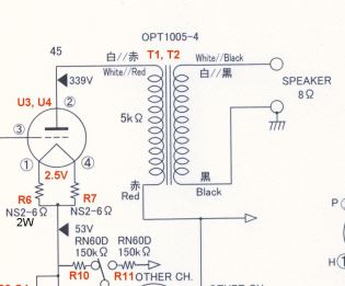

Will it worked in this application? I'm in Laval... It says 'No DC' so I'm guessing not since the 5K primary is in serie with the HV supply in this application...
SB
On your circuit the parafeed output transformer primary would be connected through a capacitor either between plate and "white/red" connection or from "red" to ground.
The B+ series plate load component can be inductor, ccs, or even resistor and with the EXO-045 (in series with the parafeed capacitor). The plate choke is the usual way and handy as it can swing above B+, but within power limitations CCS can work and a friend tells me that you get the best sound with resistor. : )
