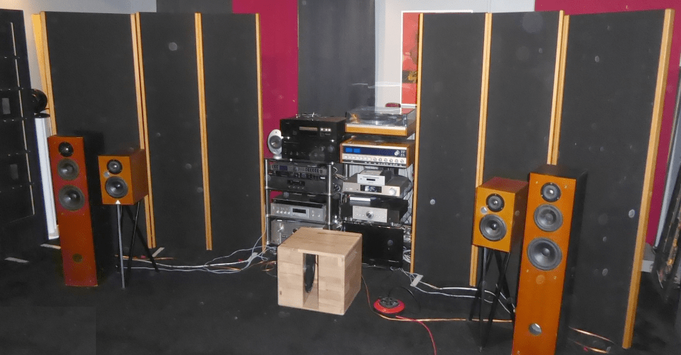

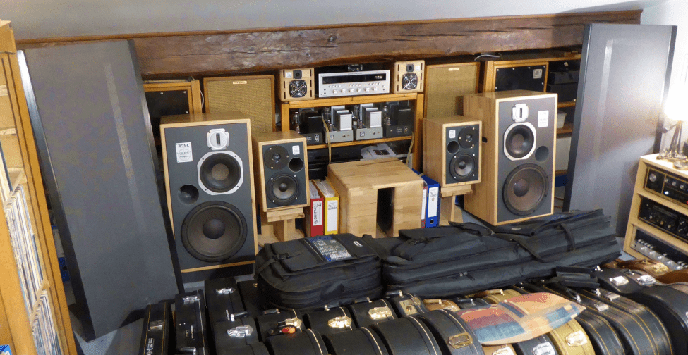

I do use a little 2x12" DIY Ripole (Omega Ripole) with my pair of little SMGb in my not-less-little auditorium. You can see my Omega Ripole placed in-between the SMGb, with the rear side free, as advised by Axel Ridtahler, the inventor of the Ripole principle :
I must tell that the Ripole principle is the best sub system I ever tested until now - notably with my planars - offering :
A test at one of my Audio friend's home - who own a pair of Tympani IV - proved very interesting, demonstrating that the Ripole could again marry satisfactorily with planars, even in very different conditions - in both case, the LPF of the integrated sub module was set at 40 to 60Hz, 12 or 24dB/Oct., depending on the speakers tested (planars, classic enclosures...) :
