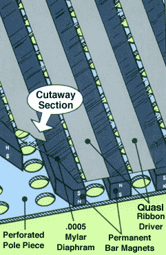

Here it is. It is clear that the film is completely on one side of the magnet. So both sides are not identical. However it is not clear if the second side is also covered with a similar perforated panel as the one shown ? Wouldn't radiation be different from either side ? Is the frequency response different when taken with either side facing forwards ?
No, ashok, the second side is not covered by a similar perforated sheet of metal having 3M rubberized strip magnets - except for:
* the 20; this had magnets both sides of the bass panel only.
* the 20.1; this has magnets both sides of the mid & bass panels.
Hence you can listen with the metal towards you ... or the mylar towards you; various models were made each way. The sound is different front to back; basically, with the metal (and magnets) at the front, the leading edge of a bass transient pushes the voice-coil towards the magnets - ie. into a region of higher magnetic field. This is good ... but you are listening "through the holes in the metal".
With the mylar at the front, you have no diffraction between the voice-coil and your ears ... but you will hear the leading edge of bass transients as not so sharp, as the voice coil is moving away from the magnets and therefore into a lesser magnetic field.
Some people prefer the mylar frontwards, others prefer the metal screen frontwards.

The close up view of the Magnepan MMG appears to have fairly thick wire on the main panel. Is the picture exaggerating the guage or is it really pretty thick ? Must make the panel quite heavy . Am I seeing the right picture.....the conductor being regular wire glued to the film ?

Magnepan "wire" is glued to the mylar sheet. The older models used to all use aluminium "round wire" but some newer models have "flat wire" (ie. thin aluminium foil).
In terms of the round wire models, typically the bass wire was 22g or 23g and the tweeter wires were 31g.
If you took the total weight of, say, 150' of bass wire plus 30' of tweeter wire and then added the weight of the mylar sheet, I think you'd end up with a small number.
