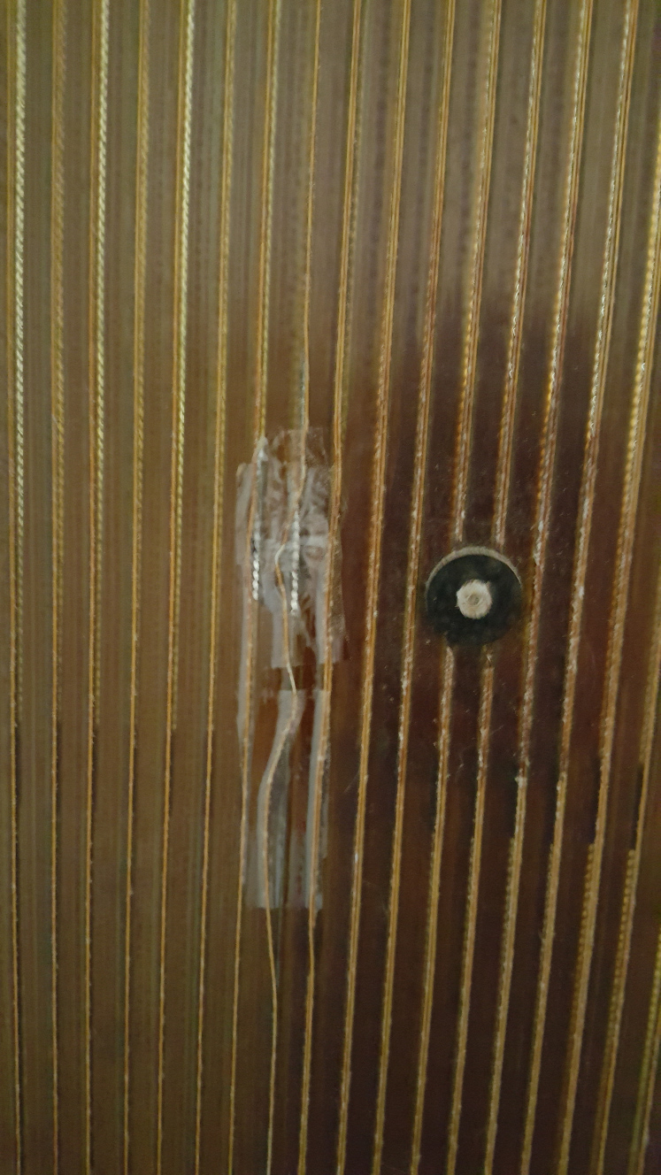

I picked up a pair of Maggies over the weekend for $100 and am preparing myself to endeavor re-wiring these things. I can get the full re-wire kits from Magnepan for about $120 (does both lf and hf, both speakers). At first I was hesitant, but after reading about the work required, getting them for the right price, and a call to Magnepan (who were very helpful!) I decided to give it a shot.
So far only the treble sections have open circuits, but the LF section in the right speaker has a spot that is becoming undone (it was taped over).

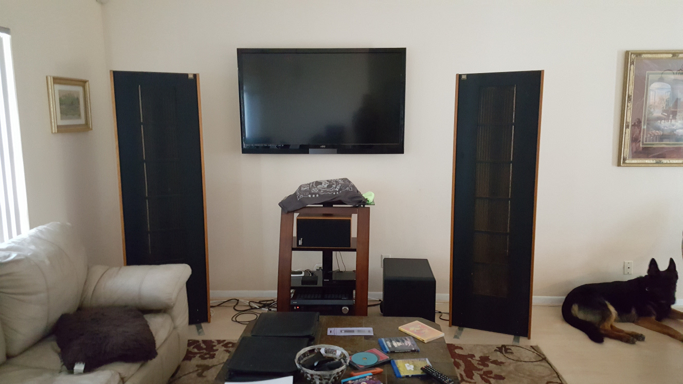

Interestingly enough I plugged them into my system and they sound surprisingly good! However, I am sure that they will sound even better once they are completely rebuilt. I'm also planning on doing some aesthetic improvement as well.
They came with no covers, but as I look at them now, I'm not sure I want covers. They are flat black right now, and I'm not sure of what the challenge would be to paint them without actually making anything worse. IUf anybody has any ideas about painting the aluminum on the front side, I am all ears. In the mean-time I'll at least give Magnepan another call and see what they say.
I kind of like how they look without the covers, and wonder if along with some faint back lighting if they wouldn't look even better!

After talking to Magnepan I decided to rewire the whole thing. MG IIc's are only two way anyway, so I'll be doing the lower and upper frequency sections.
I did read somewhere that the woofer section is easier (perhaps because the wire is much finer for the tweeter section?) But who knows? I guess I'm going to find out! 🙂
The re-wire kits come complete with enough wire to do the pair, solder (for aluminum), sealant, screws, connectors, adhesive, and instructions on how to do it. The instructions are not that detailed, but there is plenty of info around from others doing the same thing. My uderstanding is that patience and care in getting the old wire off without damaging the mylar is the biggest concern.
That being said, I wonder whether making a jig would be worthwile. I suspect that precise positioning is crucial for performance when taking the wire down.

I've done the re-wire for my MGIIa. It is a bit challenging at first, but becomes easy as you go. If you have any mechanical ability at all, you'll not have any problem. The kit comes with all you'll need, including glue.
The old fabric covers are trash. If they're on now, they will be destroyed when you remove them. I like the look with the black covers on, although they're dust magnets (he he) I think Magneplanar has replacements.
So take your time, be careful, be prepared for a messy, but relatively easy job.
