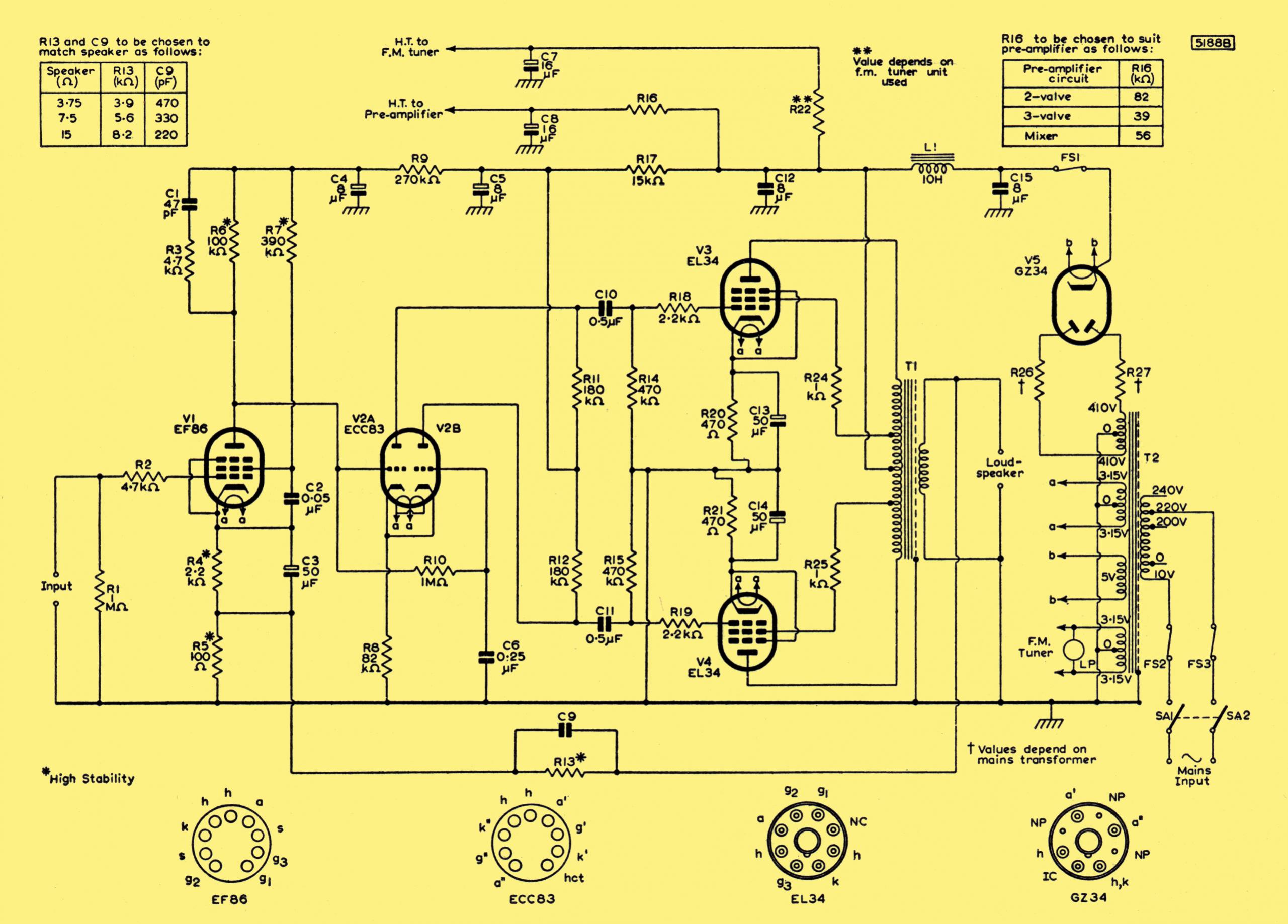

The Hammond 1650Ns mate well with EL34 family tubes. A Mullard style circuit avoids the instability issue associated with Williamson style. An Octal small signal lineup that maximizes gm to protect against slew limiting is a 6AC7GT voltage amplifier and a 6SN7 LTP. Be sure to 10M45S CCS load the LTP tail, which may require a B- supply. Energize the 6AC7 heater with DC, per the data sheet recommendation. You might as well take advantage of the UL taps too.
Use high PIV Schottky diodes in the B+ supply, to eliminate SS diode switching noise.

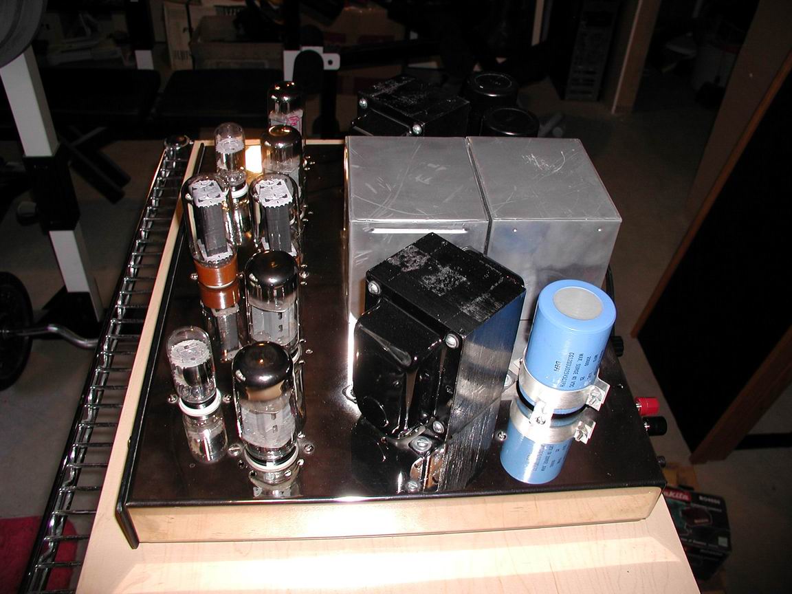

Some very good info for me to noodle on...I also have a little issue...I really do not know i the tranny I have is truley a Hammond 1650N. The overall dimensions and bolt hole measurements were close (if I remember correctly) but primary/secondary wires are same colors as a 1650N, so I assumed it was...a pic is attached. The original designer painted the trannie after removing the ID sticker on top. Any identification factors I can use to determine if really a 1650N or if its really even a Hammond?
