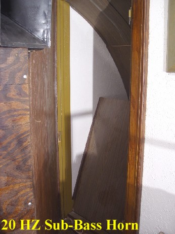

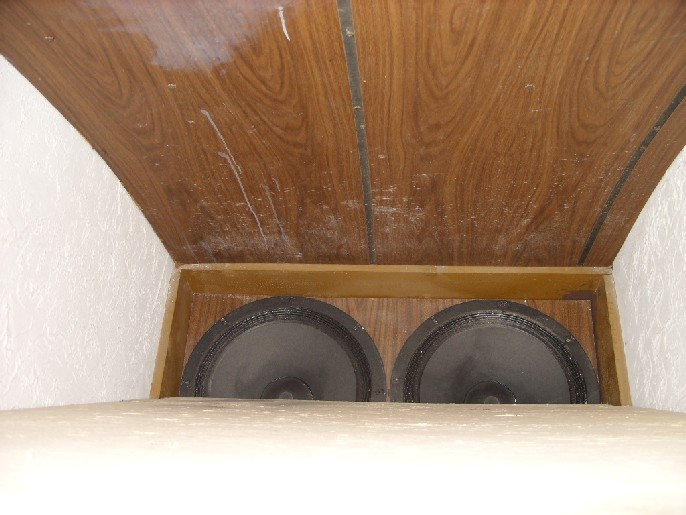

I will be trying this very thing shortly: ESL surround w/ Mag MG-1 bass panels running in infinite baffle (just found a pair of MG-1 with open circuit tweeter wires - made from fragile aluminum wire, these are often found open). But I don't care, just want 'em for the bass.
Current system has inf baffle Altec 416 horn.
