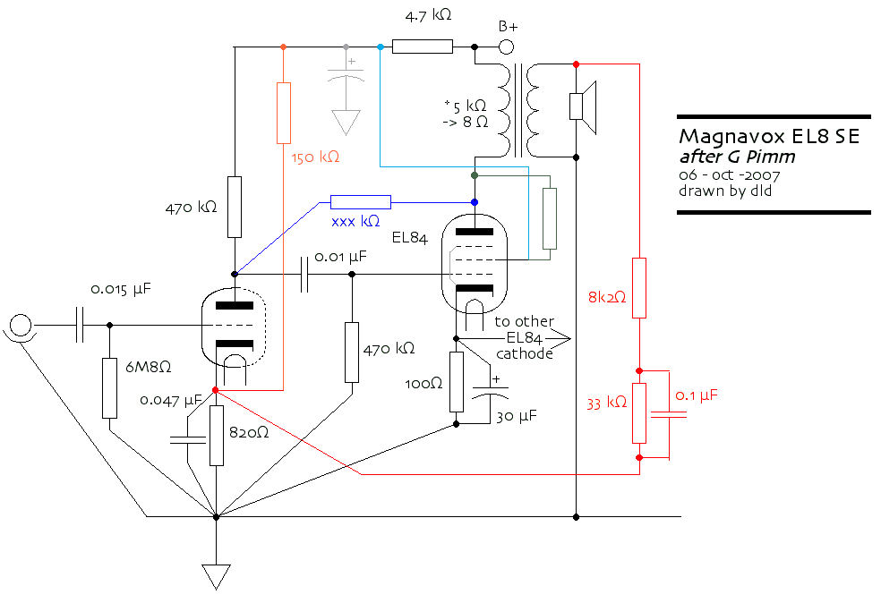

Gary P said:I have a very crude hand drawn schematic of what I found in one of these amps many years ago... One thing to look for is frequency shaping networks in the feedback network. It should be working nicely with the speakers that the amp was developed to run but you may want to remove them if you use the amp to drive different speakers.
Using Gary's schematic as a starting point i have recreated* it and added a few "comments".
In the map shown the red part is the feedback circuit (and maybe the orange 150k -- i'm not sure what it does). A pentode usually needs some feedback, so you could add "RH-style" feedback (blue) or strap in triode (remove the cyan and replace with the green triode strapping R),
I suspect that Gary missed a PS decoupling cap (Gray)
We can use this as a starting point for other suggested circuit changes)

Comments on the schematic...
The global feedback works pretty well on these little amps. For flat frequency response ditch both of the frequency shaping networks. There is a little (crude again) drawing in the lower left corner of the hand drawn schematic showing the frequency response with the networks in place.
The first network is a RC combo of the 33K and .1uf in the global feedback path. This network works as a bass boost/shelving network. It works by reducing the global feedback at lower frequencies. The bass boost starts at ~200Hz and levels off at ~50Hz. To remove the network connect the 8.2K feedback directly to the cathode of the input tube or just short the RC network out with a jumper wire.
The second network is the .047uf cap and the cathode resistor of the input stage. It works by shunting global feedback to ground at the higher frequencies. It boosts the treble starting at ~4K. To remove the treble boost just cut the .047uf cap out of the circuit.
The 150K resistor is a noise canceling scheme. Noise from the driver supply is injected into the feedback node to try and cancel the noise. Works pretty well in this circuit. When I disconnected the 150K resistor the amp had more background hum. Crude Aikido?

SpeakerDude, It would be interesting to know if the frequency shaping networks in the global feedback loop are in your amp and if they are the same of different values. Does the Sams make any notes about these?

About the strange fb network.... It seems to me that while it is connected to b+2, you will notice that thats the power for the screens. Maybe we have some sort of grid feedback here?
Anyways, any sugguestions on how I should go about modifying this? Should I add a pot in the network to change the feedback amount?

Your right about the 150k resistor. I got to thinking about that the other day before I re-read your post. I thought it would make sence to have any background hum be injected in the fb network and canceled. Sly trick there! I wonder what the condition of my multi-cap is then? The amp works fine and has a very low noise floor, and there is no hum/hiss at all, even with my ears up against my 98db speakers!

I got rid of the 33k/.047 frequency shaping network in the feedback also, which helped a little with the low end. However the amp still seems to lack some low end, certain songs it is there, but others it needs a lot of boost to bring it up. Poor OPT's in the bass dept or something else?
