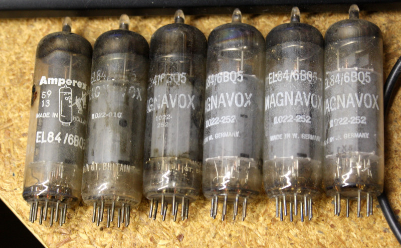

The brand and tube type can be confirmed. I kept the power transformers and the tubes from the amps. I did have a pair of 3.2 ohm 10 inch speakers with 8 ohm horns from an old console in the warehouse, so 3.2 ohms is a definite possibility.
