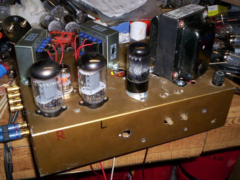

Recently built a cheap singled ended amp with those 6JB5's.
(power and output tranny's combo found on the bay).. 🙂
An interesting thing I discovered in the process is the 6JA5, is mismarked/labeled
in most of the online tube info including TDSL and N7JP, it's actually the same as
the 6JB5, 6JC5, 6HE5 pinout, there a 19w plate and draw a fair amount of current
compared to the 6JB5 ect, on the 6JB5 I'm running a 325v B+ with 25v on 500ohm
cathode resistor in UL, the 6JA5 blows right past that current with a same resistor.
Anywho that 6JB5 is a nice sounding tube, I don't know about the better then 6V6
stated in other threads but a nice tube none the less, driving it with a 6AQ8 there.
Gotta love nice cheap tubes though.
