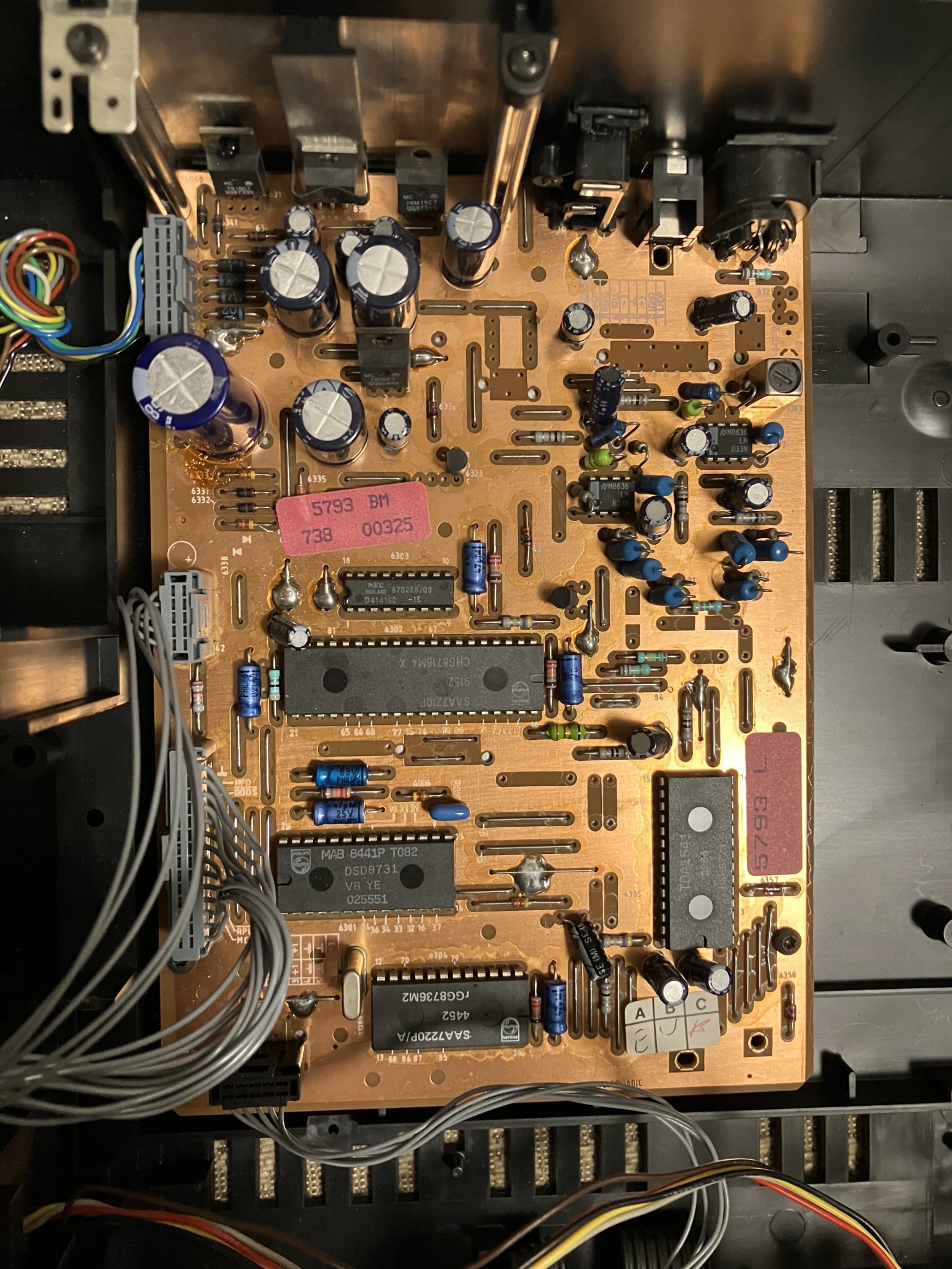

Ok I've opened it up and poked around a bit.

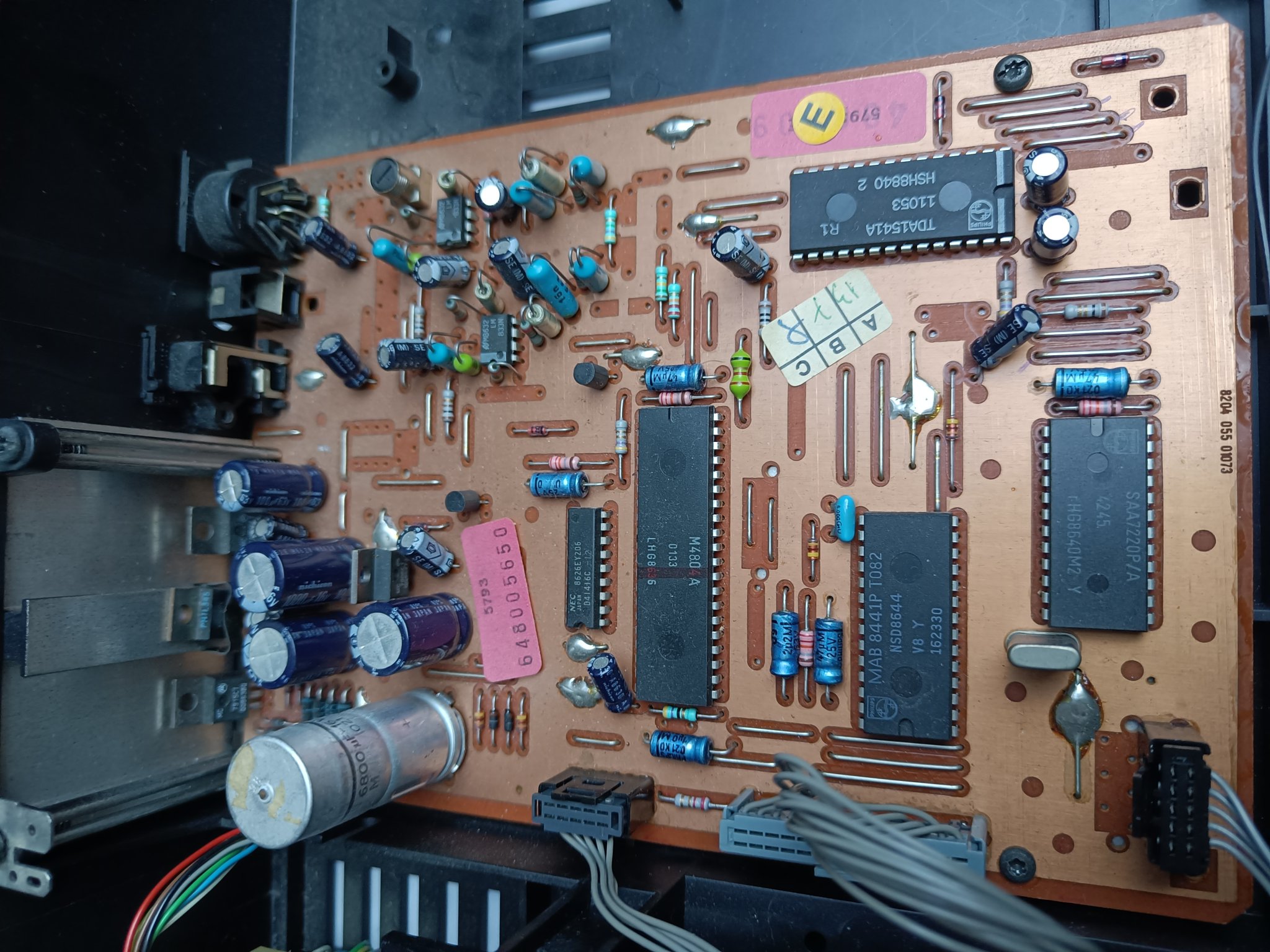

Here's a top view of the main board:
I'm curious about those blobs of solder. I presume those are for attaching leads to important test points?

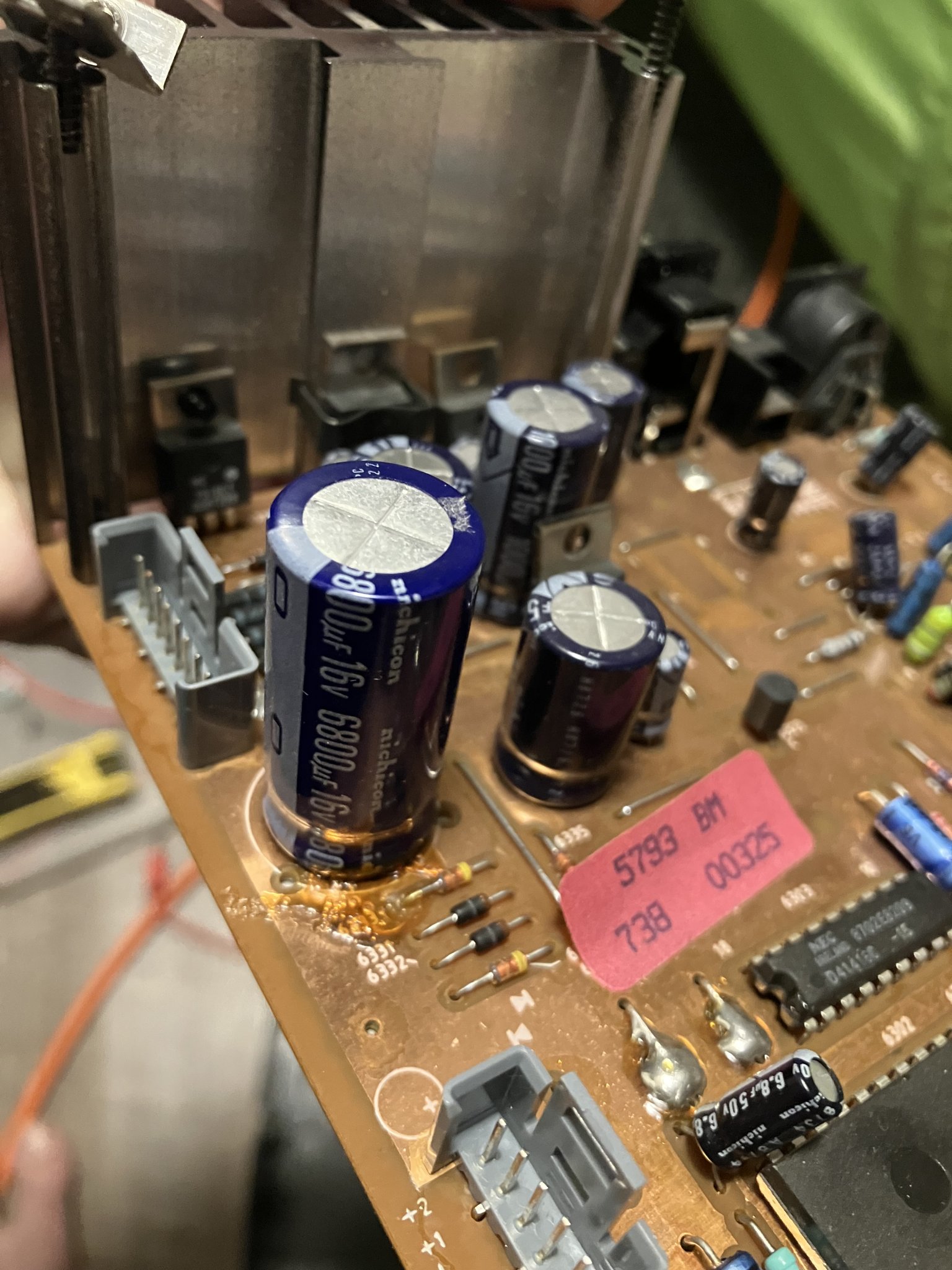

Here's a close-up of the back left corner, what I believe is the output stage.
Are these Nichicons likely the original electrolytics, or has someone already swapped them out for me? I think that's glue under the big one?

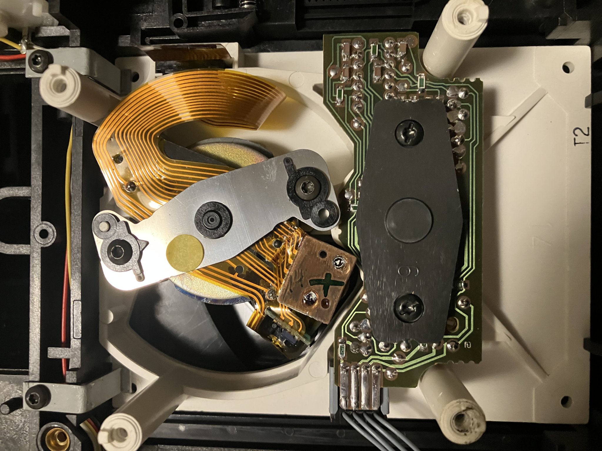

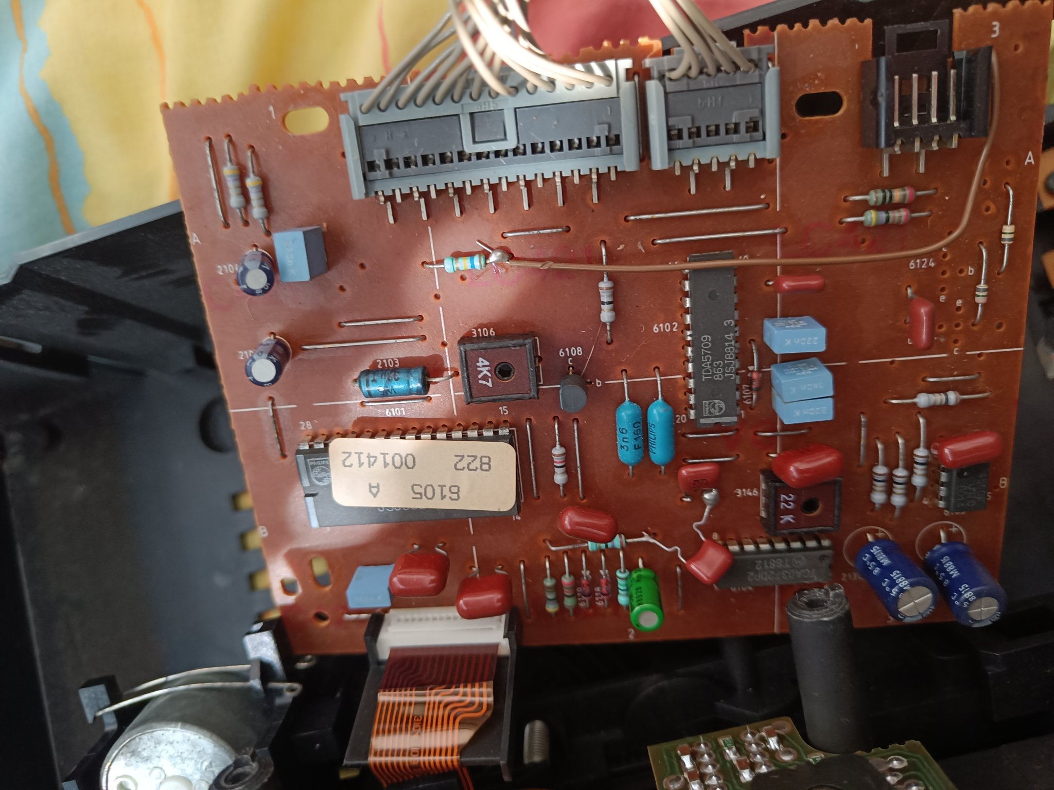

Here's the main board attached to the CDM2/10:

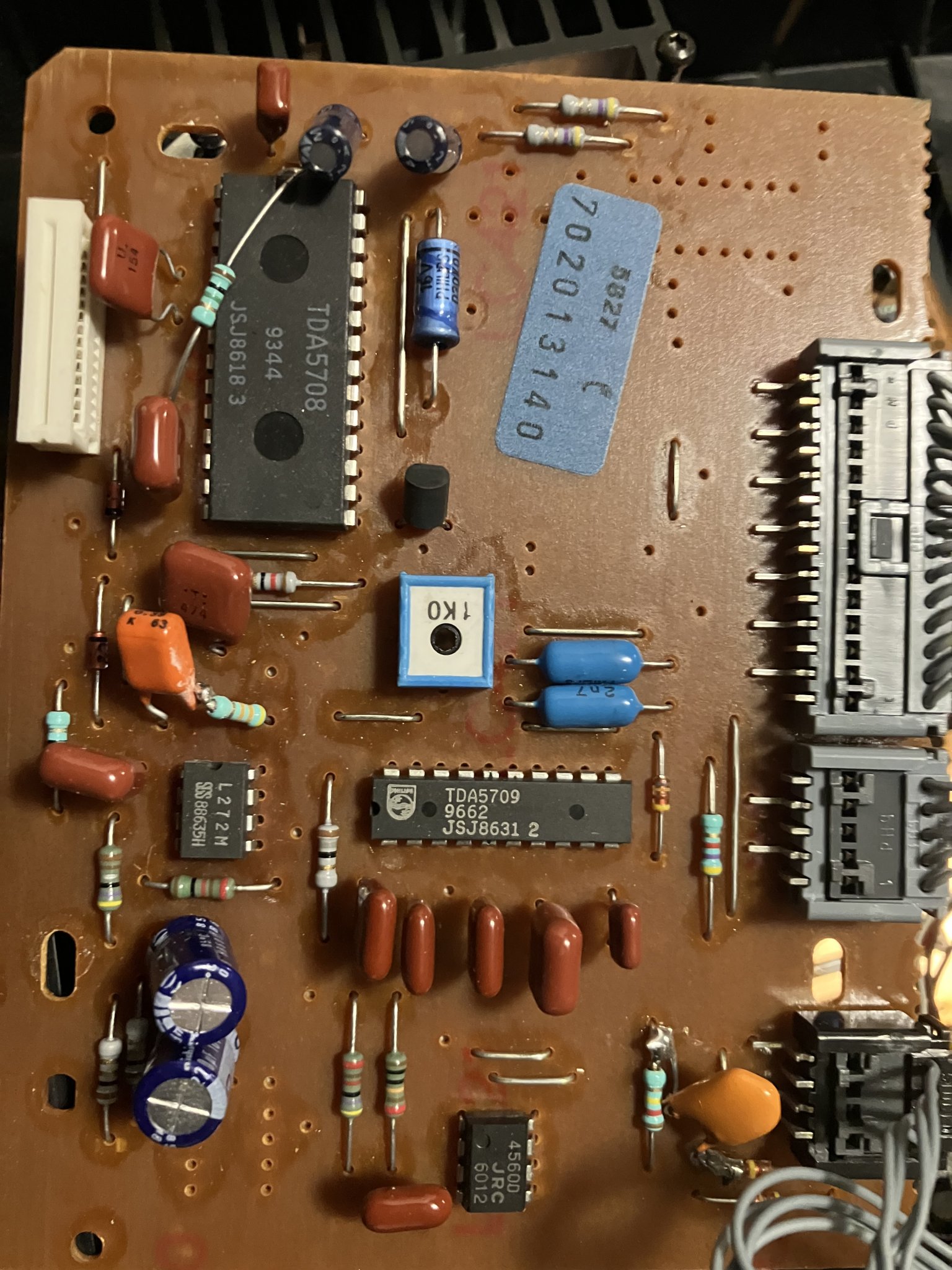

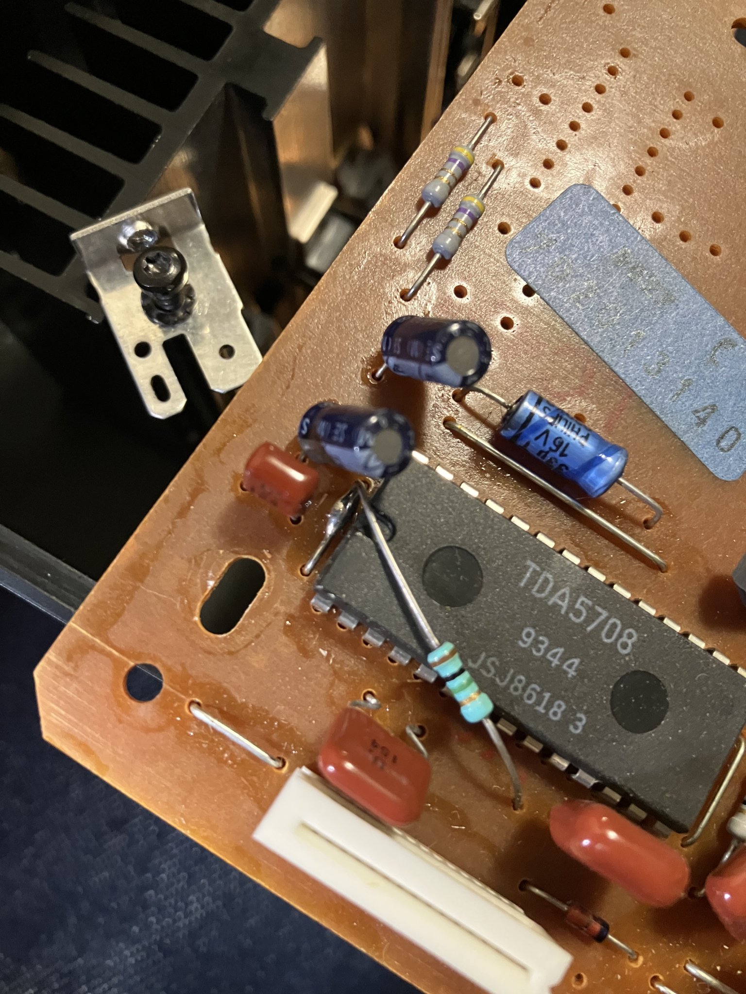

Some odd things here to my eye. That resistor stretched across the top of the TDA5708?

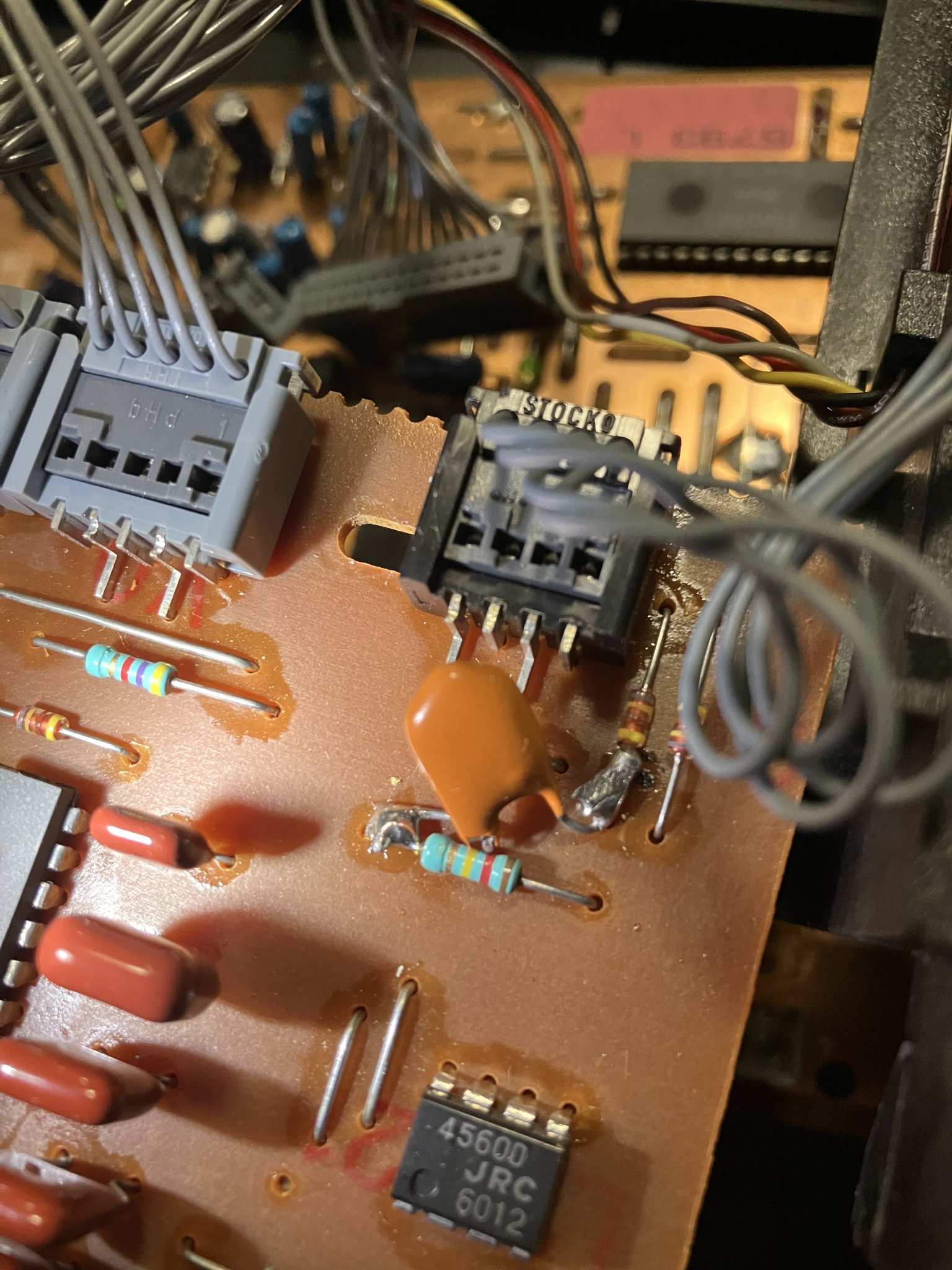

And what looks to be an added capacitor between a resistor and a diode:
Someone's definitely been in here modifying things, yes?
Here's what was under that board:
I found a scan of a service manual, but it's in German. I managed to get it into what appears to be a service mode by holding down the TIME/TRACK button along with the <-- TRACK and TRACK --> buttons while powering it on. I can't get it do anything after that, though. You're supposed to be able to get the arm to move by hitting "SEARCH FORW" and "SEARCH BACK" No matter what buttons I press, the unit seems to stay in the "standby" mode, with "0" on the display.
I think I need to get a real service manual. I also think this service manual, even if it were in English, wouldn't tell me much about how to troubleshoot the CDM2/10. I think there might be a separate service manual for that? If anyone knows where to find it, I'd be grateful.

I made some pictures of one of my Philips CD460's as comparison. As far as I can see the big Cap on your 1st picture is new, but the rest seems to be original. Also the small Cap which seems to be a Mod is original. Some prints were modified during manufacturing in the Philips factory in Leuven in Belgium (I think they were all built there). That was cheaper than renew the prints in those days. As for the service manual, see this link: https://www.hifiengine.com/manual_library/philips/cdm-2.shtml. There are multiple types, so you need to check which one you have, although I think it's the first PCB.

Interesting! Yours appears to have one of the inserted capacitors, but not the other, and it doesn't have the resistor running over the top of the IC like mine does.
