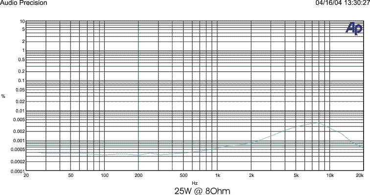

Bruno Putzeys said:
....Lower THD figures (-110dB) are readily realised......
You'll forgive me for taking this with a vast pinch of salt...
....at what frequency is this figure quoted?
...and of even greater importance, what was the measurement bandwidth?
.....If the measurement bandwidth was the typical 80KHz used for linear amps., and we assume you mean -110db at 1KHz, then this class-d amp. outperforms the majority of linear class-ab designs...
Even assuming that residual carrier signal at the class-d amp's output did not cause the input stages of of the distortion analyzer to slew limit, this figure is unlikely in the extreme....
Mikeks,
Hereby a measurement of a UcD Class-D amplifier with an extra integrator loop. Measurement bandwith was 22kHz.
This is not implemented in a product, but a test to take a look how low we can get the THD......
Jan-Peter
This figure was quoted at 1kHz. Measurement BW is 22kHz, but you will recognise that going to 80kHz would make noise dominate the measurement, but not add any further harmonics to the measurement. In fact, for this reason, the 110dB pertained to THD, not THD+N.
Concerning slew-rate limiting on distortion analyser inputs, you will understand that this would require a very large residual.
The AP analyser will analyse at least up to 200kHz full-scale audio signals, The carrier is at 400kHz. It should not elicit any slew rate problems as long as it is better than 6dB suppressed. It is suppressed by better than 40dB.
AP's do potentially have a problem with the presence of a carrier, in that the autoranging circuits base their decisions on the full-bandwidth signal. At low amplitudes the carrier will force an unnecessarily high gain setting, adversely affecting the device's resolution at low signal levels. The AES17 pre-filter used to measure D/A converters (most of which have large outband noise levels causing similar problems) remedies this.
On the AP2 this problem is not overly dramatic. JP's plot was made without the use of an AES17 filter.
