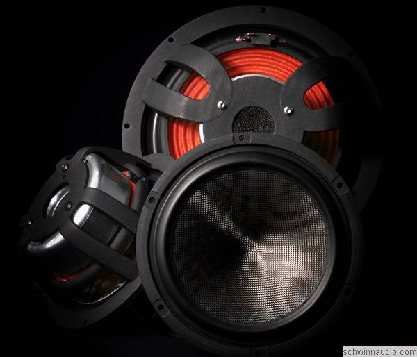

Erik- you've said Seas drivers for mids before, but Morel makes them.
Here's proof the Magico mids are Morels, pictures from internet....
The tweeters are Scan Speak Berylliums.
midbasses are also Morel on some models:
Later,
Wolf
Later,
Wolf
