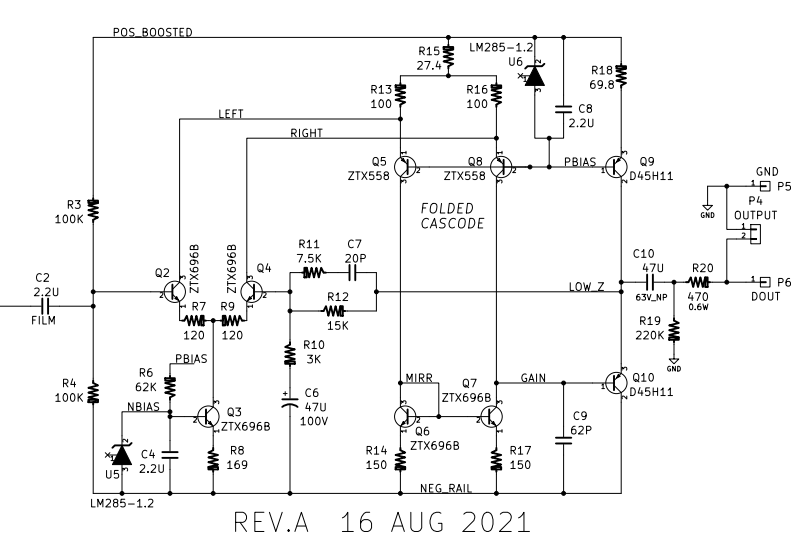

Common base mc pre has been used for decades.
I believe this line level pre is common-base based too.

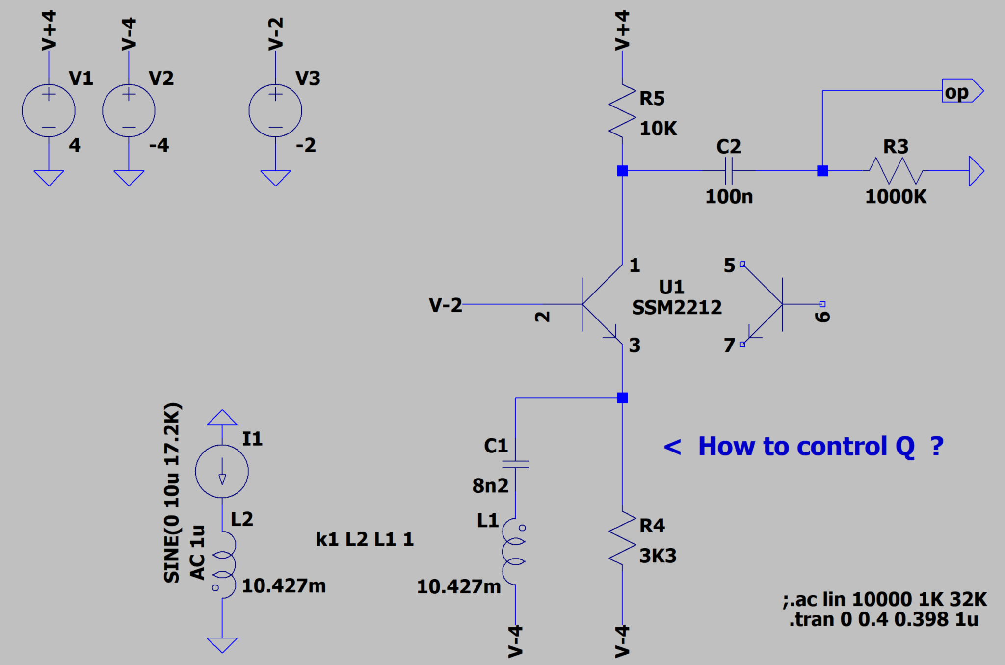

Yes it has but has its bias been understood so that it is used to advantage? The only place where I see its advantages exploited well is the circa 1960's circuit showing the front end of an Eddystone EC10 Communications Receiver (see above). The LTspice simulations given early on in this thread show that bias is critical and there is a "tipping point" the good properties of Common Base reach a maximum and then turn bad, the Eddystone EC10 circuit knows this because an operator can adjust the bias because he is turning an AGC (or RF gain) pot.
As regards your line level preamp example I agree that it is common base for the first and second transistor but is it? My understanding of Common Base is that the Base is connected to signal ground or shorted to signal ground for AC by a good size capacitor.

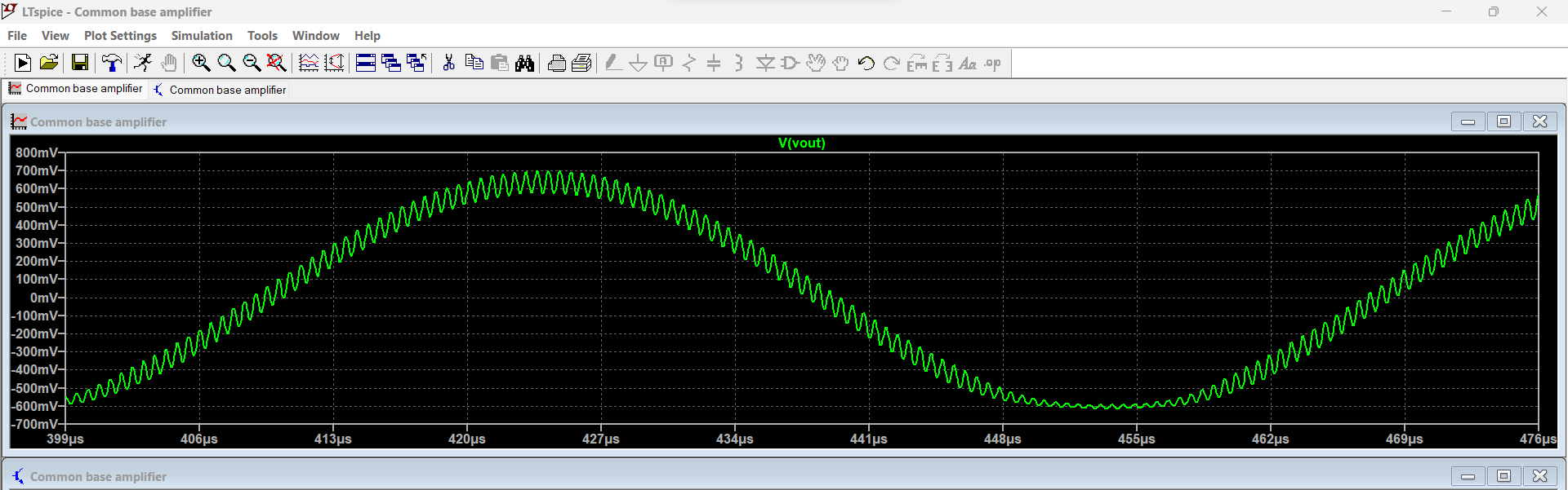

I ran a simulation for a Cascade and copy the LTspice circuit below:

In applications like the Eddystone receiver, the base voltage is varied to change the emitter resistance, and hence the signal current into the emitter. That is a cheap and nasty thing to do, but 60 years ago it was the best solution possible in RF design. That isn’t a typical use of a common base design as linearity changes significantly with bias (and in the case of the circuit originally posted, Q).
I just don't like the word Cascode, I know the explanation of how the term came to be but I don't buy it, terrible, and I don't want to carry the plethora of labels that electronic circuitry has collected over the years for often trivial reasons when in real circuits every case is usually different.
Yes changing the base voltage changes the bias of the Grounded Base and interestingly Grounded Base bias is critical, gain goes up reaches a peak and then drops off very fast. I noted it because I have seen how this works (without fully understanding) and have simulated it to find resistors for peak gain. I will repeat the circuit and my comments about it below. Try to see my point of view as to me the Grounded Base has very unusual surprising qualities that I have puzzled over for hours.

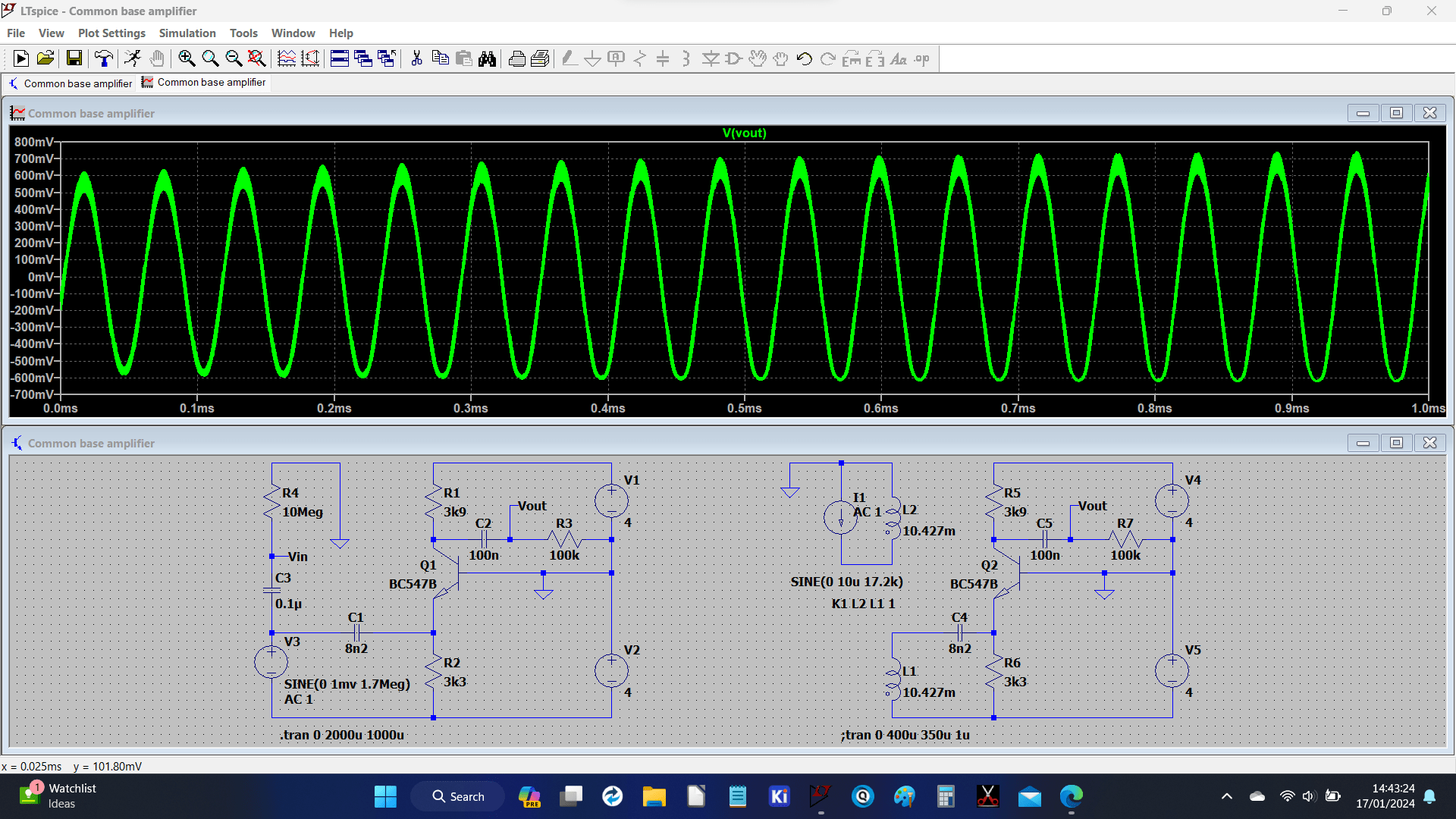

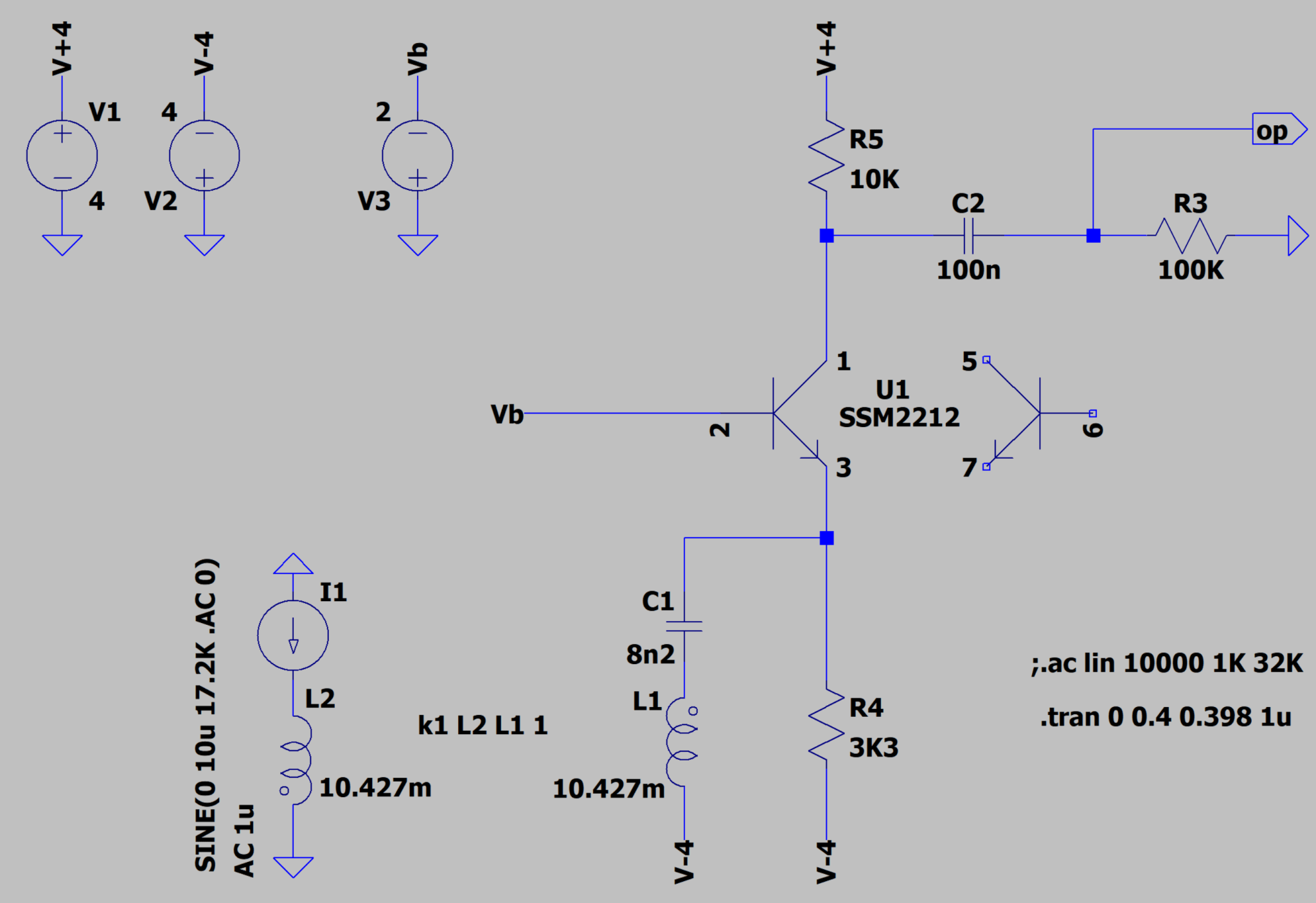

Please have a look at this circuit:
The idea is to get a sharp resonance (high Q) in the 10.427mH 8n2 tuned circuit. Simulating this while stepping the value of R1 shows that as R1 increases towards about 3K9 the resonance gets sharper and sharper. As soon as R1 exceeds 3K9 resonance is soon lost and performance quickly degrades. I can't see why but that's what happens. I see the Eddystone EC10 circuit using this "quality" to good advantage - giving the operator a pot to turn (RF Gain) that can be adjusted to a peak. By the way the EC10 was a very early design and used Germanium RF transistors such as Mullard AF116 so I think the designer was a very cunning skilled engineer. That said the Eddystone EC10 was a budget design what they today call an entry level communications receiver.

I understand your dislike for the word, but in a technical environment using the right word in the right context is important if you want to be understood, but as we are discussing a common-base circuit it is probably a distraction.
For the circuit you present, if I interpret the naming correctly then you have biased the transistor for about 1mA collector current. That means that, with a 3k9 collector load Vcb is 0. Without looking at the data sheet for the transistor I would expect the gain to drop and the transistor to start to enter saturation. The extreme of this with increasing load resistance is that the transistor degenerates to a diode to ground.

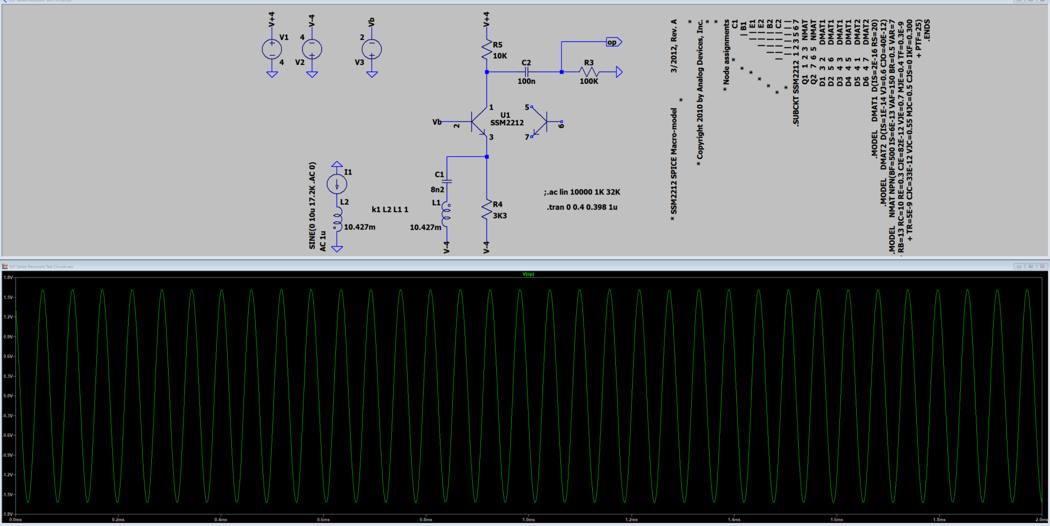

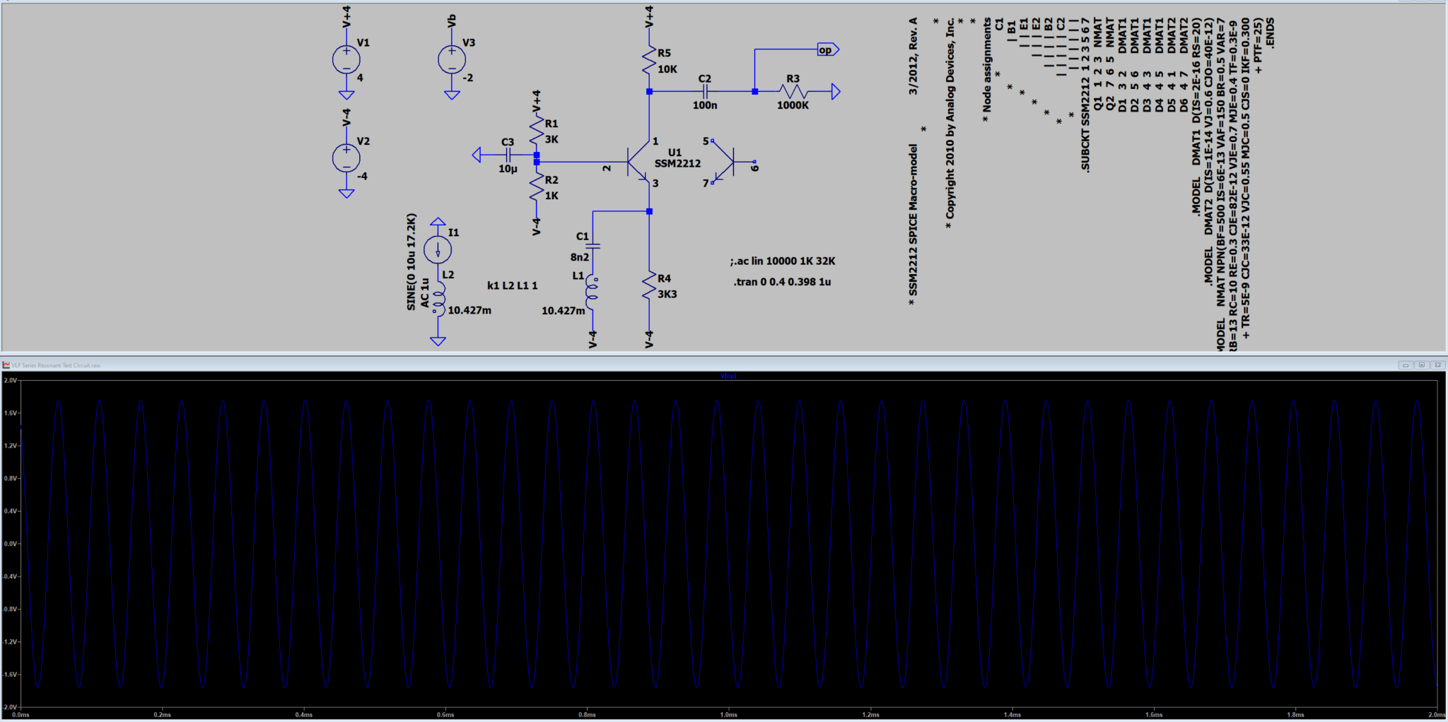

Having looked at the datashhet for the SSM2212, figure 13 might explain what you are seeing. The collector capacitance changes massively for small Vcb and forms a low-pass filter with R1. To check this, replace the antenna with an ac current source, and sweep the frequency for a range of R1 values.
Yes I will try that, I need to look for the simulations, from memory I think its to do with the bias voltages being such that its not possible for the Vbe voltage to reach the 0.65 Volts approx to start turning the transistor on - so it never gets turned on when R1 is much higher than 3K9.
The SSM2212 is a very well behaved transistor pair I use it because it has a very good LTspice model whereas a lot of common transistors don't have models or have third party models.

The resonance is intended to be around 17.2 kHz so quite low but even a small varying capacitance is likely to shift the resonant frequency.The collector capacitance changes massively for small Vcb and forms a low-pass filter with R1. To check this, replace the antenna with an ac current source, and sweep the frequency for a range of R1 values.
