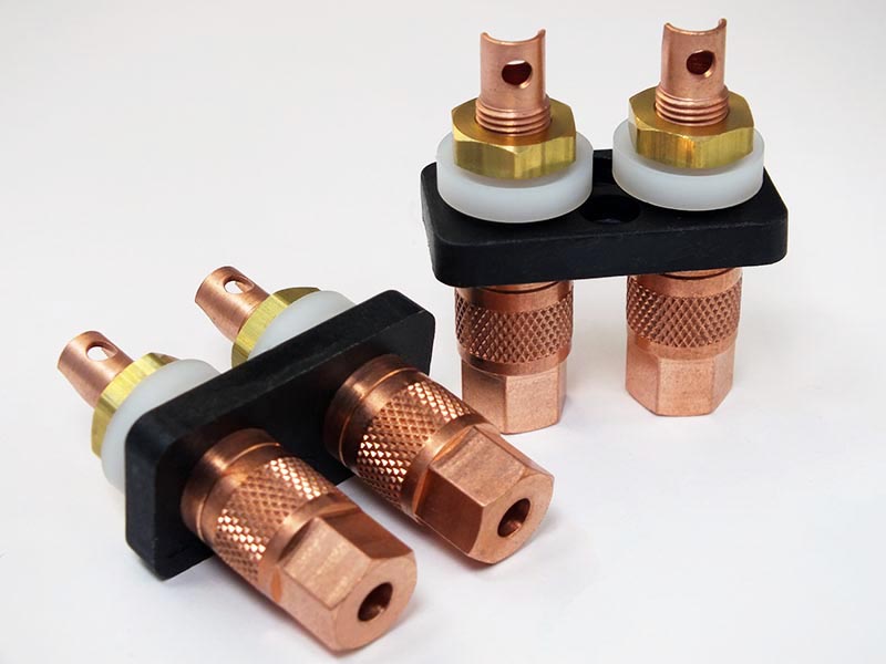

Cardas Connector CCBP-S Binding Post Unplated Copper, from Parts Connexion. These .are. so awesome, silly as it may sound, just holding them in you hand... they are substantial and beautifully finished. They are 'standard issue' on my Atma-Sphere amps. One pair (my M60s) are 20 years old, these look exactly the same way as the day I bought them.
If you decide on using these I have some tips on installing and (safely) soldering the internal wiring to them. They will absorb a lot of heat from the soldering iron, possibly melting certain parts [common to many aftermarket options]

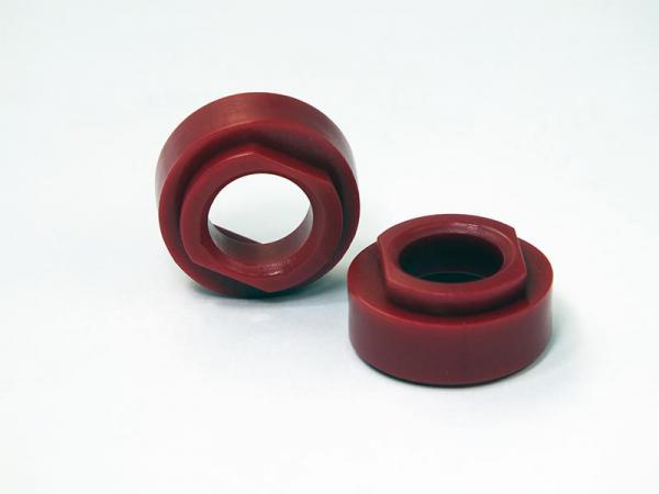

I think the biggest challenge(s) on replacing (any) 5-way BP, is enlarging the holes in the chassis and maintaining the 3/4" spacing to "conform" to the black block holder (as shown, in this case) I use a rat tail file, rather than a drill or rasp... as it is easy for the center spacing to "wander" or become problematic.
Cardas makes / sells these Spacer(s) if the black block won't fit or if the binding post center is greater than 3/4"
