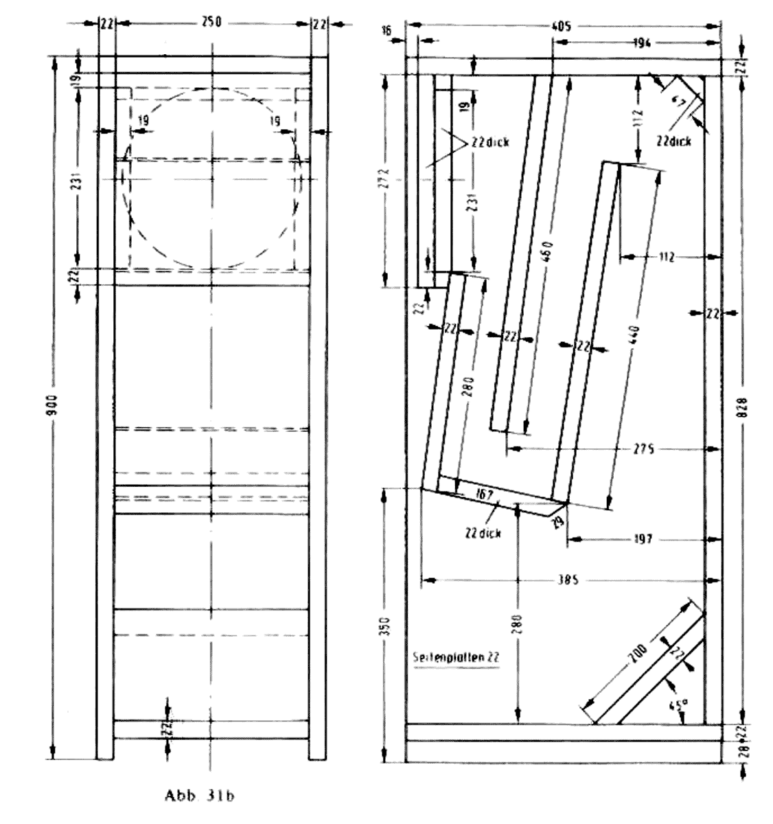

Does anybody have the measurements of the Fostex BK20 enclosures? I do have the plans, but they are made for building the kit, so they do not contain the length of each component, angles, etc.
Thank you!

Thank you very much Dave!
Now, please let me know, does anybody have listening experience with this system - FE208EZ + BK-20/201? I mean I saw that some folks are saying that Fostex designs are not the most appropriate. However I find this project simple enough and this would fit my philosophy of life - things are simpler than we think.

This is a 3rd party design, i 1st found it on euro-sites in the late 90s, so i always assummed it was designed there.

Marius - count me among the folks who've commented on variable results with "Fostex factory" designs - I've heard / built several over the years and some of the larger Nagaoka manifold / BLH for FE206, etc are quite fine indeed, if not simple and lightweight. I recall helping a buddy with a pair for FE206ESRs which required something like 6 sheets of 5x5 plywood, and lots of patience on his part with the assembly
OK, thanks again. I managed to find a kind friend who made for me a .dwg file with the measurements. This is my very first horn project. So, you can imagine I have great expectations. My amp is a 2A3 SE DIY

I've built some Nagaoka Tetsuo designs and built two of the BK-16 kits for those that couldn't themselves. I loved the BK-16 design, despite being an ancient, washed up, non-computer designed horn.😀 Actually, I preferred it over a couple of the computer designed BLH's I've built in terms of overall musicality.
I love to build & listen to different designs, but don't know anything about computer designing horns. Question for the pros, how does the software account for the varying output impedances & dampening factors of various amplifiers? Does this not change the design as the driver reacts differently and thus driver specifications change? Does this not shoot some holes in the precision of computer modeling?
The sims assume that the amp can provide the current needed at the fixed voltage setting. So a constant voltage is assumed which is pretty good for most modern solid state class AB, class A, or class D amps. However, for wildly varying impedances that are too high, a tube amplifier designed for high impedance output may be better. In my experience though, te akabak sims of a BLH are very good.
It is not beyond the wit of man to account for amplifier output impedance & its effects on the behaviour of a drive unit in the design of an enclosure, be it a horn or anything else. The ideal is to design for a specific amplifier, room acoustic & position et al. If not, then you ensure there is sufficient flexibility in the innate alignment selected to work with a range of amplifiers, room types and positions. Job jibbed. You can't please everyone, but you can provide a very effective compromise.
As for 'non-computer designed', probably the best performing bass horn designs in a technical sense were done by RCA, WE etc. back in the 1920s - 1940s when there wasn't a whole lot of digital technology available. 😉 Software allows easier / quicker design and can reduce (though certainly not eradicate) a lot of the physical prototyping & testing requirements. That is where the real advantage lies: speed & cost. You can hit broad alignments quickly; refinements can then be made via fine-tuning in the prototype stage & to an extent via additional simulation work.
