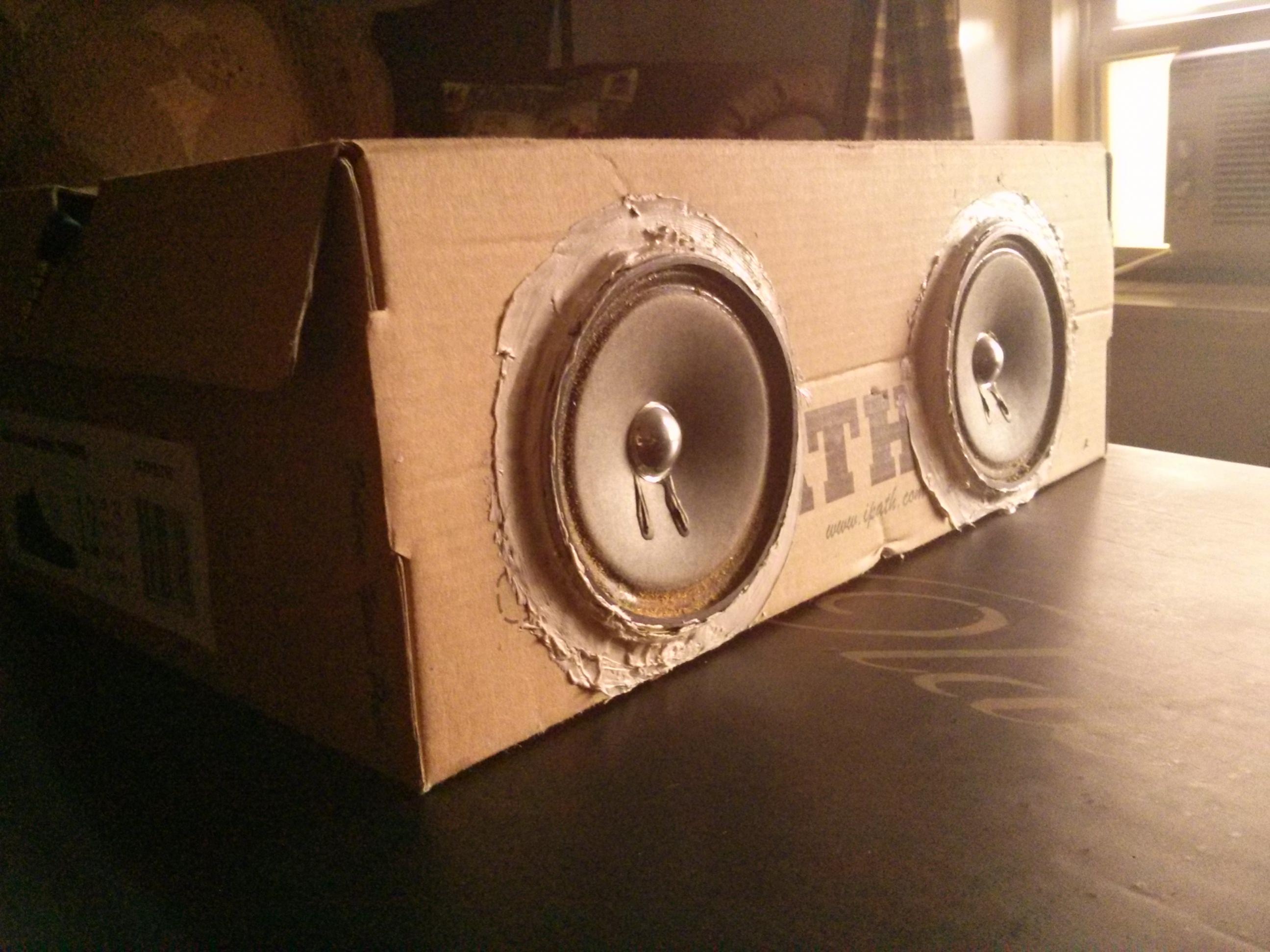

I decided to try and make a 2 speaker stereo, and fit them in my shoebox,..eventually got everything wired to a 3.5mm headphone jack to use with my phone..powered on and works,..but low volume for my taste

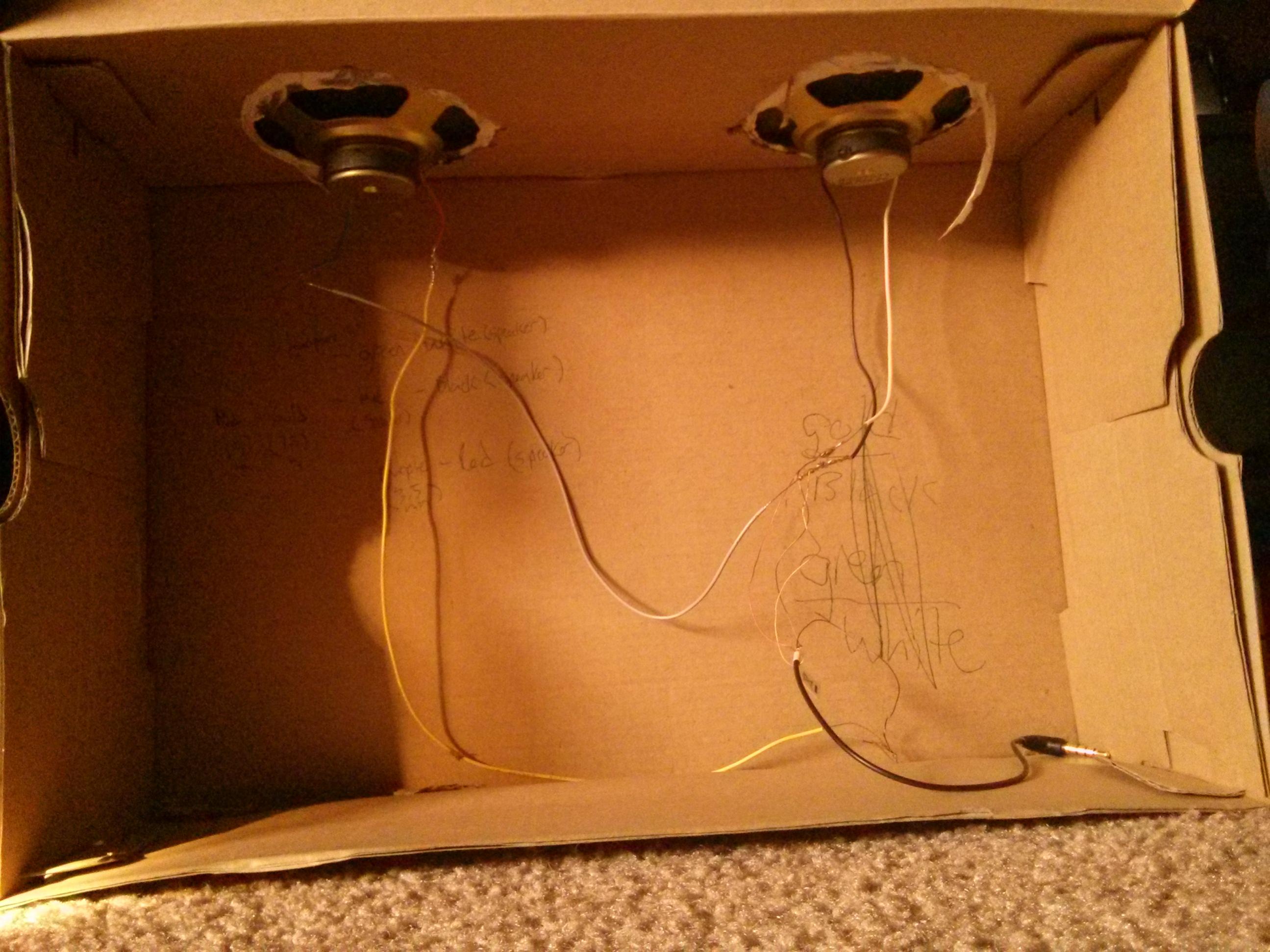

The way i wired the speakers was negative to negative from each speaker, with 2 wires from the headphone jack connected to those wires, and each positive of each speaker connected to 2 wires on the headphone jack,..so if i decide to cut off the jack ive got left(-)(+) right(-)(+) to solder onto an amplifier(Did i wire my speakers series parralel,?) (4 wires total on headphone jack)

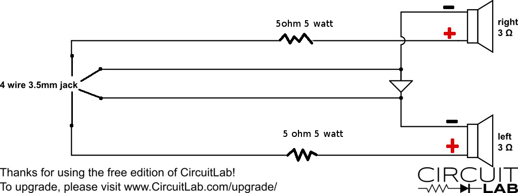

Find a 5 ohm 5watt resistor and place in series with each of the + speaker leads and try a pair of LM386 amps.

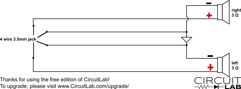

heres my speaker setup in a circuit

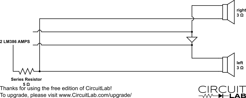

Mount the resistor like this? and how would i wire both LM386's?
Id put the drivers in seriers and drive them with any amp...
6 ohms... In series they would be 1,5R that would be a bit too low, therefore
Id get tda2003/2040, and smack the speakers with 10W!
Theres no need for any freakin resistor!
The way Id wire this thing it would look like this:
print screen
Then wire it to ur 386, solder both signal wires together and you get mono signal.
2 gnds too..
If you want stereo... Then theres no need anyway. You need 2 speakers but they should be alot further away from eachother.

I agree with Mik,
there is no point in trying to get stereo from one box.
There is no point in using lower impedance, by paralleling, than necessary.
I've tried mono setup and they crackled for some reason, I went back to stereo and they sound clearer and no crackle,...

I see since i would wire them in series i equal the 6 ohms of the speakers and decrease watts needed, to get 6 ohms for both..then i can push 4+ watts without getting hot..., if i want stereo through the amp i would wire them in parallel which would defeat/burn the amp? so then i would wire each speaker into 1 lm386 each and tie both amps into 1 switch,1 potentialmeter?
