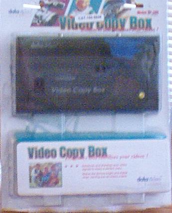

What you're experiencing mrfeedback is ILLEGAL. If macrovision interferes with the viewing of a movie it is ILLEGAL and perfectly legal to disable it. If they don't disable it then they are being either ignorant or pricks and may possibly be breaking the law. What I did (was for illegal purposes but, oh well) was I bought a Video Copy Box made to backup your own copies of movies. As you are also from Perth I will give you the info on where I got it (international readers: i have info for you in my Macrovision Problems topic). A few years back I baught it at Tandy Electronics Bullcreek for $150AUD (still new technology). The brand is data video and the model is VP-260. I have included a pic of it in box (sorry bout the pic quality).
