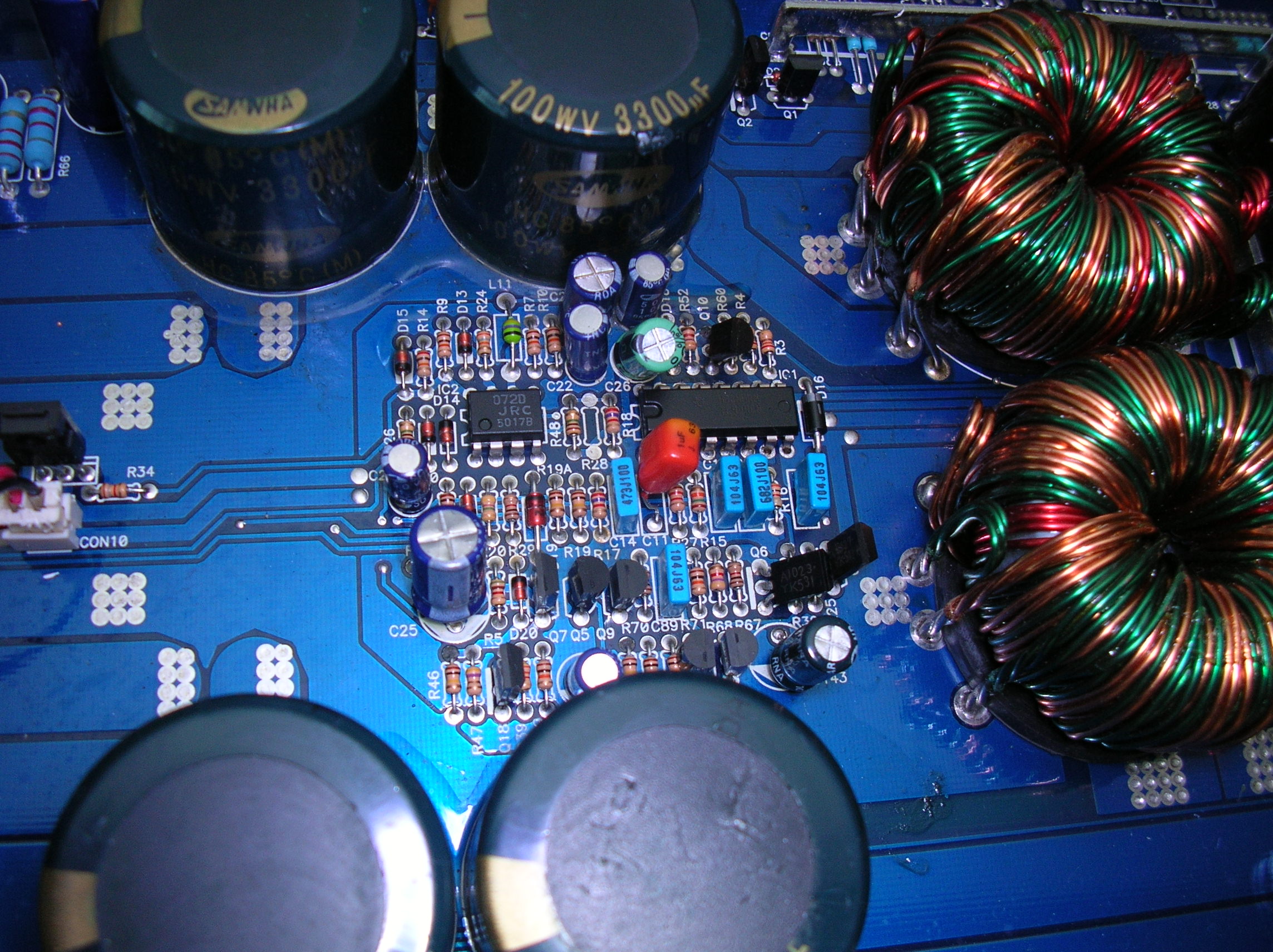

Hi, again,
Well, waiting for parts for my last repair, I'll start with this one, it has reached me yesterday.
When connected, no sound, no voltage at the speaker output, the relay is not active, and no rail voltage ... only protection led on.
I have reviewed the most common pieces, finding results, mosfet output, all right, power mosfet too, well ...
I have also reviewed some tensions, which have seemed to me little ... I do not know ....
Any idea?

Check all of the 470 ohm resistors (generally marked 4700) on the driver board. Also check all of the small SMD transistors near those 470 ohm resistors. Check for leakage as well as checking for open junctions.
On all of the components near the ends of the driver boards, check for bad solder connections.
Well, first, thanks for your reply, Perry.

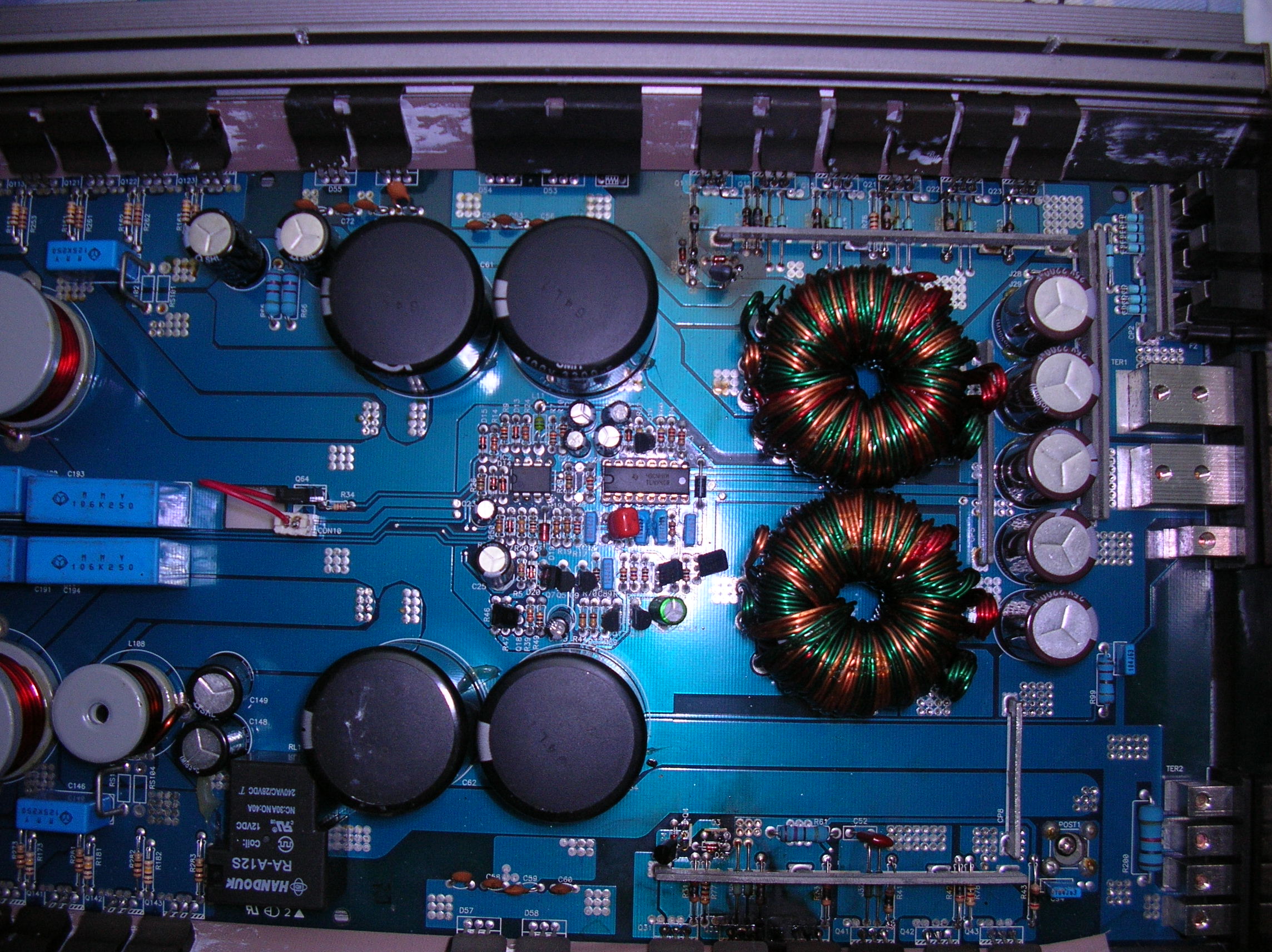

I have checked all the resistances that you have told me, and well, also all drivers and smaller transistors smd, I removed the motherboard, I've seen from behind, and I watched closely all welds without finding fault, I have only seen in the protection circuit an electrolytic capacitor, a little swollen, (see picture one) but nothing more ...
A couple of hours, the same guy who brought me this amp, I've brought another well, for pieces done, because it is in worse condition, (see photo two), I say this, as it helps for something, Perry .

Well, I made the change, card drivers, of the amplifier 2 to the amplifier 1, but no luck, still the same, there has been no change, nothing works, nothing is heated, only led, lit red protection, and ... nothing more ....
Weird?? ...

Perry, I thought, that before changing the 29 components of the amplifier 1 to the amplifier 2, (not because they want to, forgive me, I do not want you to bother ) I checked the voltages at the IC, TL494C and TL072, and are as follows:
TL494
pin 1: 0,015
pin 2: 4,91
Pin 3: 4,78
pin 4: 3,34
pin 5: 1,4
pin 6: 3,4
pin 7: 0
Pin 8: 12,47
pin 9: 0
pin 10: 0
pin 11: 12,47
pin 12: 11,66
pin 13: 5,0
pin 14: 5,0
pin 15: 5,0
Pin 16: 8,55
TL072
pin 1: 1,30
pin 2: 5,01
Pin 3: 1,06
pin 4: 0
pin 5: 6,25
pin 6 1,9
pin 7: 9,29
Pin 8: 11,68
What do you think you of these measures?
If these values ​​are correct, I will begin to change the components of an amplifier, the other.
Something is driving pin 7 of the TL072 high. It's likely the voltage on pin 5. You could try grounding that pin (to pin 4 of the same IC) to force the amp on. If the amp comes on, the protection circuit would be defeated so you'd have to have all transistors clamped down and a limiter or small fuse in the B+ line to protect the components clamped to the heatsink.
