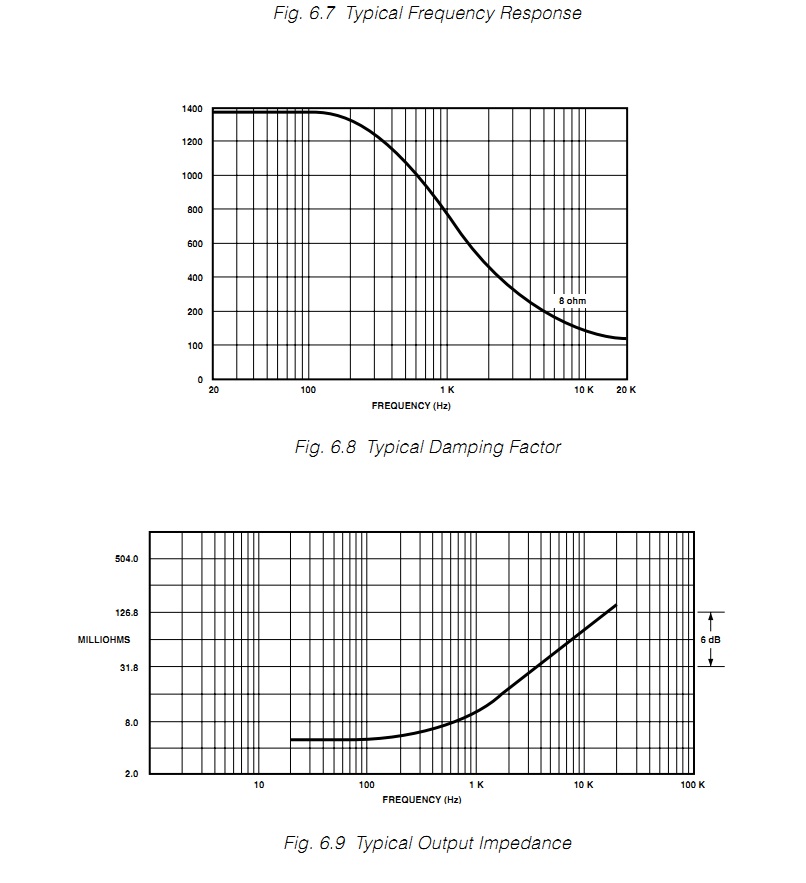

The correct method is not based on % power loss, it's based on DF.
A 25% loss is about 1dB or so.
It's a good idea to maintain a minimum DF=20 for the length of wire and your driver impedance.
12ga wire is 1.58Ω/1000ft
DF=20 for 2Ω load=0.1Ω which is 31.6ft of 12ga.
correction
ALT!! i realised that i told i ******** telling that my cable has and impedance of 2 Ohm. Now i explain better.
the resistance of a cylindrical conductor is equal to R=p*L/A
-p is the electrical resistivity in ohm*m;
-L is the lenght of the cable in m;
-A area cable in m^2.
with p=1.68*10^-8 , L=4 and A=5*10^-6 (because i use a cable with 5 mm^2) it results R=0.01344 Ohm.
Now the DF seen by the subs is DF=8/(Zout+R)=8/(0.008+0.01344)=373 .....So in the end the subs doesn't see a DF of 1000 but about 1/3 of this value.
The choise of the cable is really very important not for the real power lost but for the real DF seen by the subs.
I will check my result by testing my cable with a TESTER and i will tell you if my count were right.
